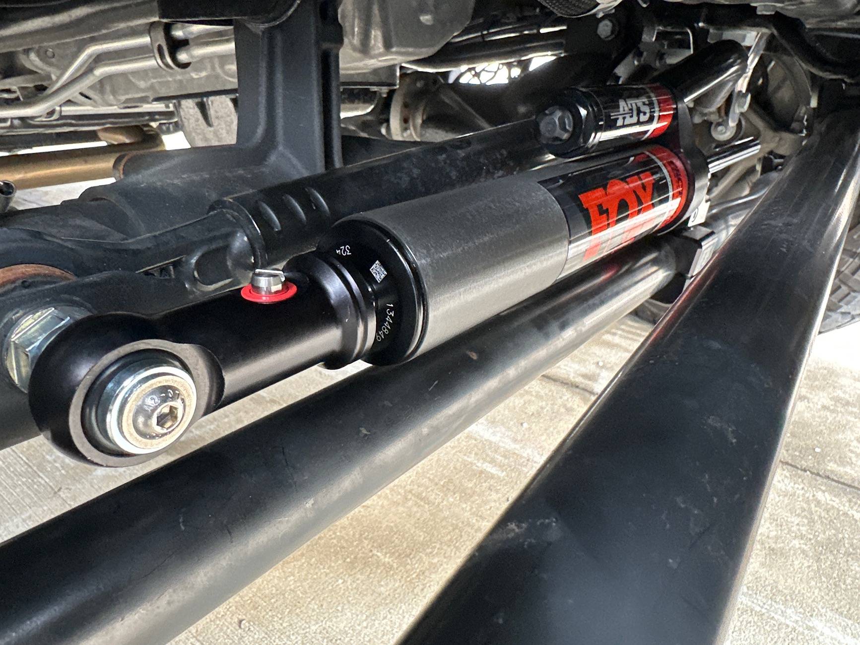

Just installed. Wasn’t too bad of an install actually. Passenger full lock definitely has some good room even though I pushed down the shock body to that 1/4” gap that is stated in the instructions.
How is everyone’s piggyback looking? It seems that if I move the piggyback any other way, it will hit the other components. Seems like this upright position is best, at least for how stock my Rubicon is.
I recommend occasionally hitting that adjuster screw with a little spray of WD-40. Mine has frozen up. Can´t help but think a little of that every oil change might have prevented it.
That said, its a fantastic steering damper!
You think PB Blaster would do just fine? Man, I wonder if there was any sort of cover for that screw so that way it wouldn’t seize up.
Driving impressions so far, the feedback is almost immediate compared to the OEM stabilizer. The steering feels much more firm even with the factory setting adjustment. I may turn it a click or two upwards and see how it goes.
PB Blaster will get an opportunity to free mine up, but I think WD40 would be better for preventing the freeze up in the first place by displacing water. But PB might do that just fine, too.
