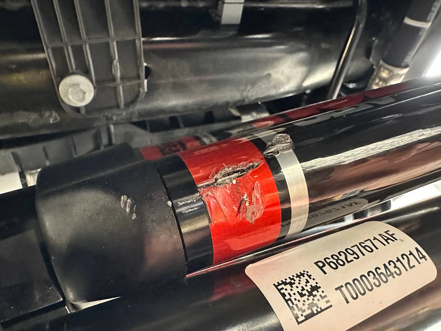

Damn it, I didn’t realize that I wasn’t getting enough clearance lately and so the remote reservoir has been hitting the top.
How are you guys turning it on a stock Rubicon?

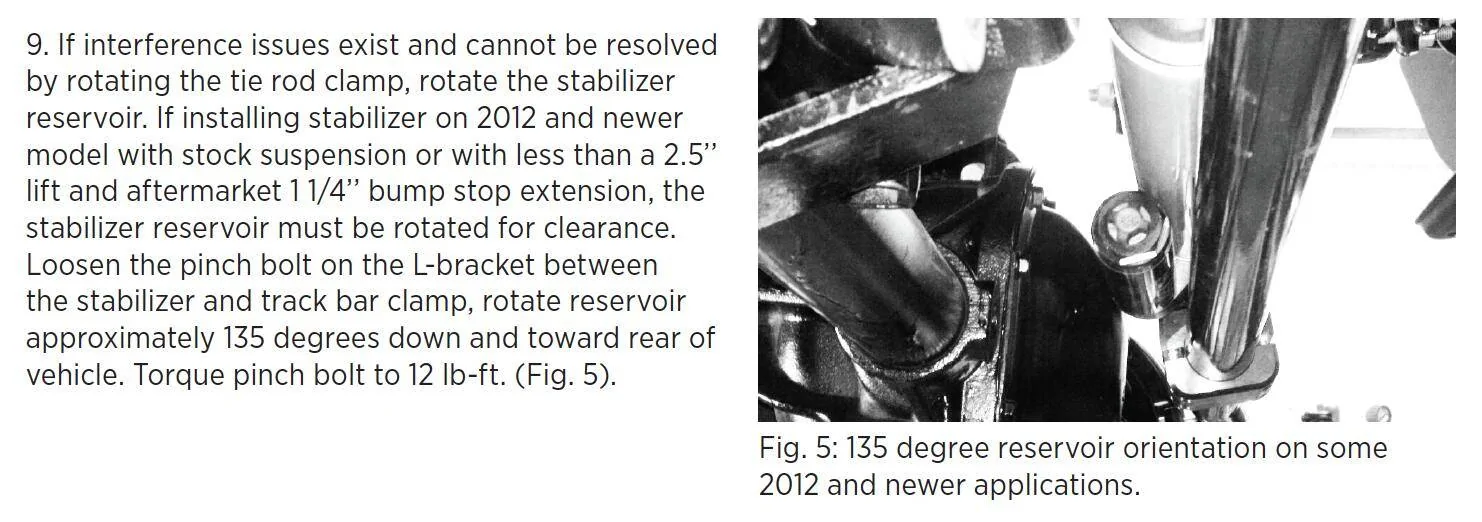

The Fox install instructions for the JK version (mounting it on a JK of course) has this:
Jeep Gladiator Fox ATS Stabilizer Screenshot 2025-03-27 at 8.23.15 PM
Don't know if it will work to provide enough clearance on a stock height JTR.
