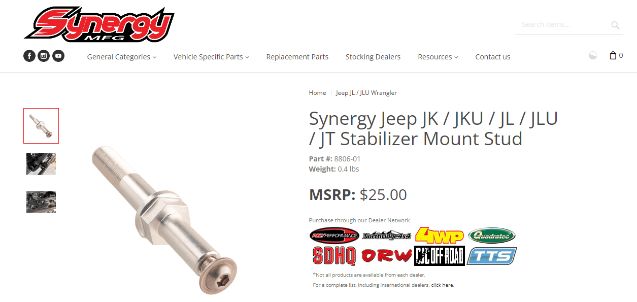

I've gone deep down the rabbit hole and I've read so much I can't seem to keep everything straight. I just ordered a Fox 2.0 ATS steering stabilizer. I'd like to protect it a bit by lifting it up out of harms way, so I also ordered the Synergy track bar stabilizer mount stud. Do I need anything else or will these two pair together nicely?

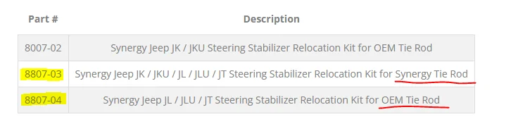

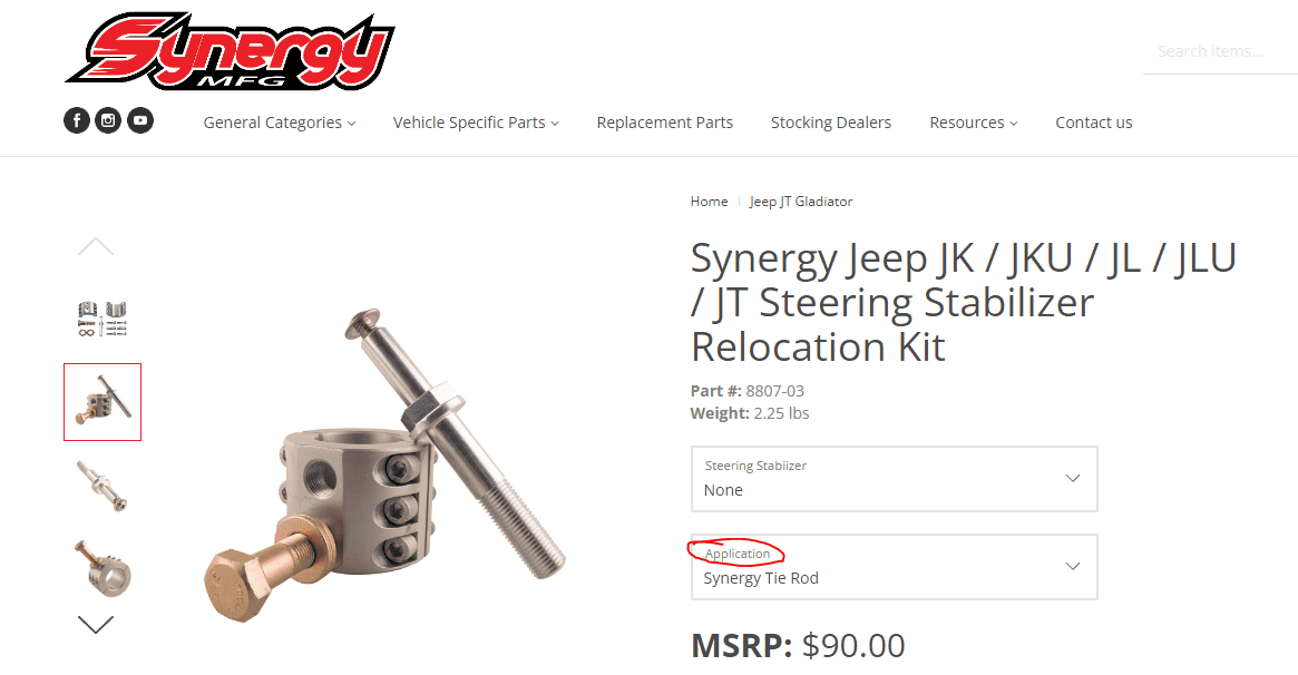

Here's the Synergy parts you'll need for Fox ATS #983-02-148
1) Synergy Steering Stabilizer Relocation kit (get the correct clamp for your tie rod)
Jeep Gladiator Fox 2.0 ATS and relocation 1682375052933-png

Otherwise if you ordered Fox ATS #983-02-142 (for 1.5" non-OEM tie rod bar) you just need to order the Synergy Mount Stud... again, this part number assumes you already have an aftermarket tie rod bar.

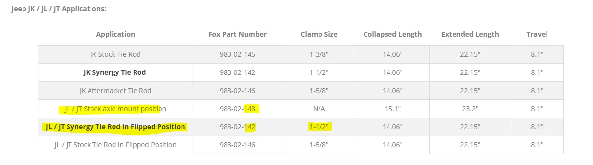

Here's a handy chart on Synergy's website that explains OEM position vs "flipped" position
Jeep Gladiator Fox 2.0 ATS and relocation 1682375493456

I’m assuming you got the kit and not just the stud. Otherwise you need a clamp to mount the other end of the ATS to your tie rod.
That's where my confusion stems from! When reading the description of the stud itself, it makes it seem like you don't need anything else. If I only used the stud and not a clamp, the stabilizer wouldn't function correctly, right?
Your stabilizer would only be mounted to the axle on both ends so it wouldn't do anything

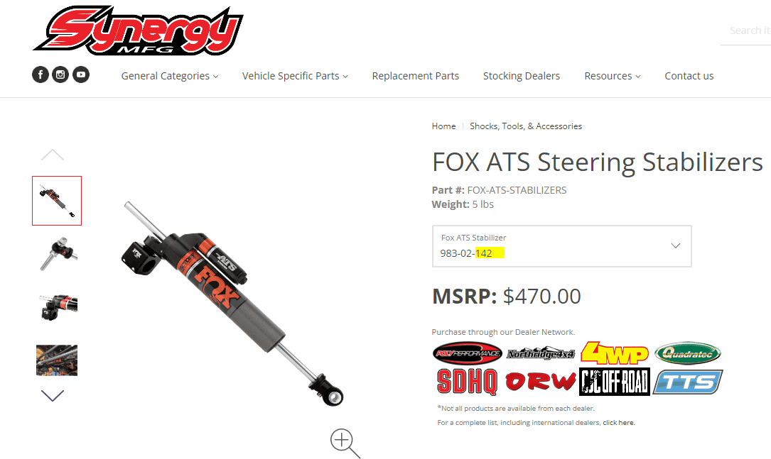

Thanks for all the detail. What I ordered shows 983-02-148. I'll wait to show up before ordering anything else, it seems like this is all I need.
https://www.northridge4x4.com/fits/...ox-2-0-factory-series-ats-steering-stabilizer
https://www.northridge4x4.com/fits/...manufacturing-track-bar-stabilizer-mount-stud
Fox ATS 983-02-148 will require additional Synergy parts to run it in the "flipped" or "high clearance" position. You will not use the bracket Fox provided with the stabilizer
As noted, you’ll need a clamp that is both compatible with the ATS (they use special button-head or otherwise flush mount bolts) and is the correct size for your tie rod (presumably stock, which I believe is 1 5/8ā€ OD). When you use this stud, you’re ā€œflippingā€ the stabilizer such that it mounts to the frame on passenger side and tie rod toward center, as opposed to tie rod on passenger side and axle near the center.

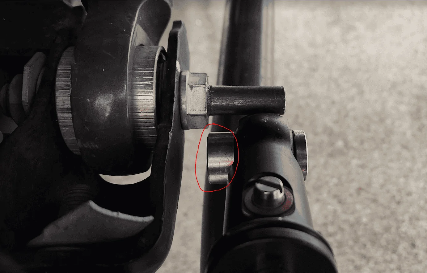

I received a response from Synergy:
"You will need to run an ATS in the factory location on a stock tie rod. There isn't enough room to run it in a high mount setup with a factory tie rod."
"The tie rod sits too close to the track bar mount and will not allow everything to bolt up. You will either need to get an ATS that bolts into place (factory position) or get a Synergy tie rod to run the high mount."
So it appears that I'm going deeper down the rabbit hole. I've changed my order from the 1 5/8 Synergy tie rod clamp to the 1 1/2, and it looks like a new tie rod is in my future. I damaged my stock stabilizer on a trail, so I really don't want to mount a $450 stabilizer in the same spot that damaged my stock one.

Reviving this one. This isn’t true is it?
I have the stock tie rod but Steer Smarts everything else and now trying to stuff my Fox ATS under there. Going to order the Synergy stud and use the steer smarts tie rod clamp. Visually looks like it should work.
