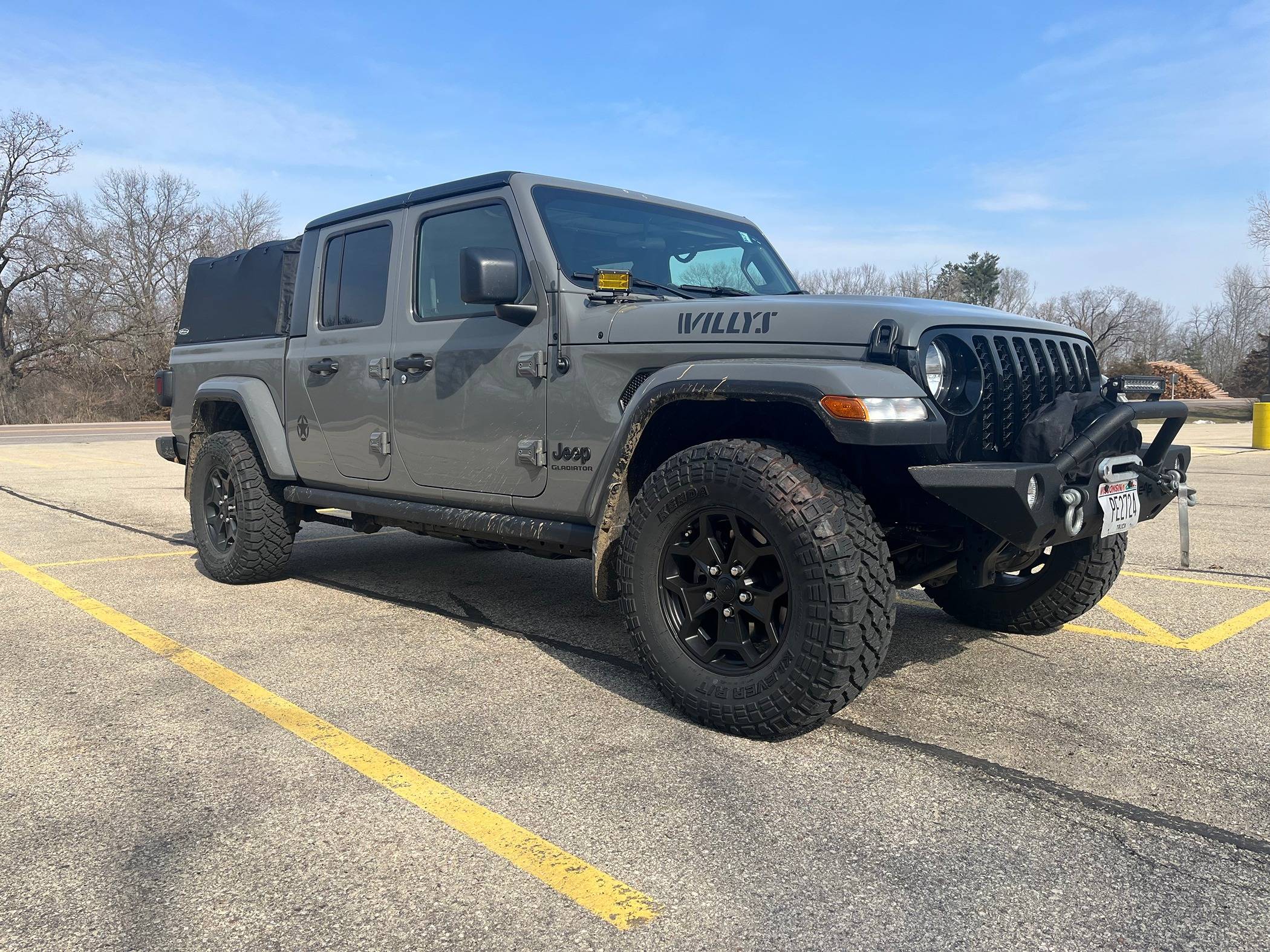

My wife and I are looking at getting a camper. This one (Jayco Hummingbird 17rk) looks good and seems that it would pull easy. I have a 21 Willy's with gas engine and 3.73 gears and 33 in. tires. I would appreciate hearing your experience...

Just note, with your larger tires, your towing capacity (and ability) will be diminished so, bear that in mind when looking at campers and their weights plus, the frontal area of the camper as wind resistance will also hurt your ability to maintain speed in a reasonable gear and RPM range.

The specific camper is around 2900 lbs. although I am open to rehearing really don’t want to add $2500. To the mix.

Your truck will tow that trailer no problem, but any hills will be at a higher RPM. Some people freak out at the high RPM but these trucks are designed to be at a higher RPM for max torque and Hp.
FYI, If you are over 6' the bed will be tough to sleep on. I had the same bed length on mine and at 6'1" it was hard to sleep on for me. My feet and head hit both walls.
I believe your trailer will have almost 4k GVWR so you tongue/hitch weight will be around 500 lbs. Depending on how many extra's you have on your truck the tongue/hitch weight could put you over on your truck's payload number. I had a Tacoma TRD Offroad with bigger tires, sliders, skids, roof rack, toneau cover, recover gear, and when I added my wife and I, camping gear, firewood, Bbq and a generator I was over payload with essentially the same size trailer.
Always us a Weight Distribution Hitch, Trailer Brakes and maybe an anti sway bar. I used all on the Tacoma and it towed great.
I have since traded in the Tacoma and purchased at 2023 Gladiator Max Tow so I can tow a trailer with 5500 lbs GVWR. Tows the new trailer with ease.
