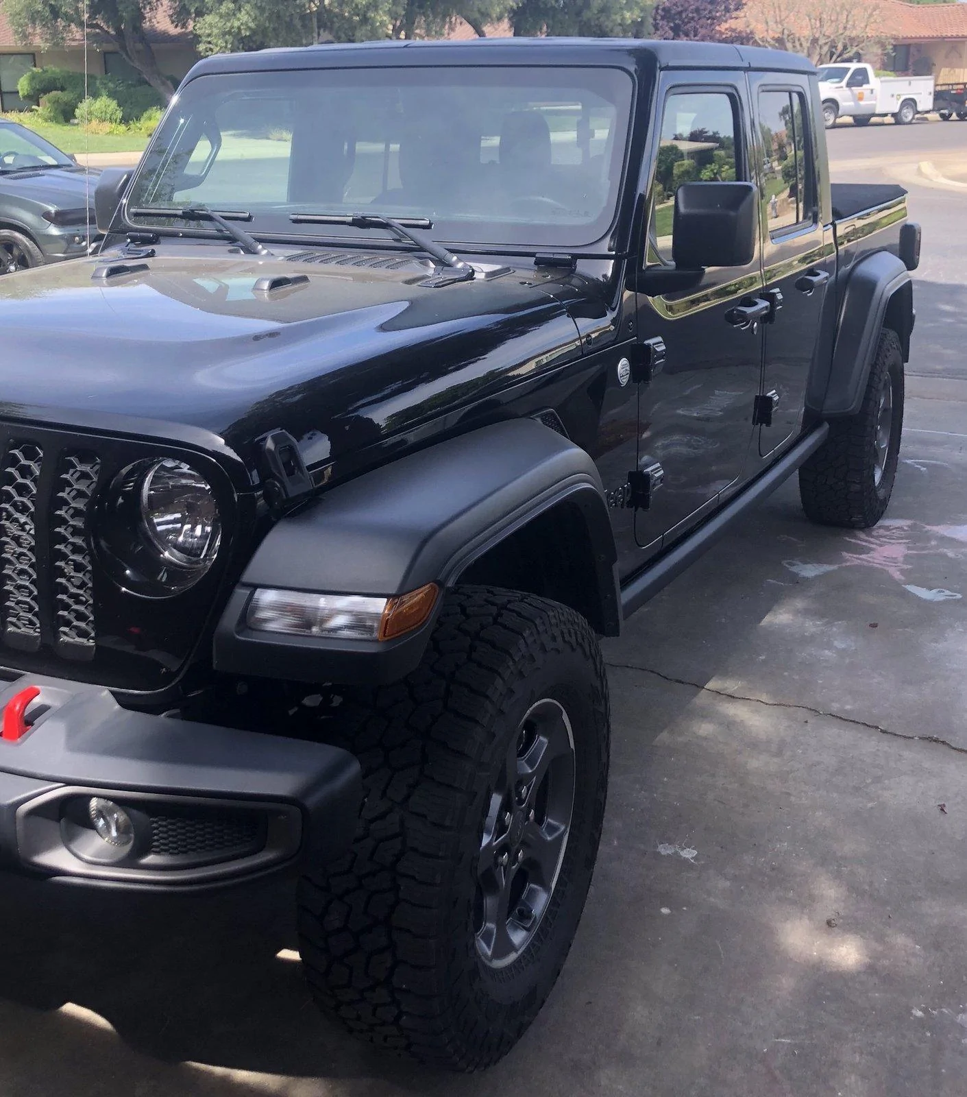

My max tow rides great on rubicon 33’s ATs and agree no noticeable mpg change however I also didn’t see a big difference when running 35” MTs
