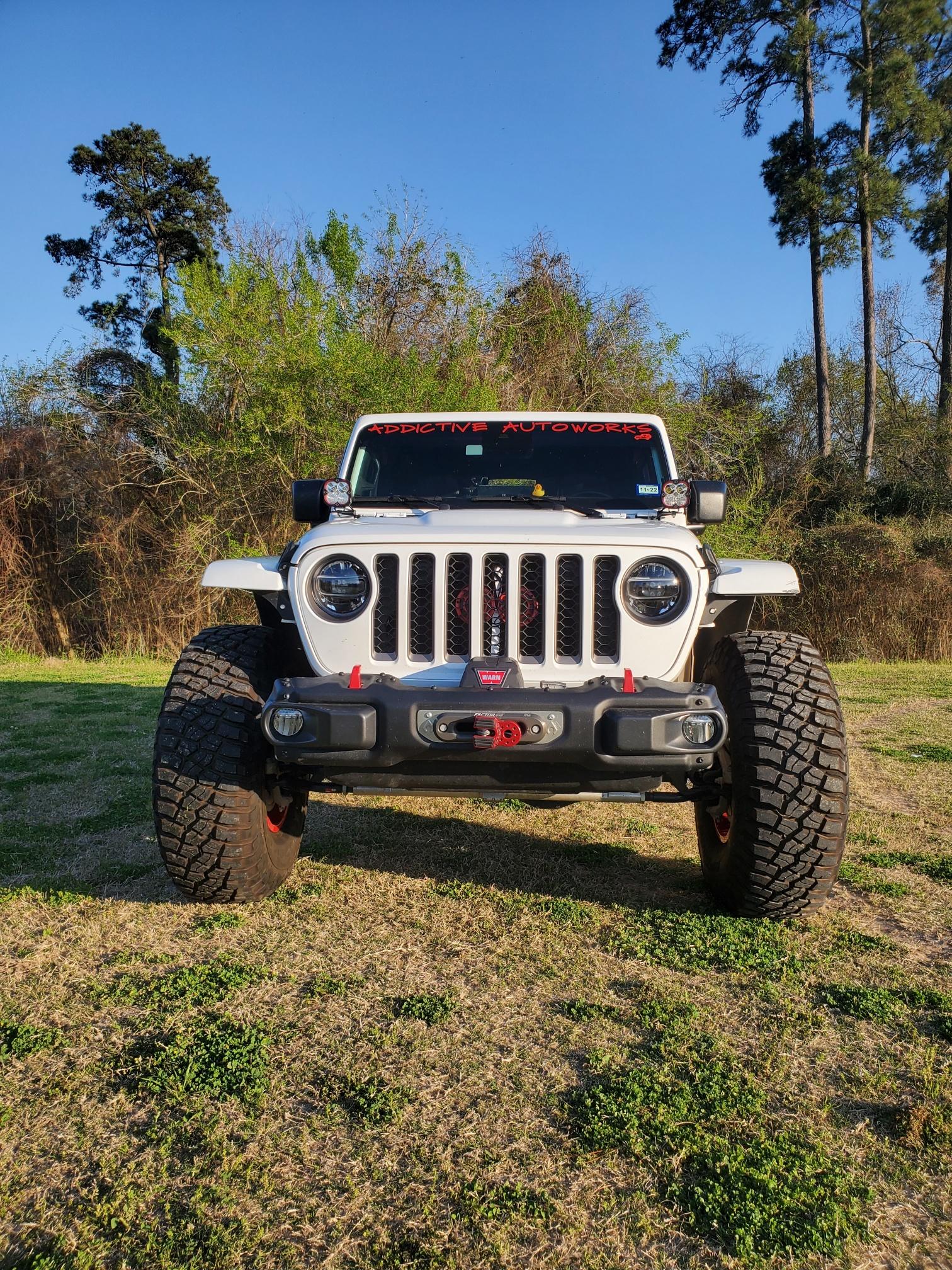

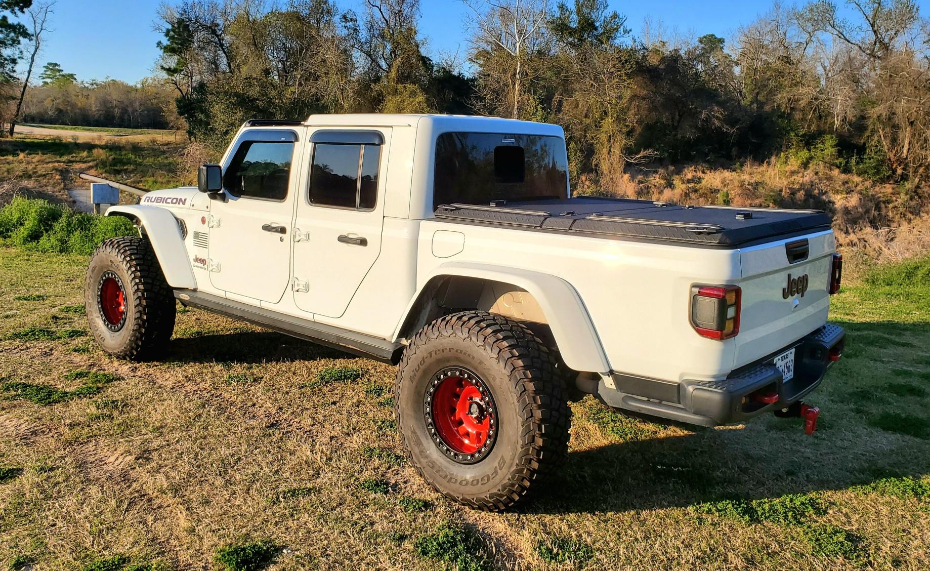

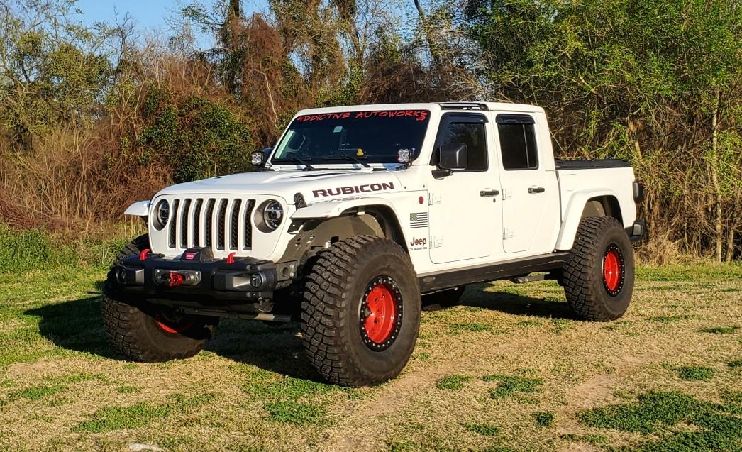

Looks great! What wheels/backspace? Also what lift are you adding the RK 4-link to? Long arm?I managed to snag a set of these recently and got them mounted this past weekend. My 37 KM3s are going on the wife's Wrangler build.
So far, I love them. We'll see how big of a difference they make in the rocks.
Also, I've got a Rock Krawler 4 link going in the rear in the next few weeks... I suspect the 39 will fit in the stock spare location after that.

Thank you sir!Looks great! What wheels/backspace? Also what lift are you adding the RK 4-link to? Long arm?

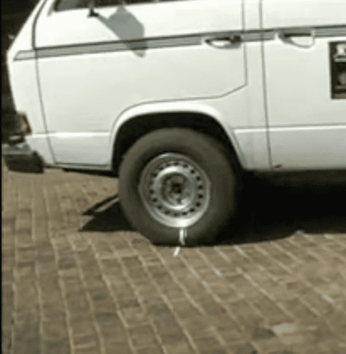

You've got 39s now, you can prove this in real life. Go out to your drive way and put a small spare tire across from your 39 and air down the 39 until your axle is level, put a piece of tape at top dead center on each tire and move your truck one tire rotation. Those pieces of tape will not land in the same spot after a single tire rotation, not even close. Imagine that times multiple tire rotations per second. Your ABS system will have problems with that.

And, here is a crusty old video of someone actually attempting to apply that math in the real world (spoiler alert: it doesn't work) -->
I invite you to go outside in the real world and conduct the same experiment. Post back with your findings.
