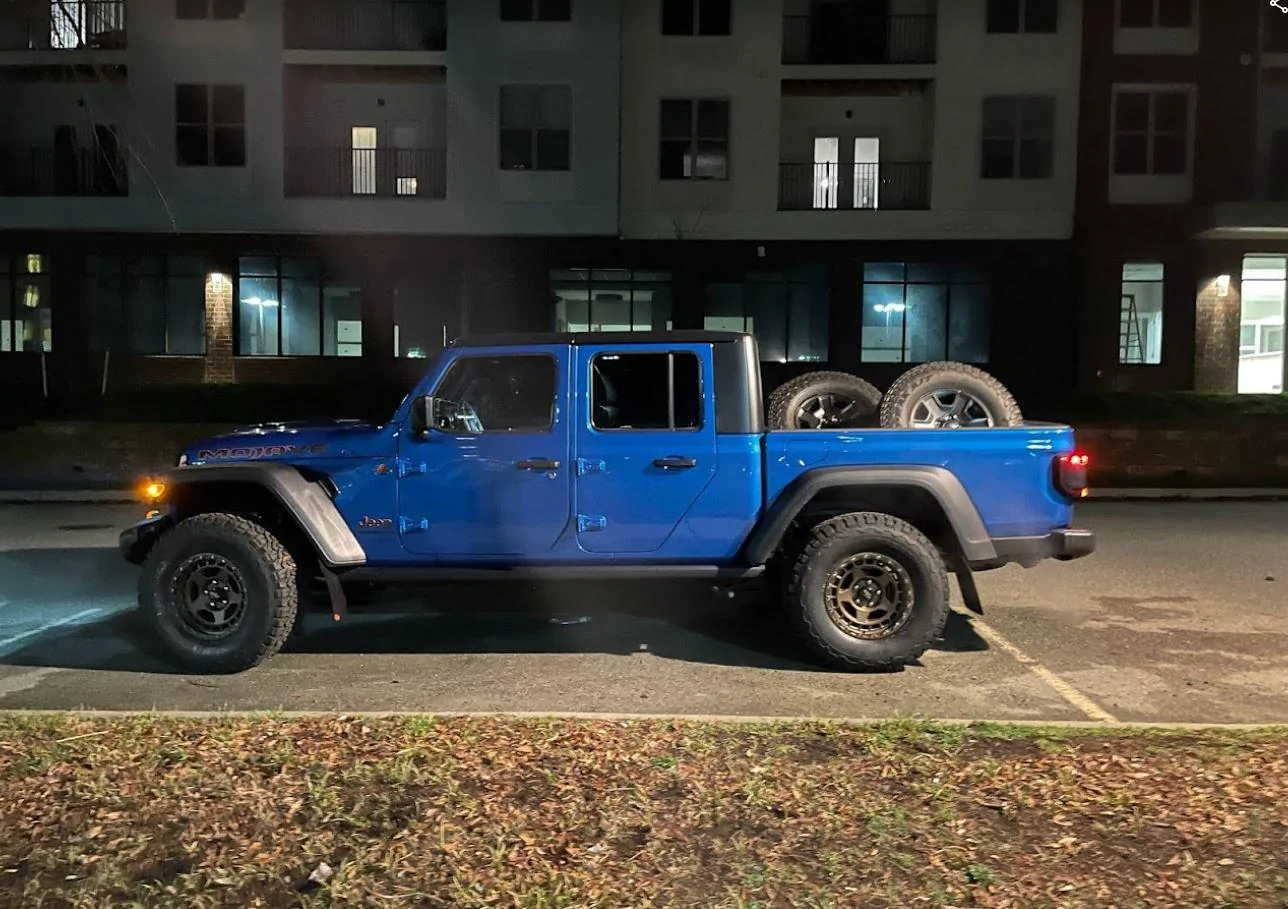

Here's mine on the 315 70 17 BFG no lift
Jeep Gladiator BFG ko2 35s or 37s IMG_20200213_183207
Here's driving with them on the interstate

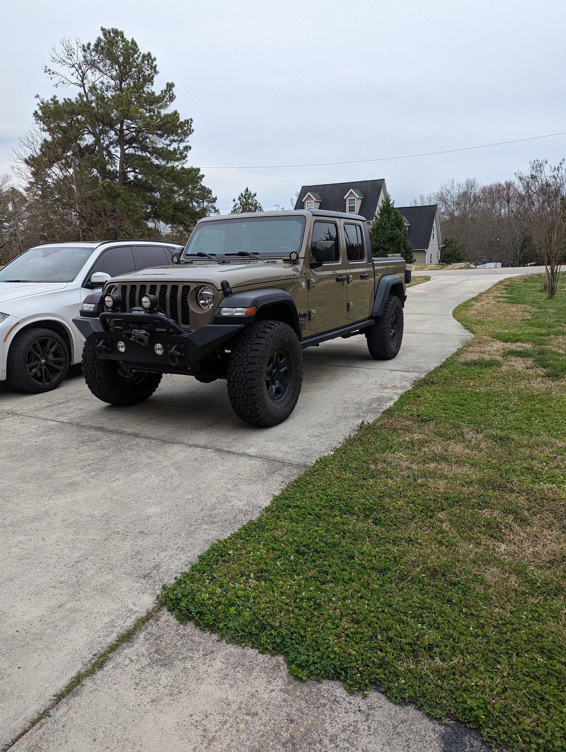

Here's mine on the 37 12.5 17 Kanati Trail Hogs. This is with Rubicon Front Springs and a 2.5" Readylift SST Spacer lift
Jeep Gladiator BFG ko2 35s or 37s PXL_20220315_220315579.MP
Here's driving on the interstate
Mines a Max Tow which has some of the same setups as far as axles and gearing of the Mojave and Rubicon so this should give you a idea of what to expect.

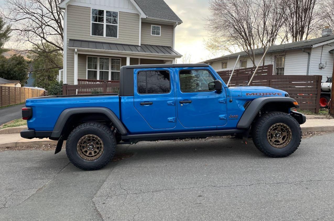

I just put 35" (315/70/17 size) BFG ATs on my Mojave (no lift).
Did a ton of research on tire weight; the load range C BFG's actually weigh less than the OEM Falken AT's. So if you can find a wheel that is relatively light then no worries about tanking any performance.
Enjoy the mismatched wheel picture; the amazon seller selling Rock Trix wheels sent me the one incorrect wheel. They were great about getting the right one shipped out. For you all you get to see what the RT115 (5 spoke, what I ordered) and the RT114 (9 spoke). Specs are the 17x9 +12 offset. Personally I wanted specs closer to OEM like the AEV Plinter is, but the Rock Trix were so cheap and they don't stick out too far with that +12mm.

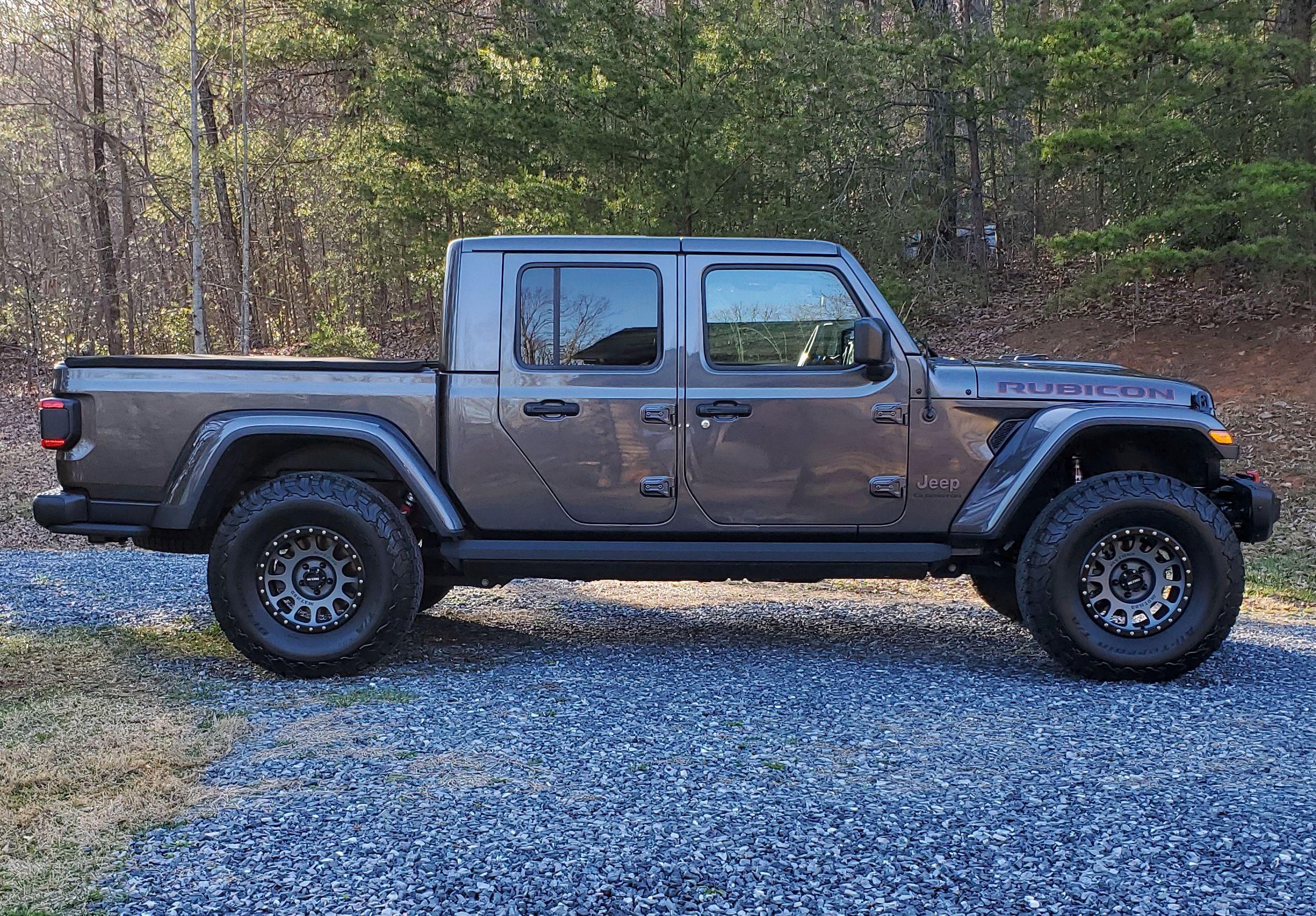

Have 1 year and 25k miles on my BFG 37s, Clayton 1.5 level kit (highly recommend), Rubicon with stock 4:11 gears, light trails only, and had the same debate, glad I didn't do 35s. The D rated was the only choice at the time, now they have a C rated, even lighter. I will go with those next, my weight per wheel and tire increase was my focus, had a very small increase over stock, don't see a need to regear, but I think that could be subjective based on available cash and ease of install options.
