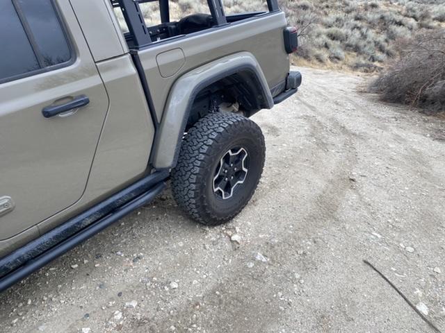

I wrestled with that for a brief time and went 37s I admit I was nervous looking at how big the tire was compared the rubicon stock falken but on the drive home and since then I have no regretted it. Now my typical commute is about 375 miles one way once a week down and back. Starts at 3400 ft goes through the mts down to the Central Valley then up the grapevine to 4400 ft near Gorman ca. There. I take it off road just to see if I can get it to rub. So far. Not that’s just a mile or so but it usually has mud some foot deep,ruts that I deliberately stick a tire into and at one point a sharp turn and steep 26degree drop off. Nope no rubbing.thats off Ralph’s ranch. Road
On the the freeway I’ll be doing 75/look at the tach and see it’s just turning. 2000 rpm. Yes flat ground. Doesn’t hunt gears any more than the stock tires did.
I’ll add a lift but a very small one no more than 3.5. And maybe regear. But I don’t really feel like I need it.

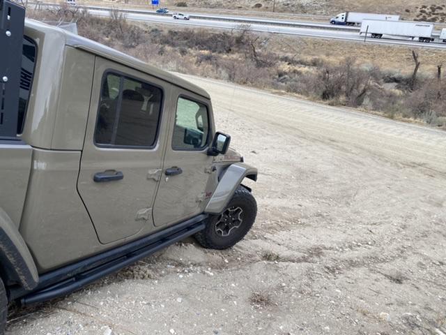

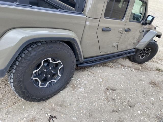

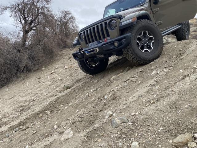

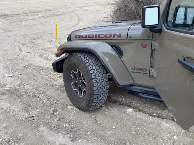

Is that on OEM suspension?
Here is my rubicon on 37 x12.5 BFG ko2 going off a flat spot on to a. 26 degree slope yes that is stock suspension on stock wheels no rubbing. Only when I back up and turn hard left like really hard you know that las 1/4 inch when the power steering pump makes a little groan does it rub
