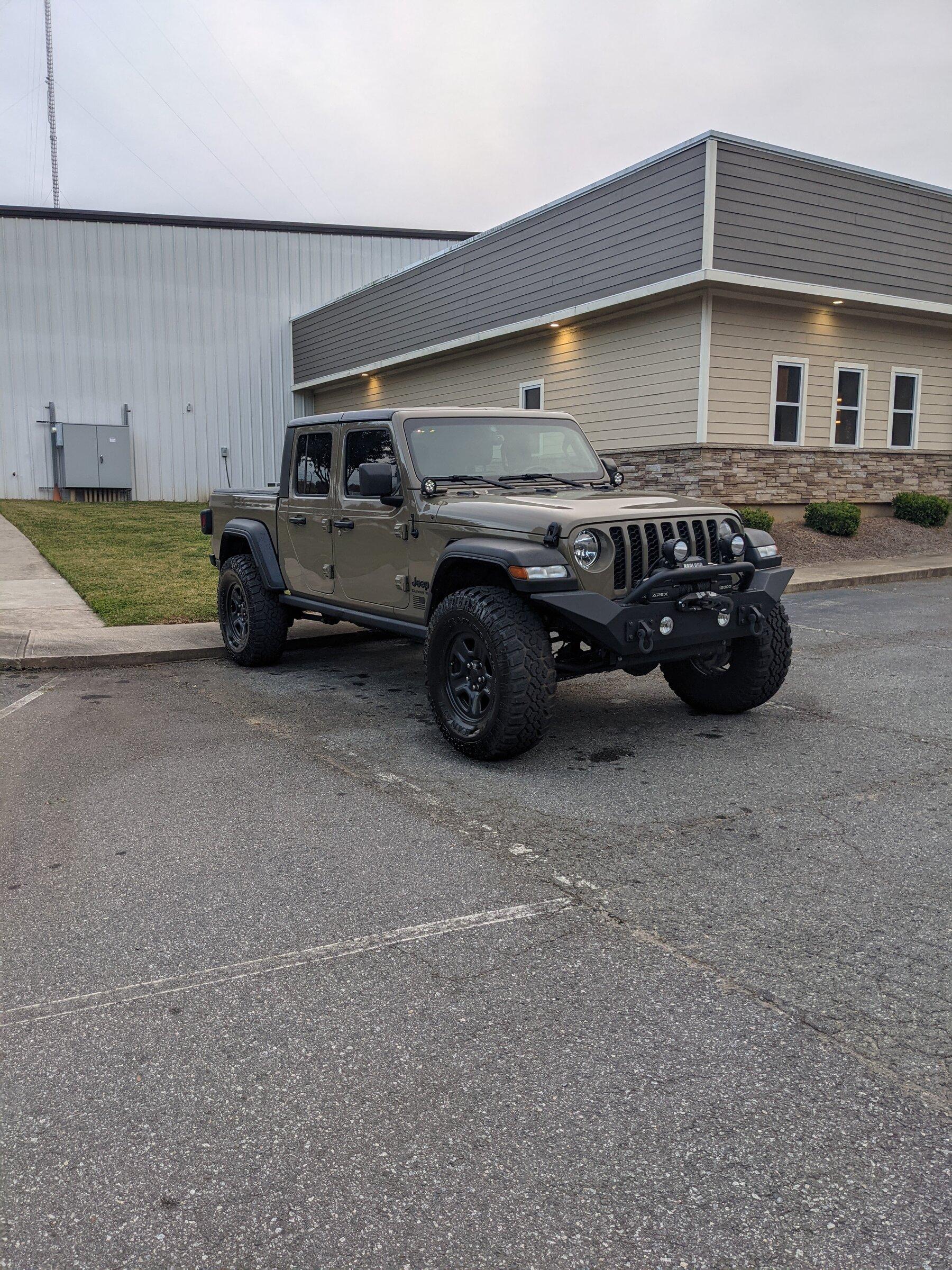

Thanks
Started with a sport s gasser. 2” mopar with 3/4 spacer up front. Metalcloak control arms, Currie Antirock, Yukon 5.13 gears. 17” scs k5 wheels with 37/12.5 Yokohama x/at tires. Rugged ridge arcus front bumper with rc winch, Oracle headlights and metalcloak fenders with their inners also. About to add rpm steering as soon as it arrives.
It looks great. Mine as it sits, still pondering the fenders, had my stock ones bedlined about 2 months ago
Looks good. You should be able to do a fender chop on your fenders. I had considered doing that before the metalcloaks.
