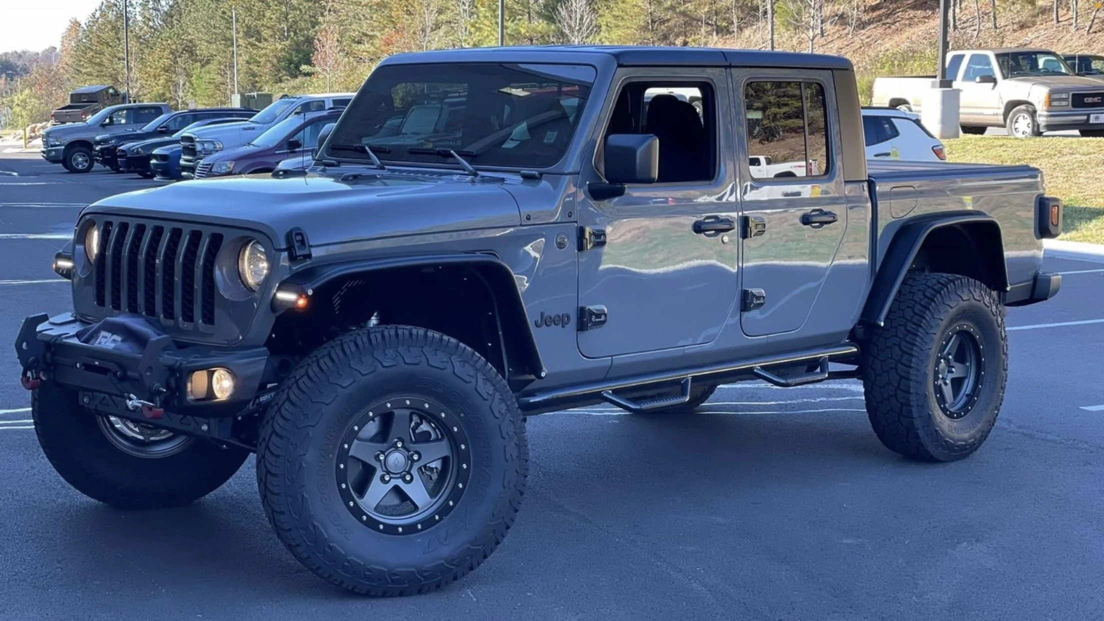

Looks great! Just got my Glacier White Rubicon. Still deciding on wheels and tires but my question to you is what lights and mounts are you running on your A pillar? I love the way those look

Hella Value fit lights off Amazon and some cheap brackets I found on amazon also. I ran a set of the Value fits for backup lights on my JKU and they served me well so I figured I'd throw a set of the spots on my windshield. I'm a fan of round lights.

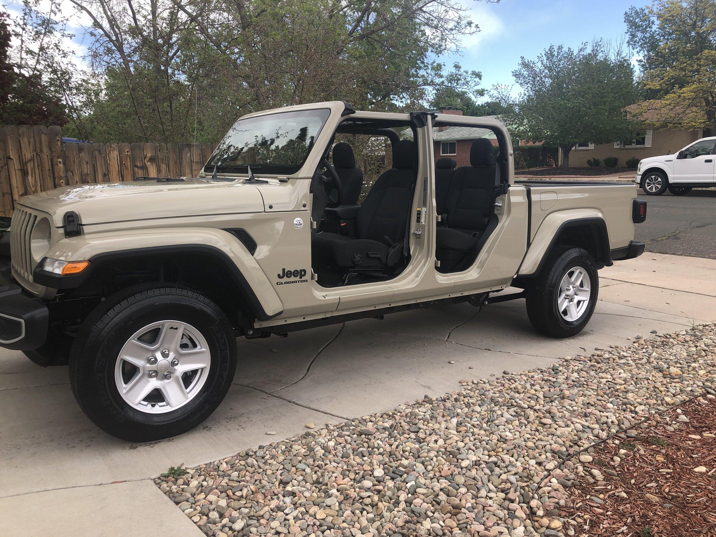

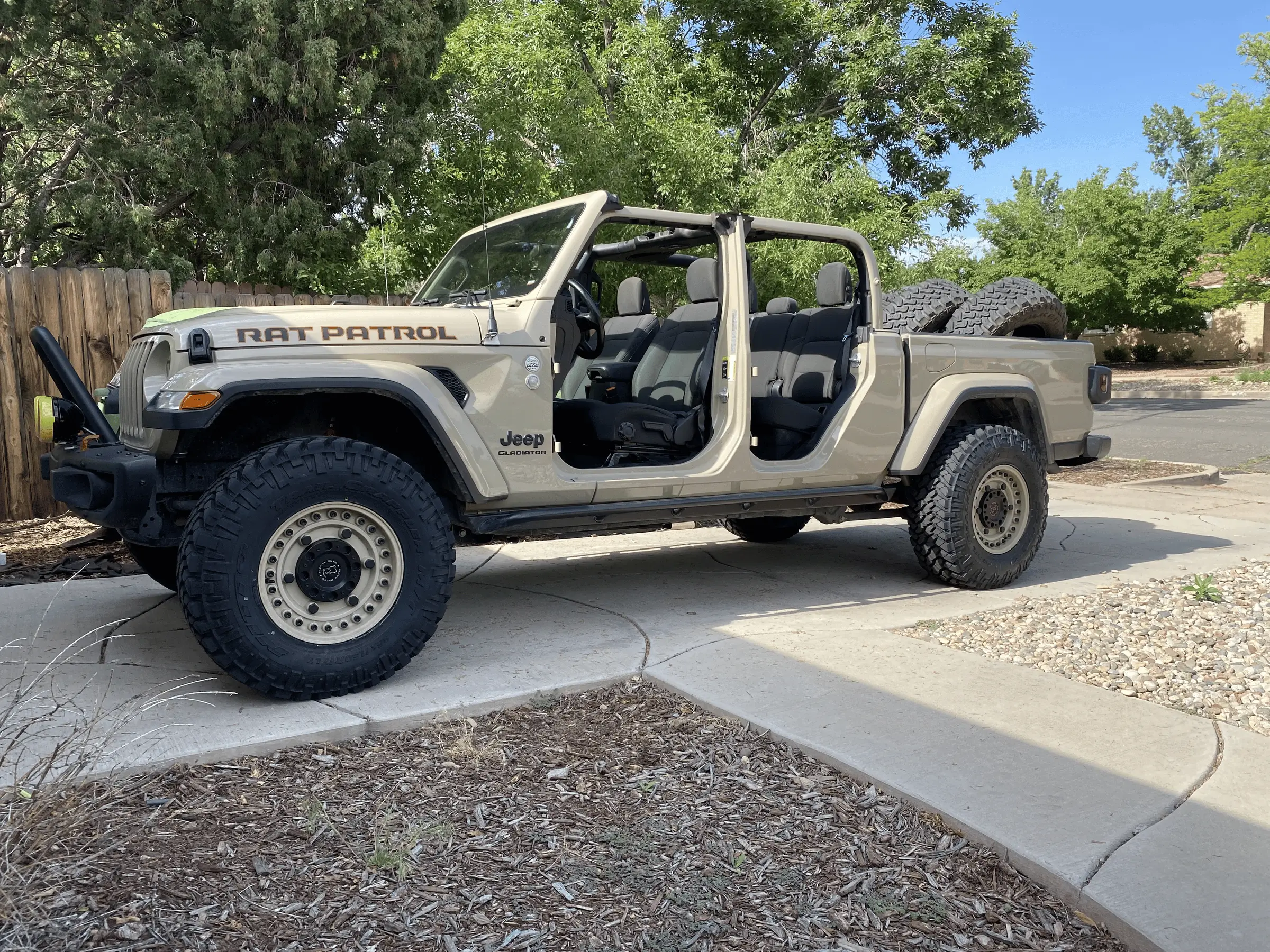

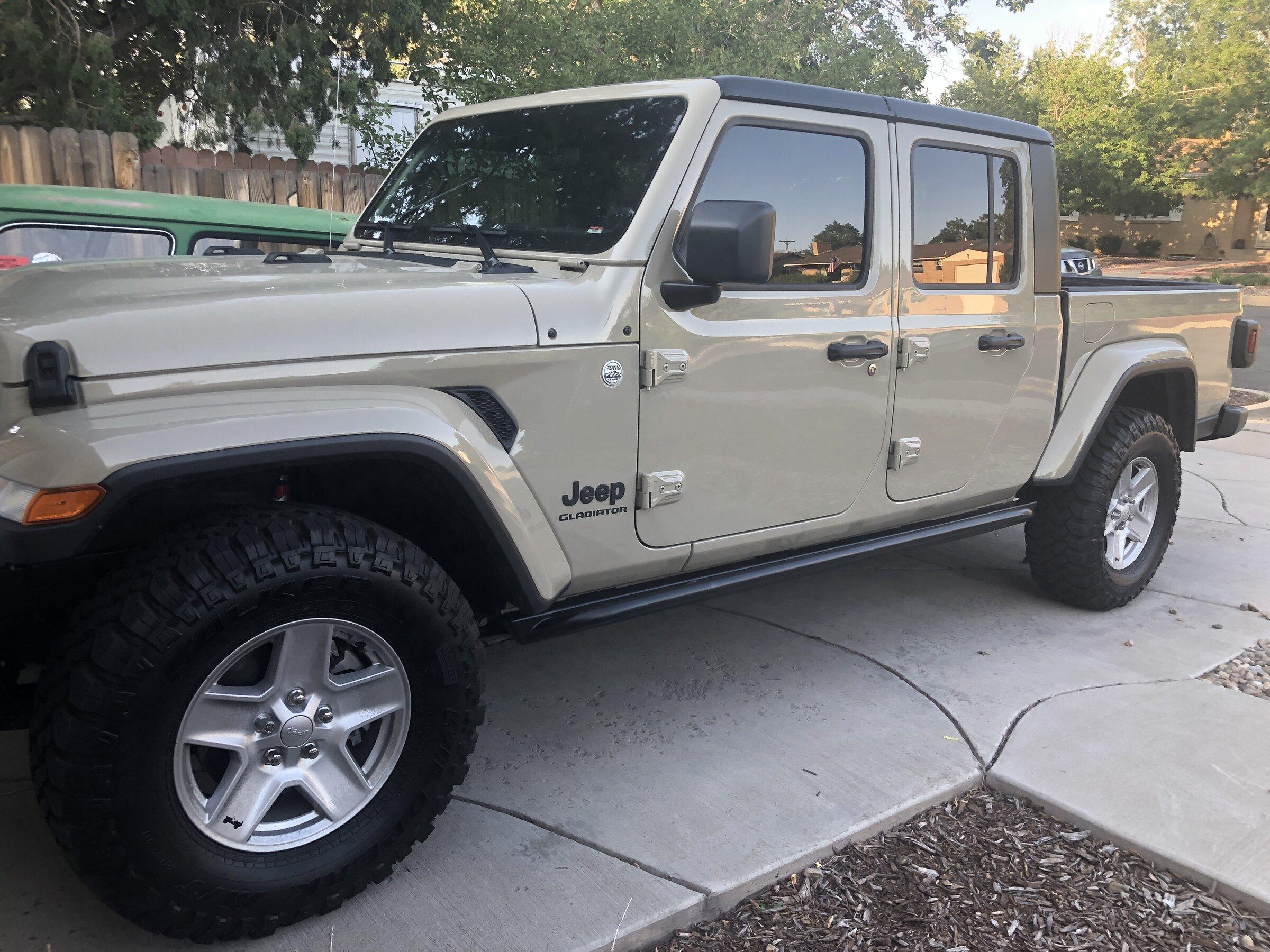

Man. I went through this whole battle. Sport S with 3.73.
Then went to 33s added Rubicon take offs.
Added a Terraflex 1.5" Spacer.
Lasted a year on 33s.
Went to 35s.
Immediately had to go to 4.88 gearing.
Wheeled hard on 35s like this.
Added a winch...Rubbed a tiny bit at flex on the inner fenders.
Then decided Clayton 2.5 Overland plus and the Falcon sp2 3.5 shocks.
Now looking at trusses and things to do 37s right.
Can get away with the 4.88 gear and 37s.
Plan is to eat up the 35s first.
Went to 35s.

I live at 6,100 feet. You are in Guam. So I assume pretty damn close to sea level.
The JT is underpowered from the get go at 6,100 feet. When I did Imogene I was at 13,100 feet. I opted for 4.88 and it works great for me. Plus I knew I could nudge into 37s if I wanted to.
If you have a JTD, you do not need to regear at all. There is a science to regearing and an opinion piece. Some tell you they run 35s or 37s and 3.73 and love it. I didn't last a week before I ordered gears. My advice is to find a rig with tires you have and a gear swap and drive it.
This is my first jeep. I learned as I went. My philosophy is overbuild it for what you intend to do. Then wheel just under or at the capabilities of the rig. I wheel as much as I can. We hit some solid trails from intermediate to lower end of what people would classify as hard. I plan on trusses, better steering knuckles, and beefier ball joints. Maybe a stouter shaft. Maybe. I am sure there is a guy or gal on here who knows way more about this than I do.
