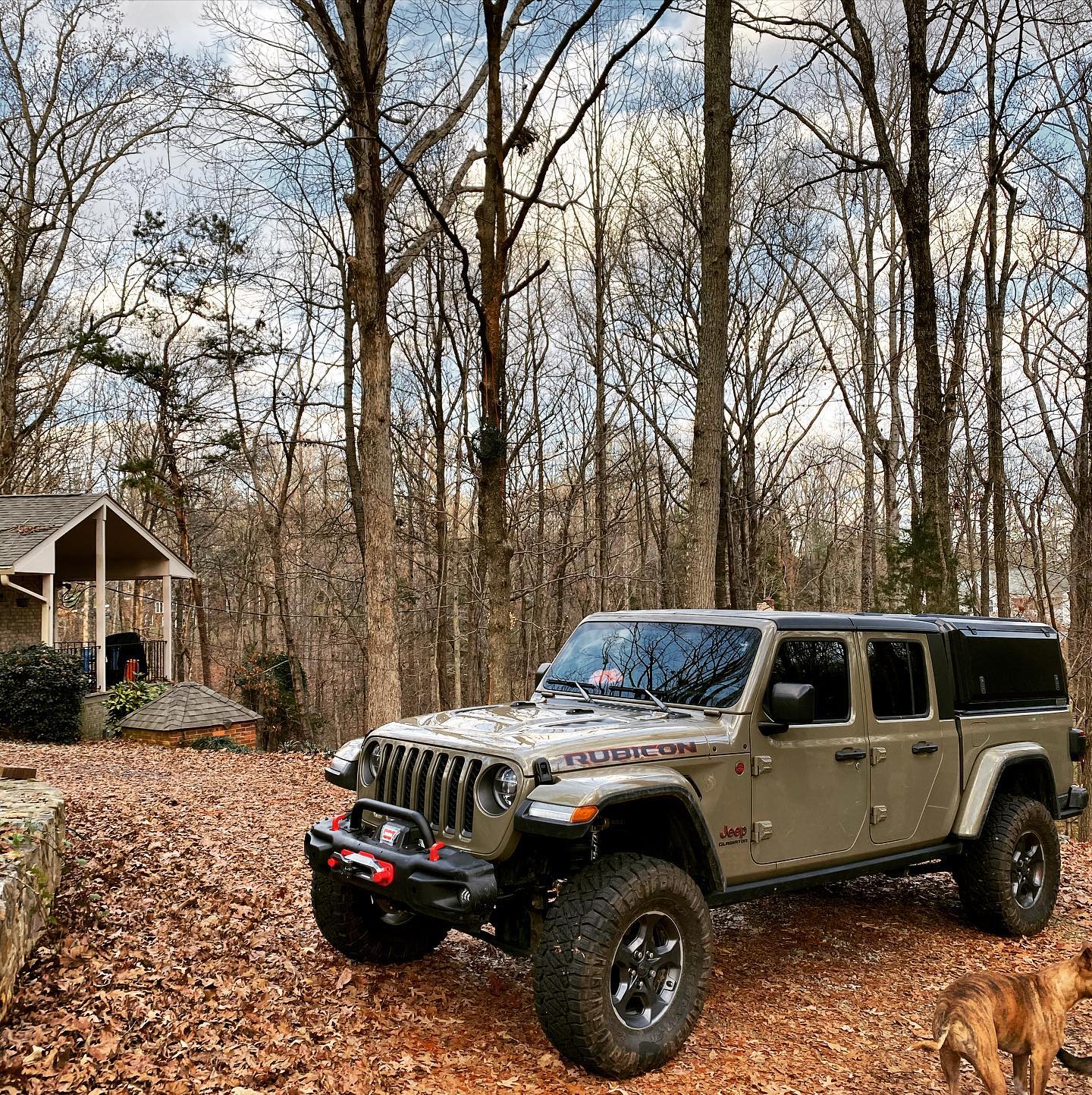

My Gator JTR has 35" Nitto Ridge Grappler tires, Clayton Off-Road 2.5'' Overland Plus system (LCAs, UCAs, Track bars, etc.) and 1.75" wheel spacers for your reference. I plan on trussing and regearing before (if) going to 37" in the future, but I think the truck looks great as is! "Wheeling" these tires in muddy conditions in Uwharrie was no problem @ 20psi...for me at least.
that front looks a lot higher than 2.5. Maybe its just the pic but i would ha e guessed 3.5+
Clayton kits run tall... it's more around 3.5" for the advertised 2.5"
gotcha that makes sense. Aev does the same. Their version, and id guess @Clayton Off Road is that it’s “2.5 at expedition weight” type deal.
that clayton offroad stuff is really really nice.

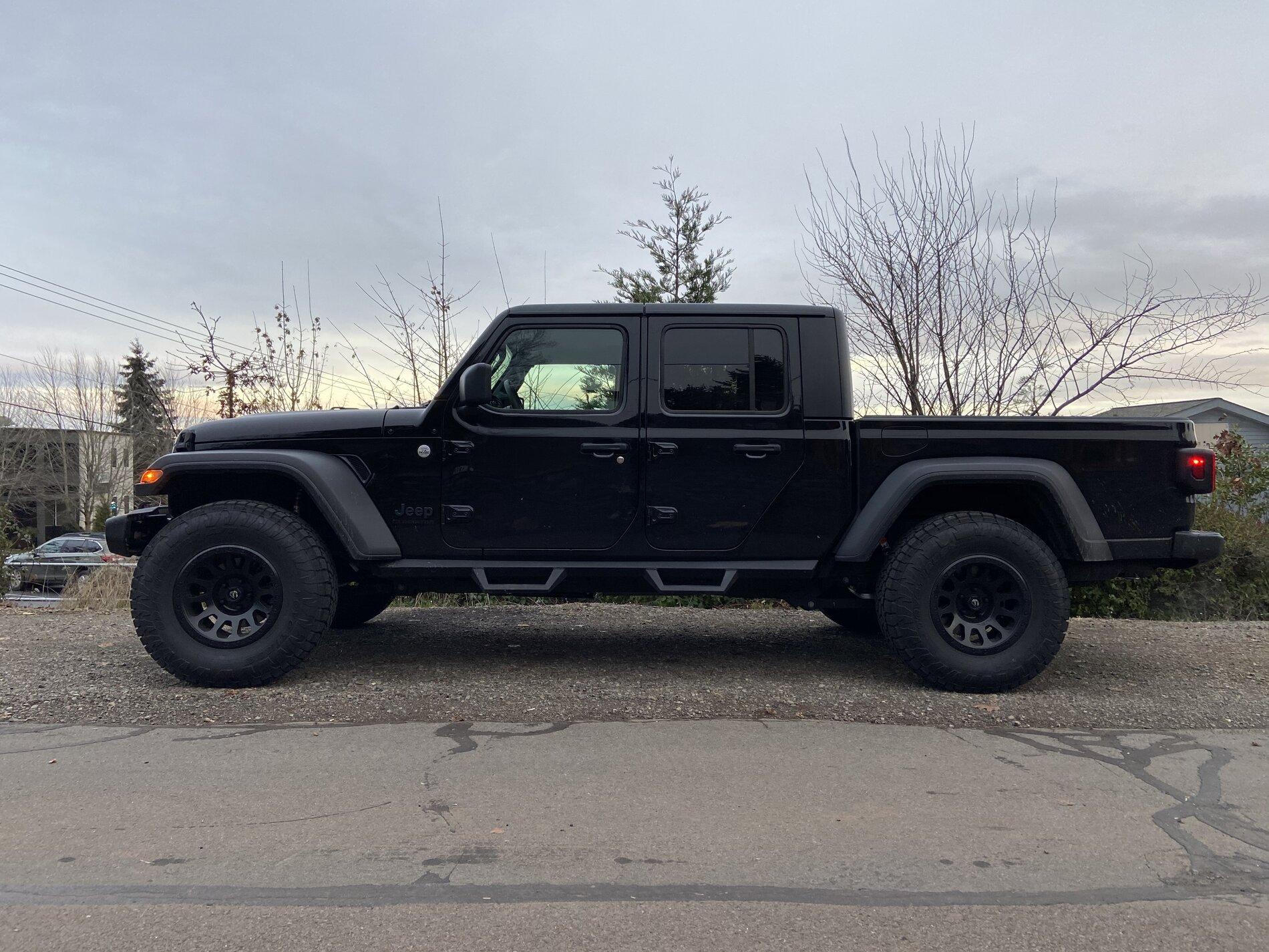

I went with 35s for the practical reasons. Mine are Cooper Evolution MTs. They only weigh 64lbs. Which is really light for a 35. They feel the same as my stock Falken 33s. Plus I’m running them on my stock wheels.

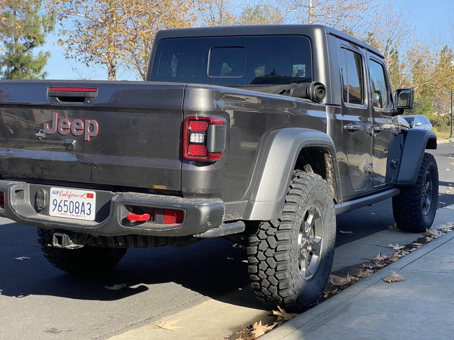

35” x 11” Toyo AT3. Leveled the front of my sport model a touch with rubicon springs and a .5inch spacer. Hated the 3.71 with a manual transmission so installed 4.88.
