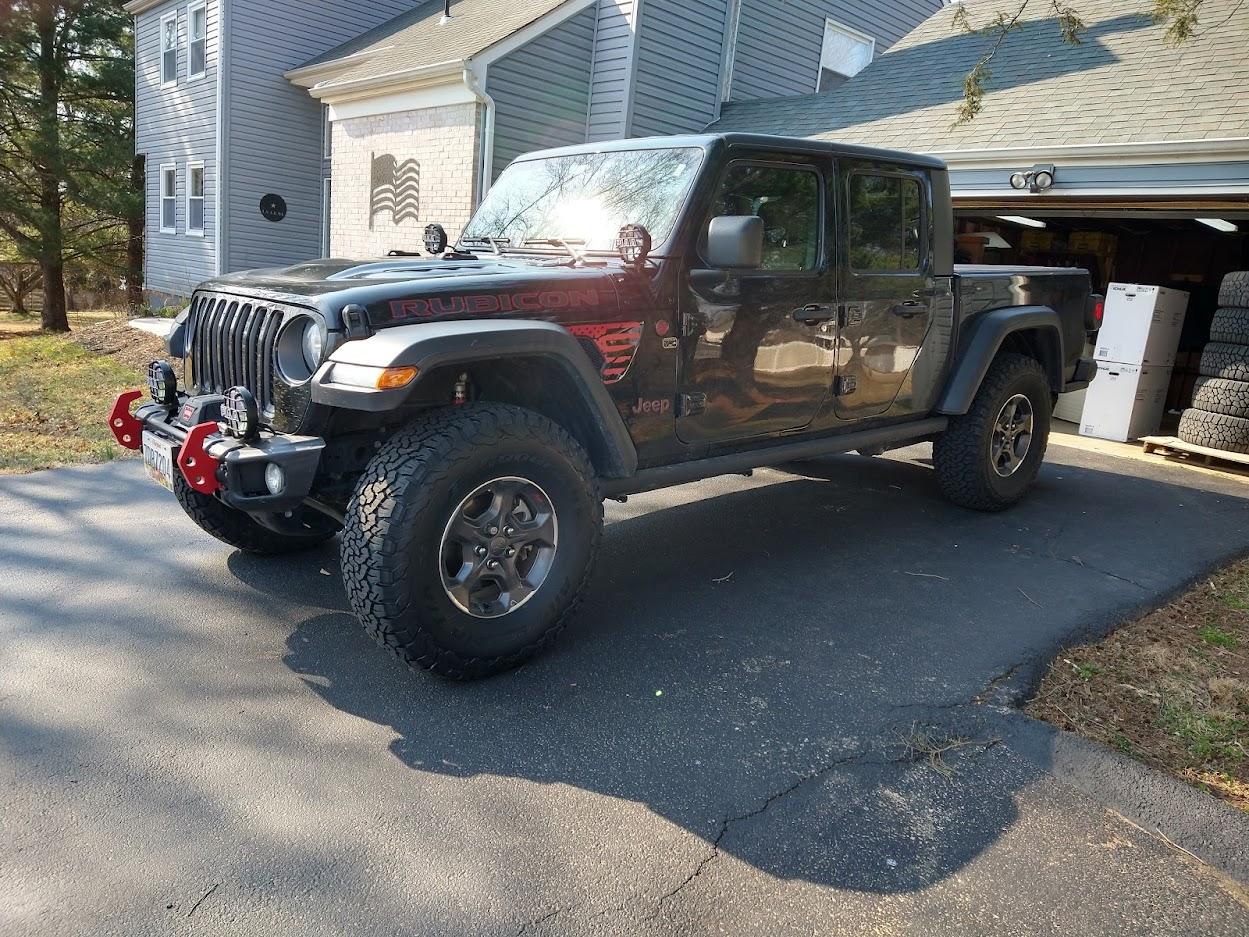

I had the same dilemma. i ended up going with 37 KO2's (Load Range C), stock rims, 1.5" leveling kit. stock 4.10 gears. No complaints so far. Some say they are 35's, I disagree, probably 36"s would be more accurate since sitting at 34 psi loaded they are about 35.25 inches . No 35" I have ever seen has been over 35" loaded. Last weekend I average 18.2 MPG on a 400 mile trip through Maryland and Pennsylvania.

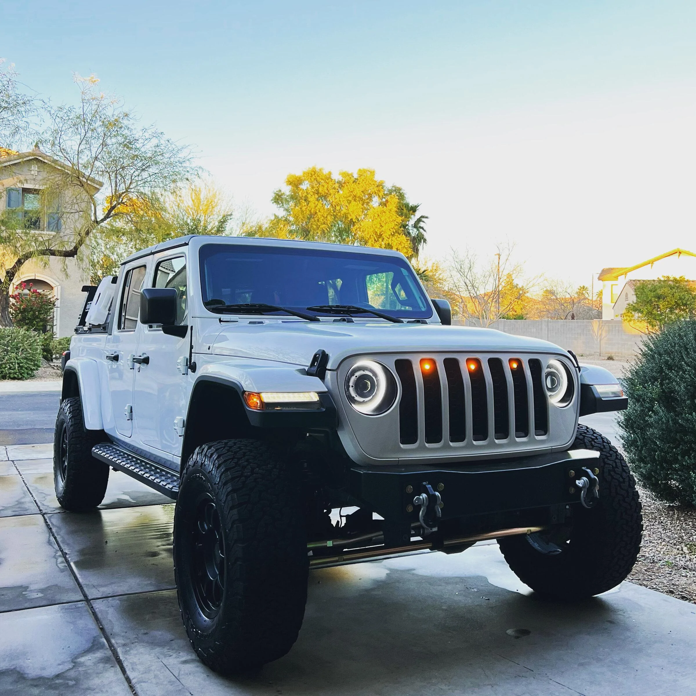

I have 35" KO2's on my Max Tow with 4.10's. I average about 18 mpg here in Phoenix. Mostly highway driving and I see 8th all the time and consistently. Like you said, they run a little on the smaller side and lighter which helps. I'm considering going to 37" KO2's once these wear out but overall I'm happy with the 35s. I have a 2" lift so the tires don't look too small.
KO2 35" are more like 34.4".

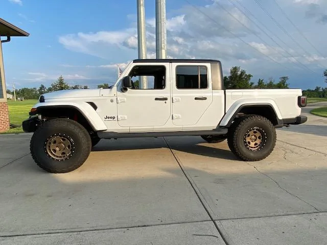

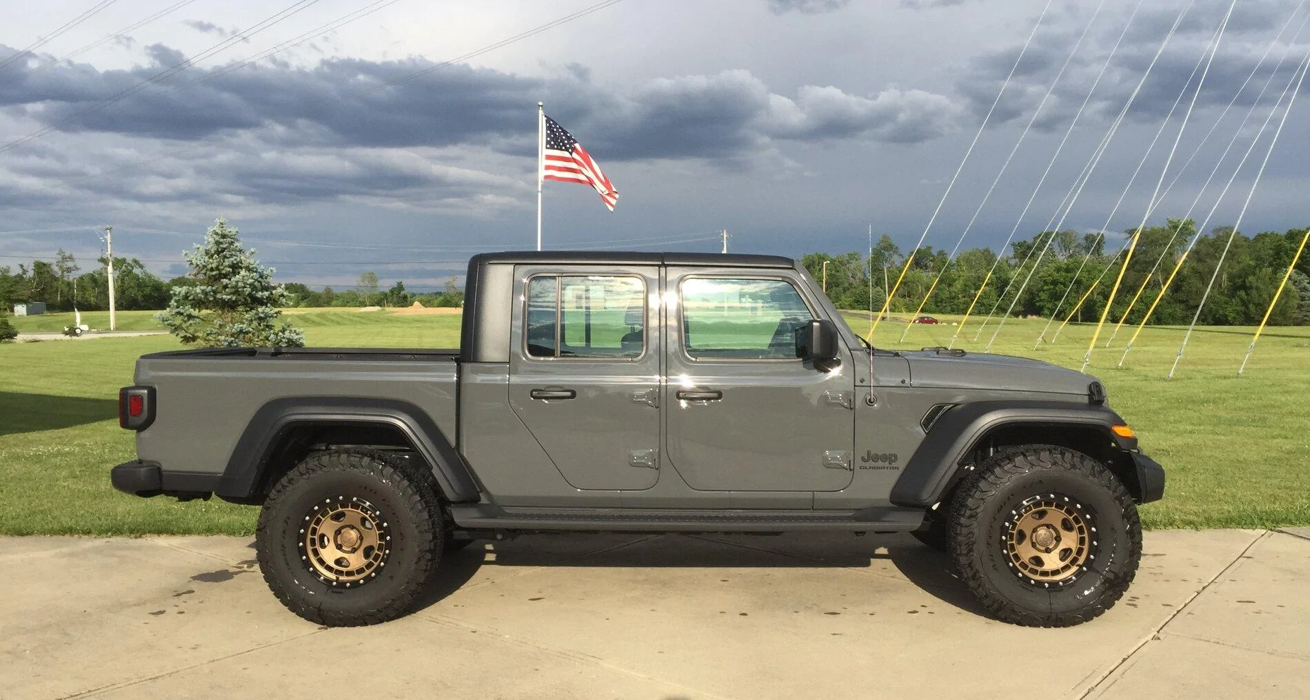

+1 for the BFG 37's. Yeah, they run a little smaller than other 37's but I've run them on all my work trucks and have never been disappointed in the 20 years doing so. Pic shows the RC 3.5" spring lift. I probably didn't need to go that high but I like the wheel gap better. Stock 4.10 gears. MPG probably 16-17. I do like to occasionally manually shift on the highway if it's windy or hilly. Second pic shows my 2020 with a retro-fit Rubicon suspension with 1.5" spacer up front and a .75" in the rear.

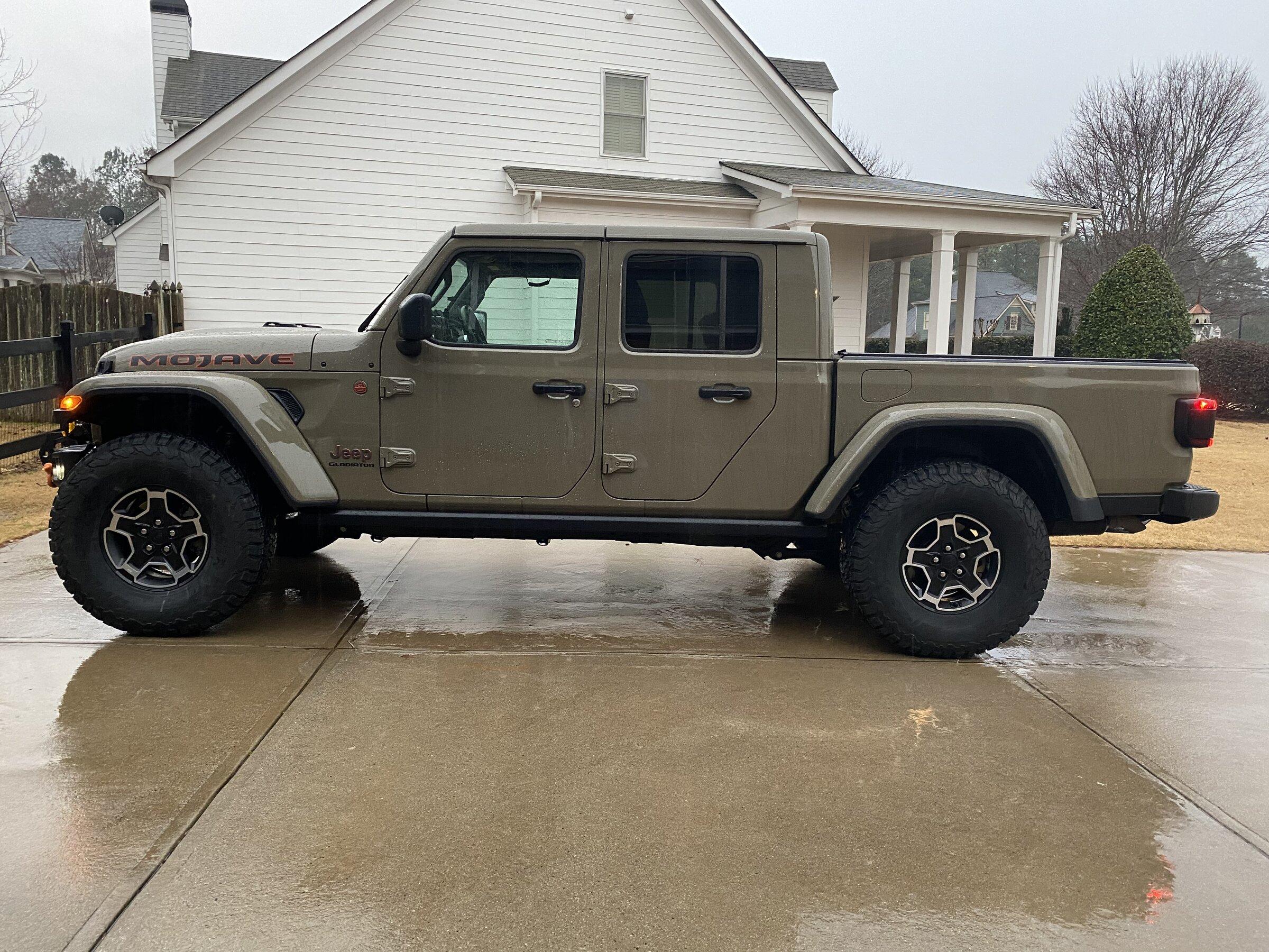

2020 Mojave
37” BFG KO2 “C”
No lift
Tazer Mini
love them!
avg mpg 17.4 combined
70-80mph highway in 8th gear around Atlanta no problem. The Jeep feels more responsive than when I had the 35x11.5 Nitto Trail Grappler.

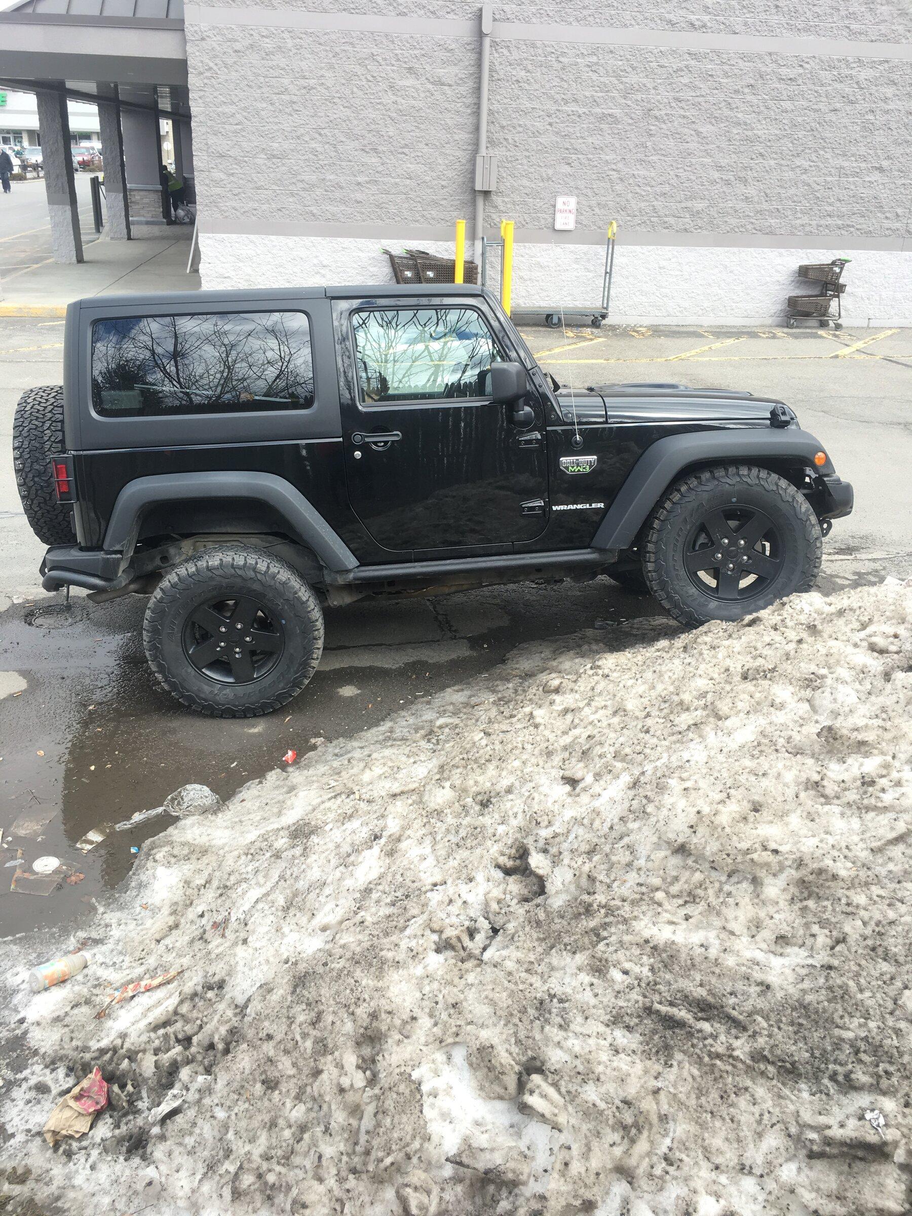

How many miles do you guys/gals have on them? I ran 285/75/17 on my Jk on a 5 tire rotation and had tons of tread left when I traded it for my JTRD with almost 55k onto em. Never had any punctures or leaks either. Been flip flopping between the 35/37 when I tire up here soon.

Any problem when it’s flexed? I currently have the 35’s on my Mojave but am thinking about the 37’s next time.
not yet, however I haven’t taken any aggressive trails. I have the AEV 2” kit in my garage pending any major rubbing. I don’t expect to have any with my style of trail riding.
