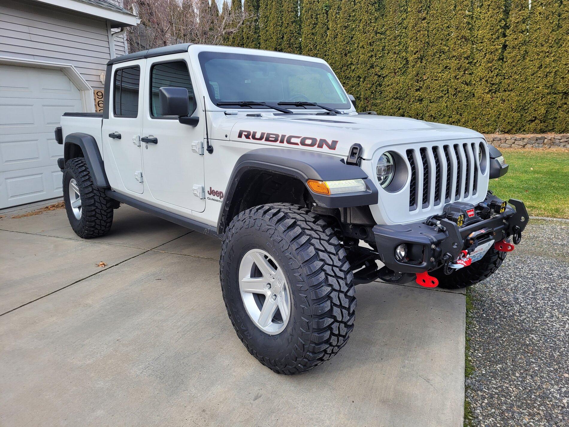

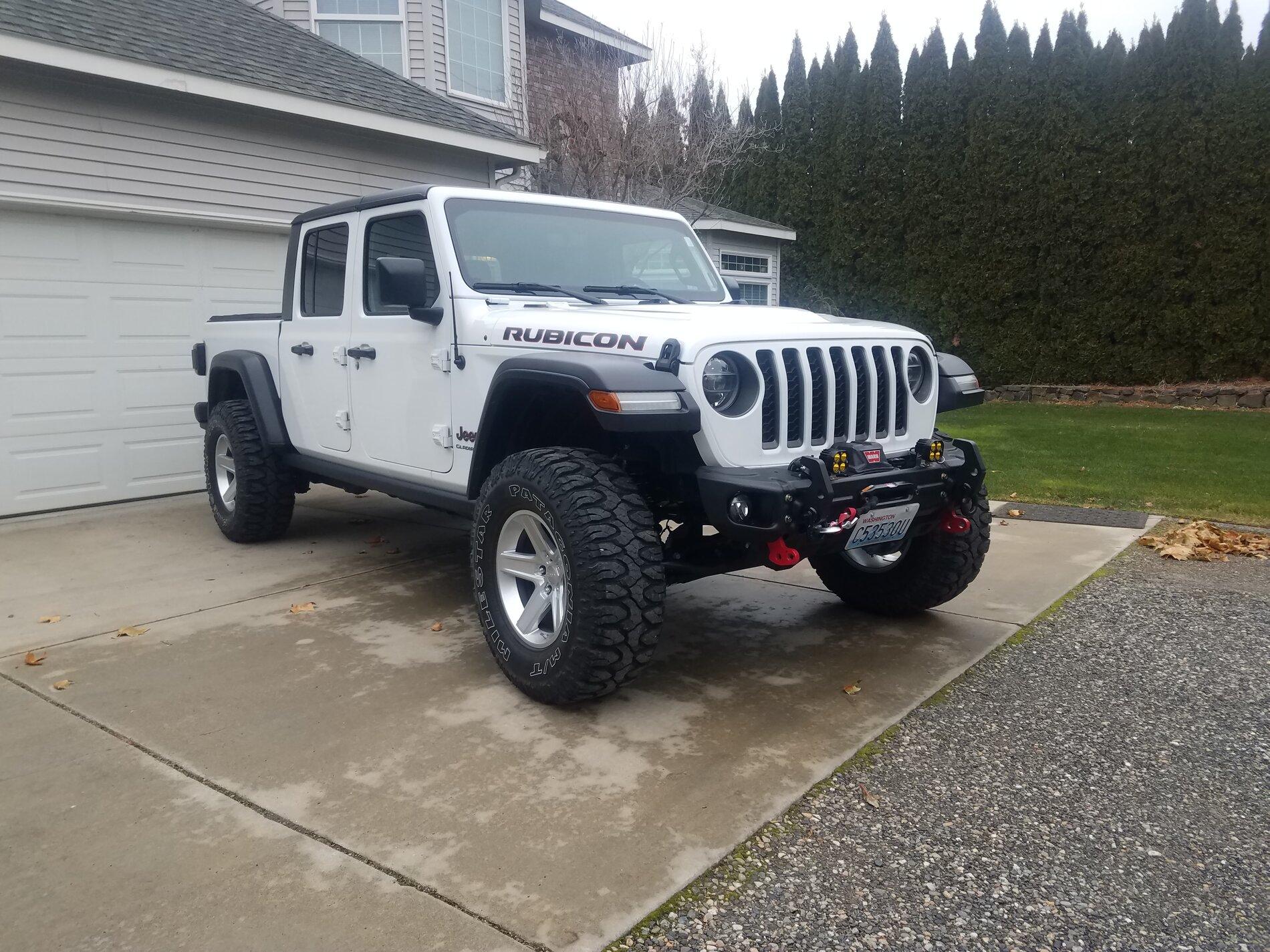

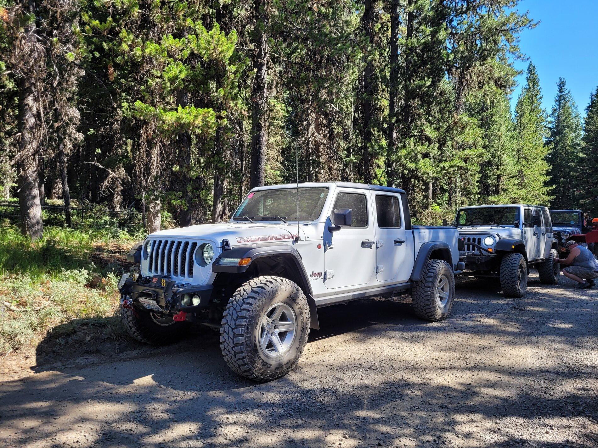

I went with 35's at 1 day old just because I had leftovers from the JK sitting at the house.
I knew I wanted 37's before I bought it. JT's just look right with 37's. My biased opinion.
Weight matters. A couple of the lightest 37" tires out there are BFG AT's and Mastercraft Courser MXT. They are lighter than a lot of 35's. I went with the MXTs.
I'm also in the "more tire, less wheel" club. Better off-road while aired down. 17's for me.

Jeep Gladiator 37s or 35s? 1st oil change 4100
37's
Jeep Gladiator 37s or 35s? jt37
Jeep Gladiator 37s or 35s? air down

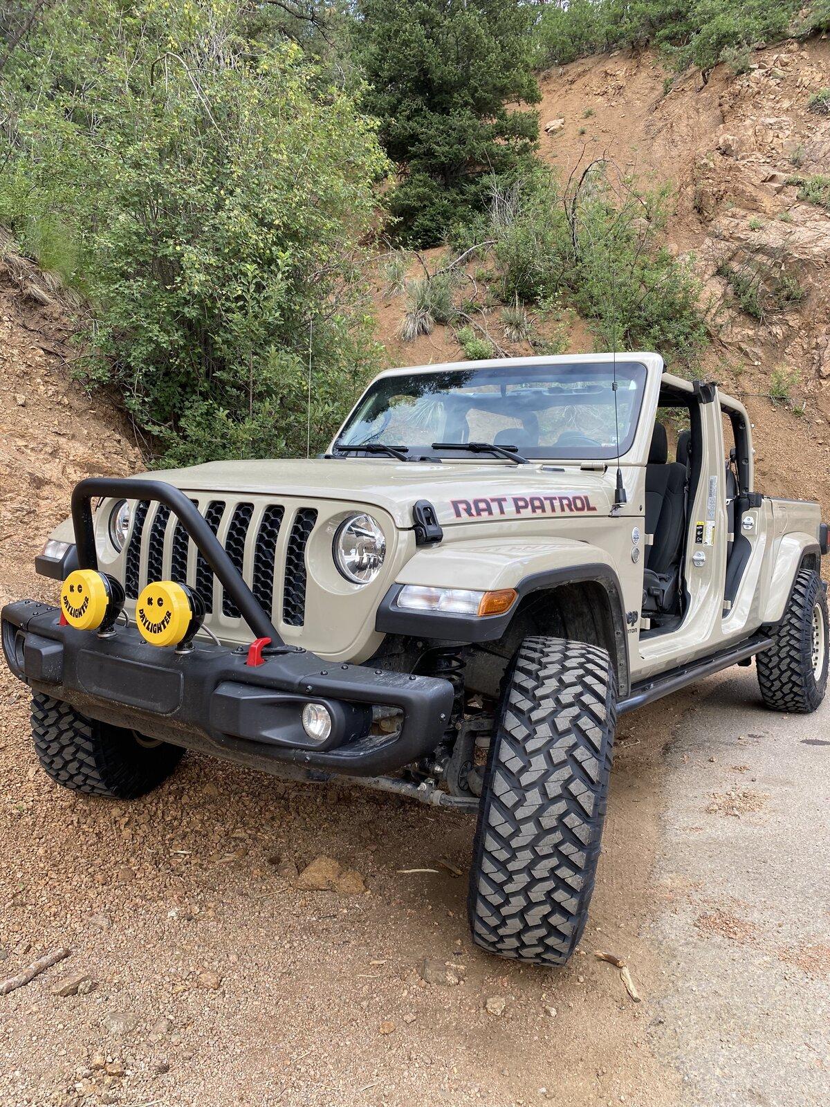

I'm seeing 16.5 with my 35s and 3.73. I keep my foot out of it. A LOT. 4.88 will be a game changer for me. I have 17s with a -18 offset. I also went 11.5x35 instead of a 12.5. At your altitude you could probably live with 3.73 and 35s.

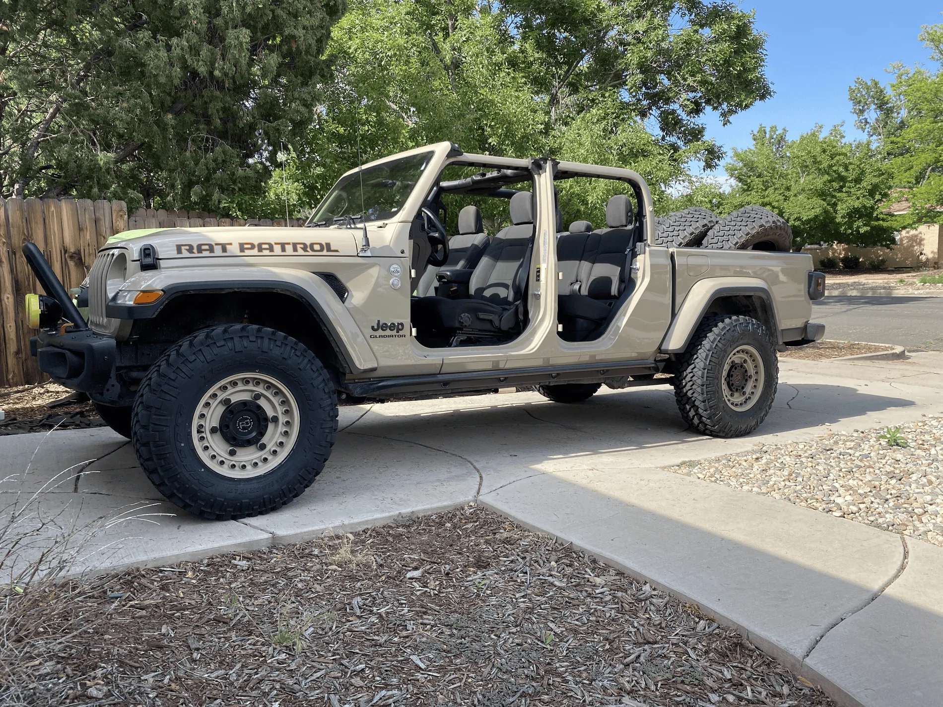

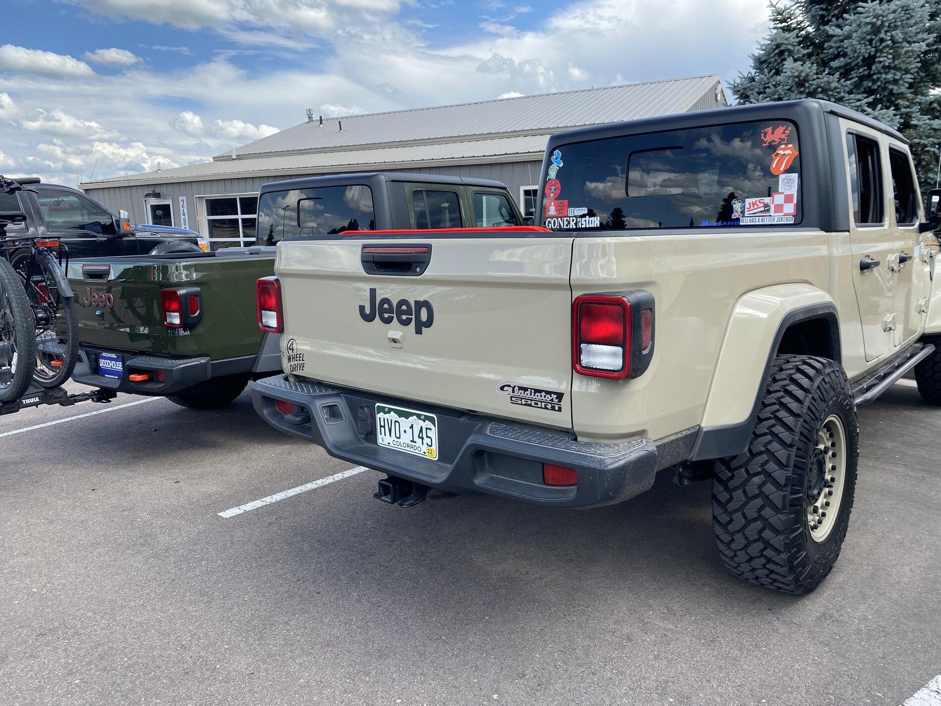

I have 37's on my Base Sports Max Tow, haven't had any issues with rubbing. Personally I wouldn't have went 20" on your wheels and would of kept a 17 or 18 and went more tire less wheel. If you have 3.73 gears and go 37 your going be averaging about 14 to 15 mpg on your gas especially with the 20's on there. Mine has about 3-1/4 inches of lift total and I'm running my stock wheels. I had 35's on mine for a year and then found some used to 37's that had about 75% life left on them for $500. I figured I'd do that and make sure that's what I wanted before I spent the money on a new set. If your set on 37's your probably not going to be happy with 35's but be prepared for the performance hit once you go to 37's, it's going to be a dog with 3.73 gears. Pictures of mine for reference
On 35's
On 37's
I was getting around 18.7 average MPGs on the 35's and I'm getting around 17.2 average MPGs on the 37's. Keep in mind I have 4.10 gears as well. Your going to get less with either size with 3.73 gears.
As far as upgrading ball joints or anything like that, I ran 37's and 35's on my JKU with the stock ball joints and I got 121,000 miles out of them before I needed to change them out. Probably 40,000 miles of that was on 37's and the rest on 35's. I'll keep my stock ones on the jeep and see what happens with the JT but I've been told they are stouter than the JKs were. If I get 100,000+ out of these I'll put stock ones back on when they were out.

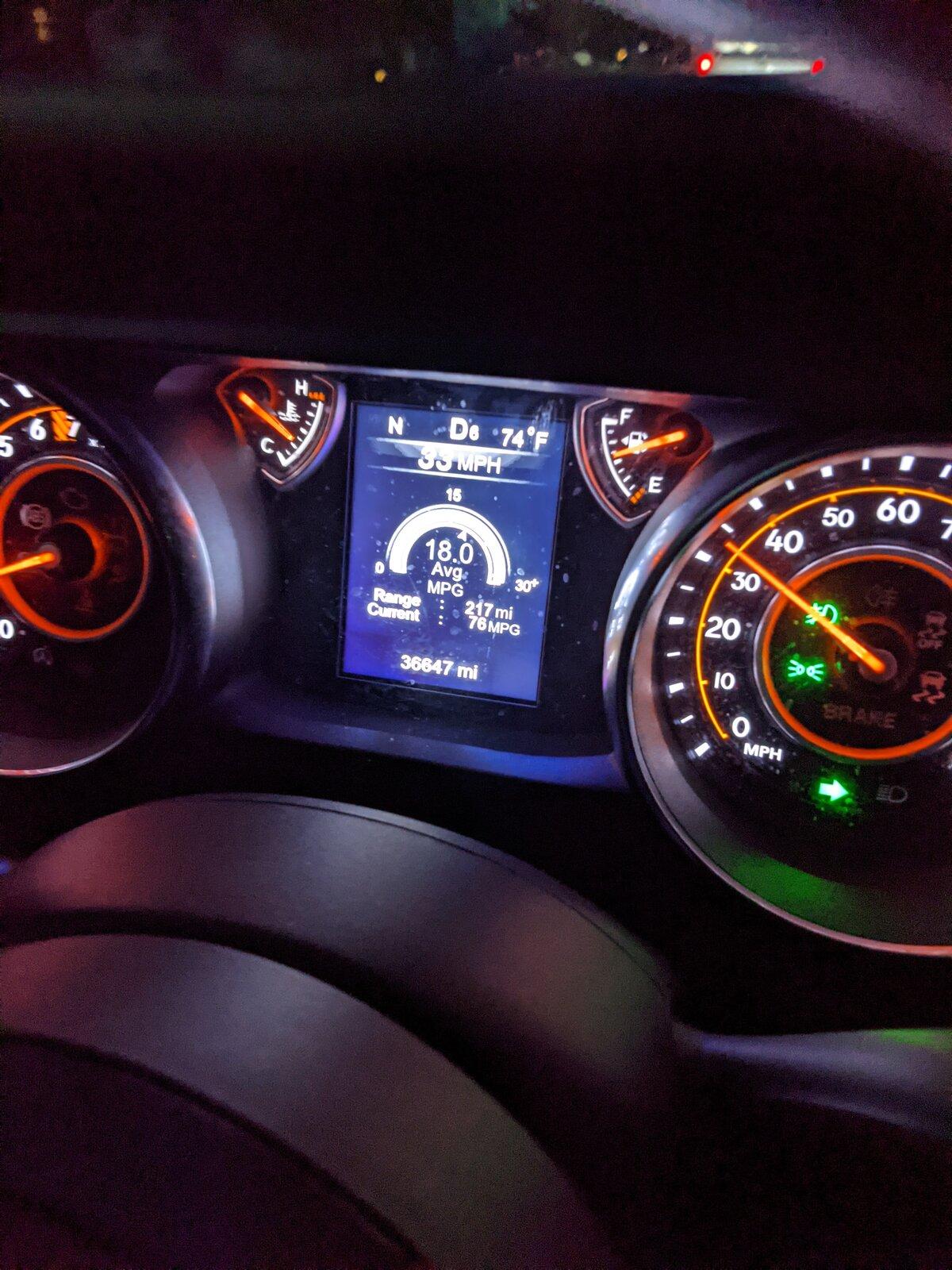

It all depends on which 37's you go with. The heavier the worse MPGs your going to get. Max Tow gets 17.2 to 17.5 MPGs on 37 12.5 17 Kanati trail hogs and did the same on Goodyear MTRs in the same size. Both tires weigh 72lbs and 73lbs. We got 18.1 on our trip to the beach 2 weeks ago. That's good enough for me. Speedo is dead on in the video and I live a hour and half from the Smokey Mountains so it's rolling hills here. Haven't reset the speedo since I put the Goodyear's on in Feb.
