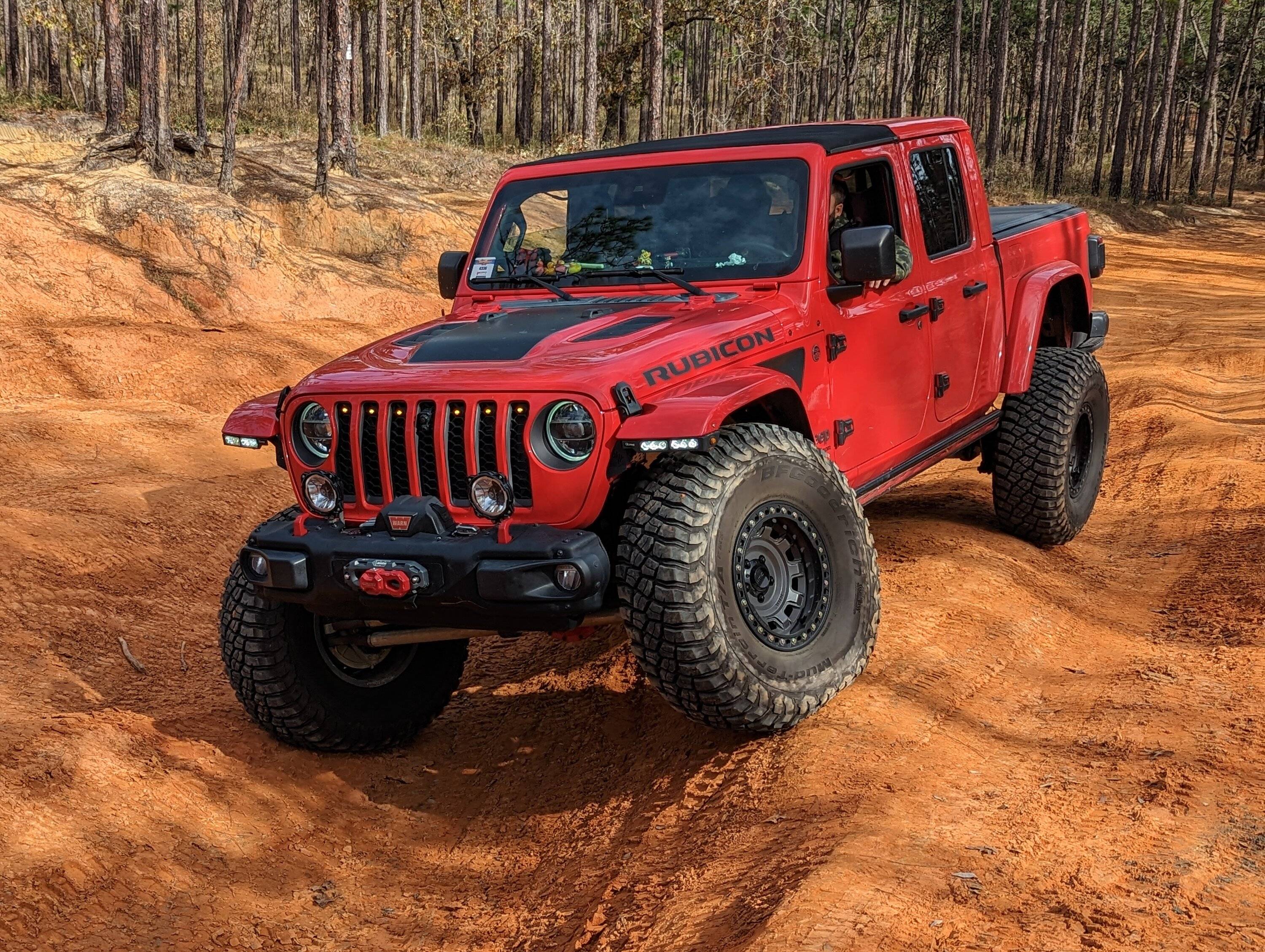

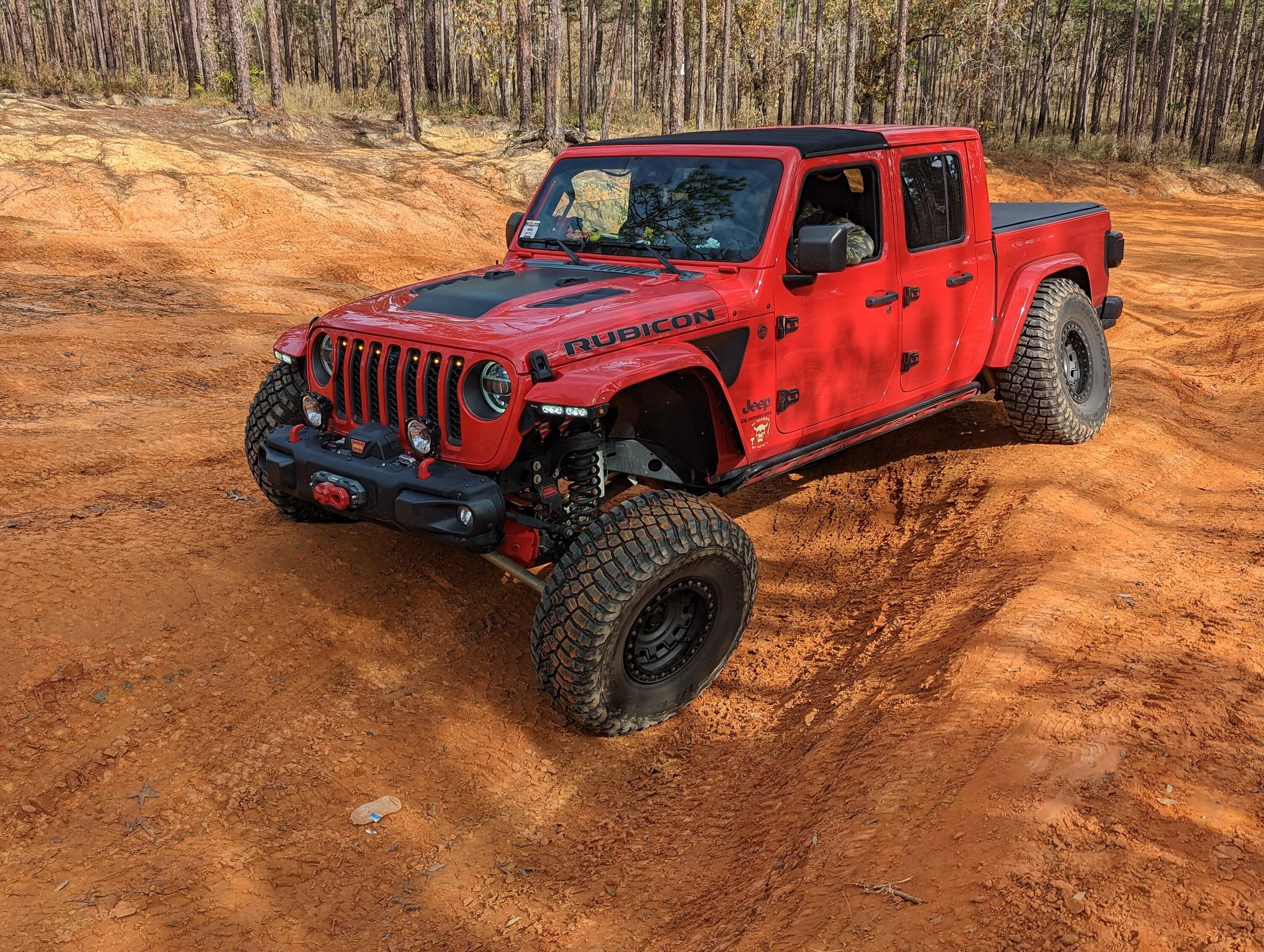

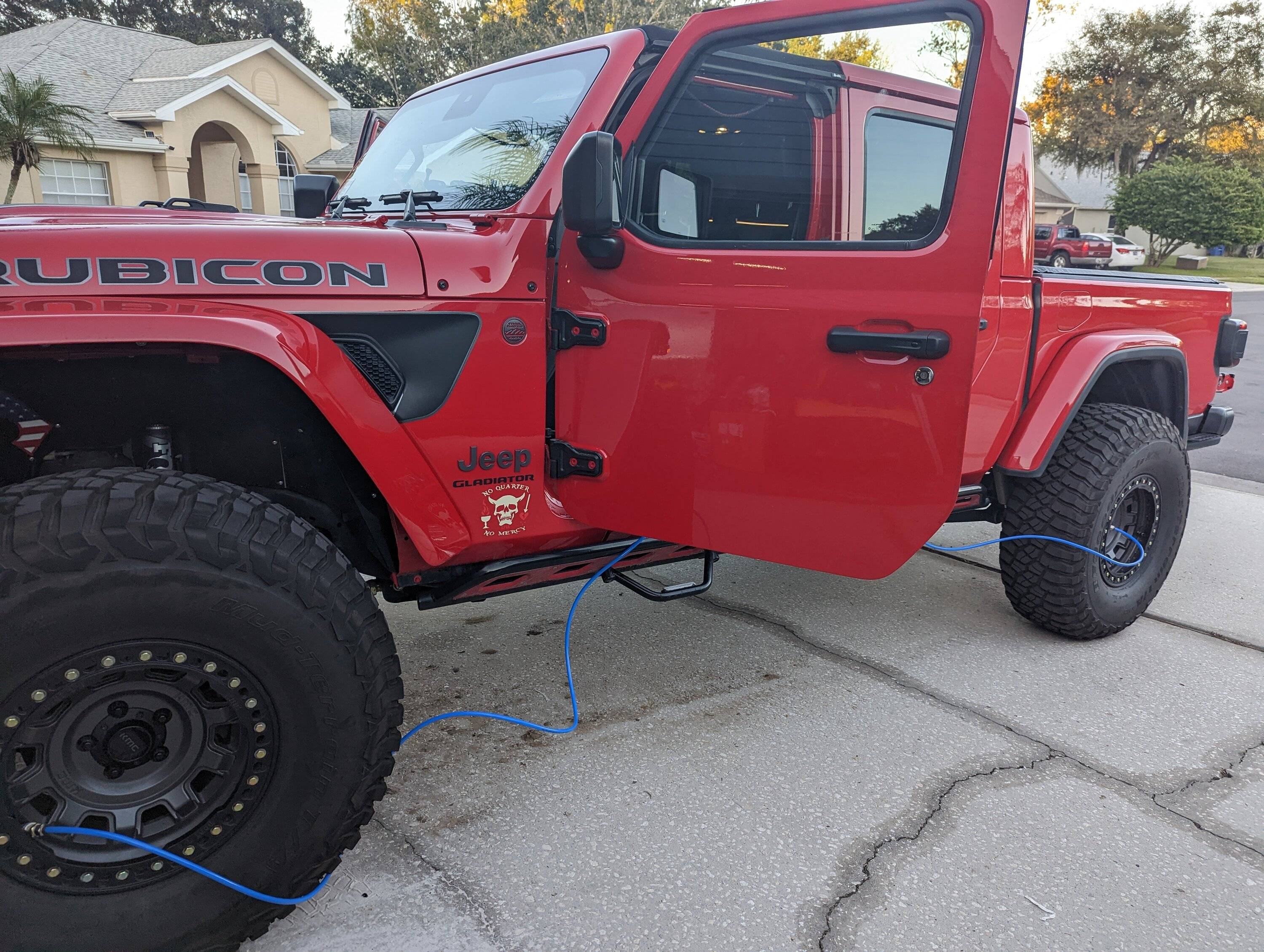

I went km3s in 39s on a Clayton 2.5 with split fenders and kmc beadlocks 17x9 -15mm offset for 15k miles or so now. 2 inches of bump stop should probably be 2.5 though upfront and the rears don't rub even fully flexed with one hanging.
Jeep Gladiator Anyone with the BFG KO2 39x13.5r17? PXL_20221226_181726984
Jeep Gladiator Anyone with the BFG KO2 39x13.5r17? PXL_20221022_222700277
Jeep Gladiator Anyone with the BFG KO2 39x13.5r17? PXL_20221226_181743792

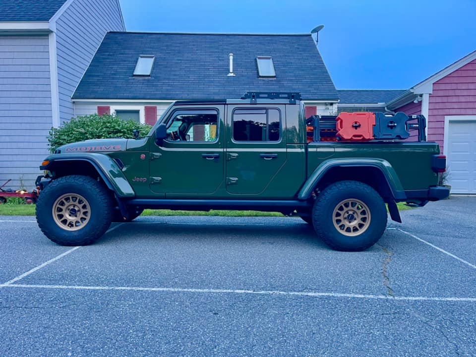

So I'm really diggin these K02s and I'm currently running 37x12.5r17 in load range C for a nice tuck. But after a recent 2" AEV spacer lift the tuck got a little better which leaves me with some room to go out a bit. In looking at these pictures of all of yours I'm thinking that I could actually run these 39s without any change in lift. And if at all needed, could always split the fenders to gain back the room.
I'm not in any rush because I do love my current setup but looking at the side profile here with my 37" KO2s, it shows these 39s could be possible.
For sure- this is because your 37’s measure out more like a 35-35.5ā€ tire….. and the 39’s run like a 37.5ā€ tire…. These tires run on the super low side for their sidewall measurement.
I love the Ko2 for its weight and it’s long life… but- for the $$(unless things have seriously changed- $650~ a tire right?) and the size? Id go a different rout.
Falken wildpeak Rt/ Nitto ridge grappler, dare I say a Patagonia mt 02 ? all $100+ less per tire and availability is way better.

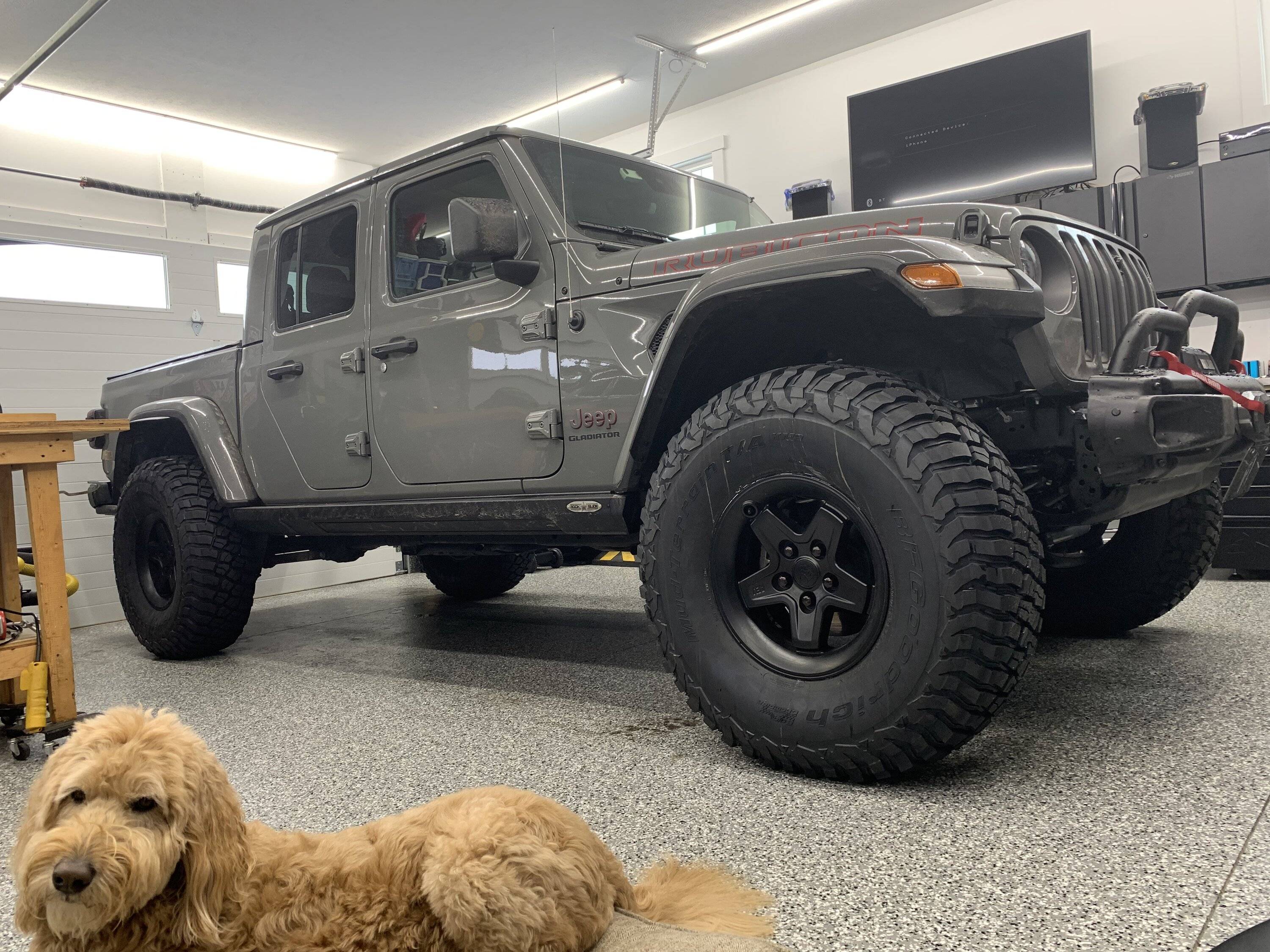

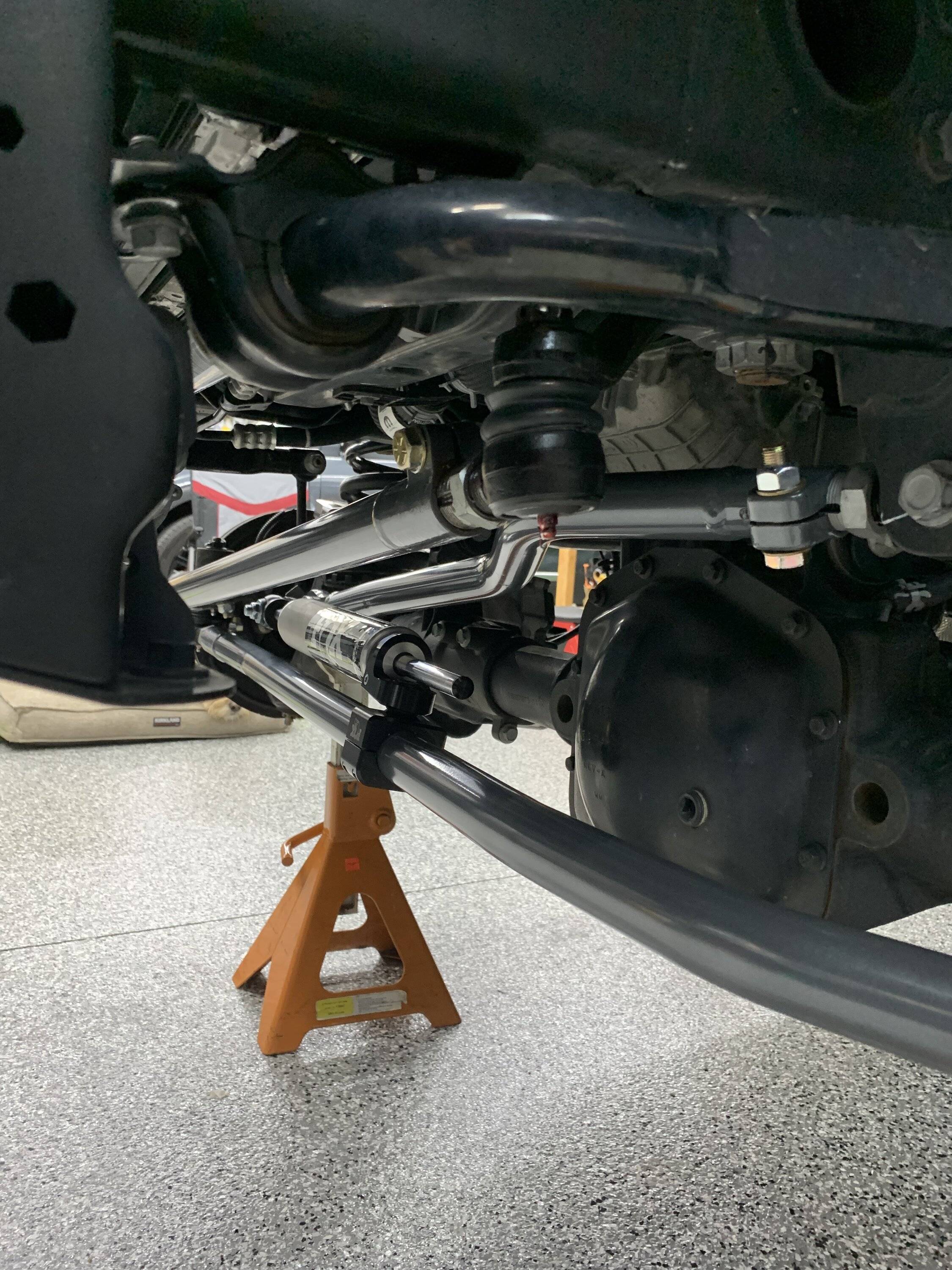

I’m considering a tire size bump and curious if anyone has experience with the BF Goodrich KO2 tire in the 39x13.5r17 size. I’m currently running their 37 and wish it measured a true 37 and want to get something a little bigger. I’m running 5.13 gears and wondered if I’d need to upgrade any driveline components for the larger tires. Also, on BFG’s website it says the 37 and the 39 are the exact same weight. Could this be a typo? If anyone has this size tire I’d love to hear about your set up, opinion, and pictures.
I’m running the KM3’s in 39x13.5x17 on the factory 2ā€ lift with 1.5 leveling kit. Great ride and averaging 20.4 MPG. I have the diesel and have not re geared from 373’s. I still see 8th gear above 57mph. Caulk tested fronts at 30psi and rears at 28.
Im sure at full articulation that I would get some front rub at full turn. Upgraded front track, tie Rod and drag link bars and upgraded Fox stabilizer. Have been running them for 10k miles and getting ready to turn 30k on truck. No ball joint issues at this time. I wanted the KO2’s but we’re back ordered so long but didn’t want to wait.
