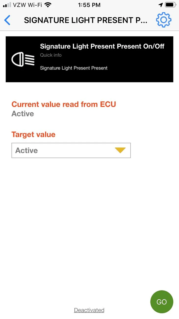

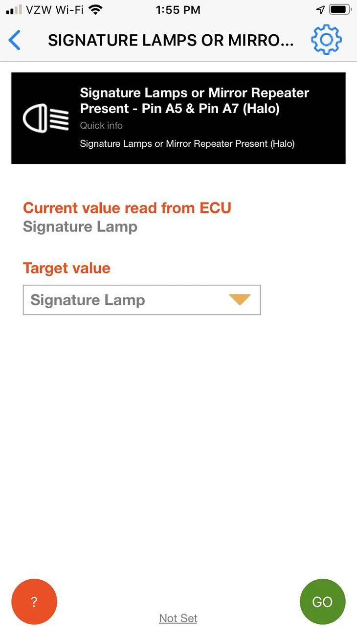

Your HALO's are acting as your DRL's. You can go into JScan or similar and disable the DRL being active. Can also play with the signature lamp/light settings.
Jeep Gladiator Anyway to deactivate just the halo on the headlights? IMG_8836
Jeep Gladiator Anyway to deactivate just the halo on the headlights? IMG_8837

Just FYI to those suggesting turning off DRL, I have those turned off via the settings screen on the radio display. My DRL only turn on when I flip the headlights on.
Anytime the engine is running my halos are lit.
Now that yall mention using a Jscan (I don't have one) reminded me that I might be able to do this using AlphaObd (which I do have the paid version) so I can look around on that and see if there is a setting I can change.
I bought AlphaObd only so I could do forced regens if needed (have done that once just to make I could). Im a little nervous about doing much with the AlphaObd because you can really screw things up if you don't know what your doing.
