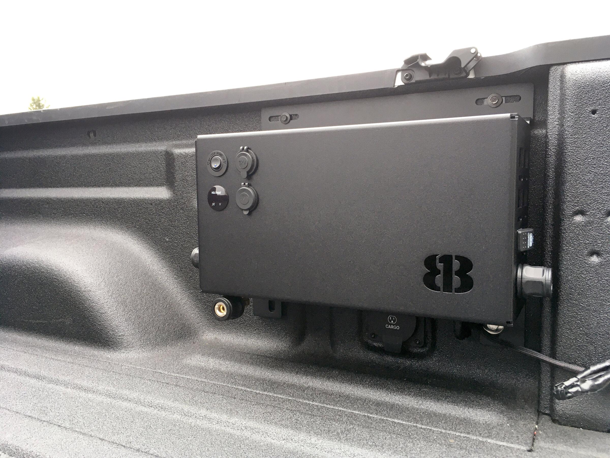

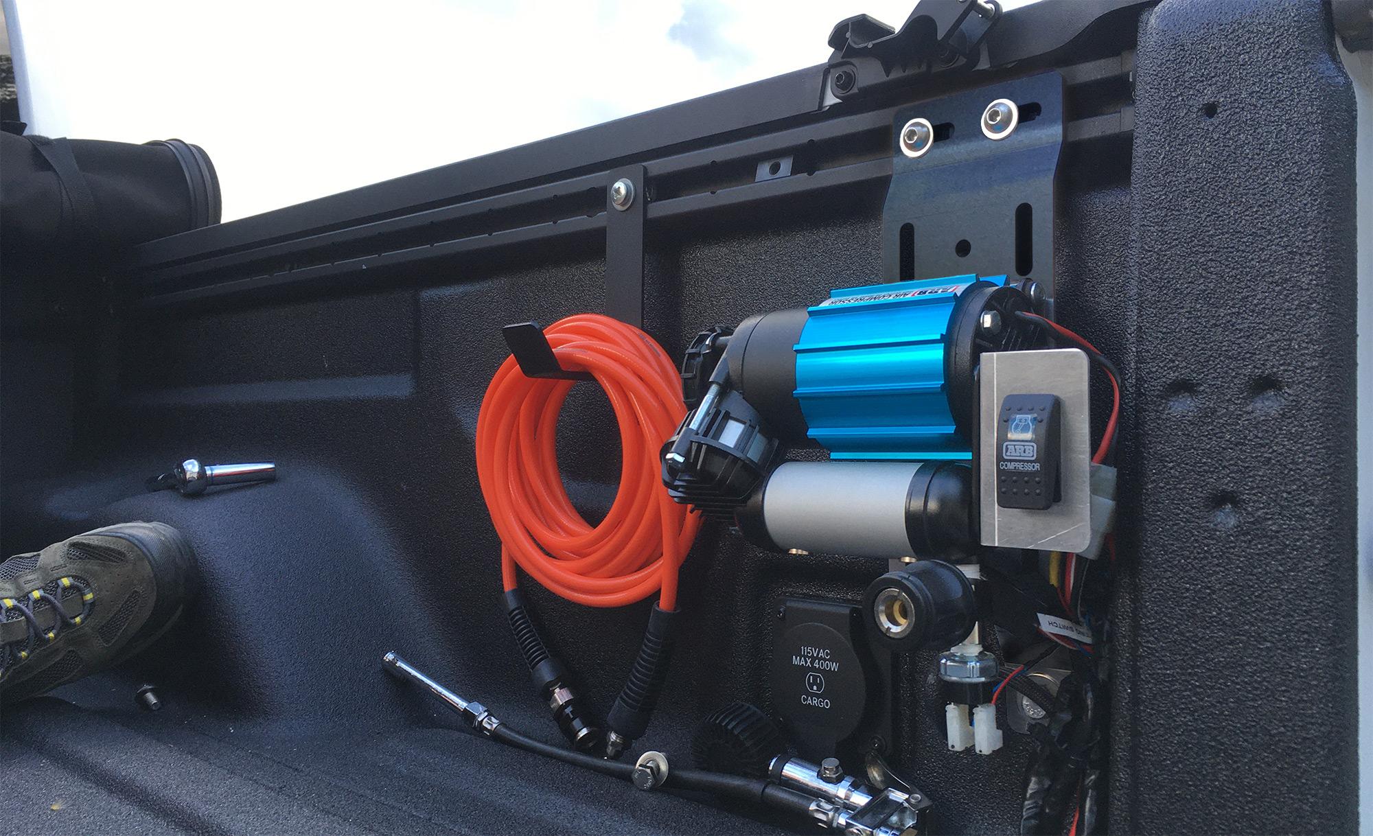

I started to use the big 813 Fab box mount. Didn’t like how much space it took up and how it limited my cargo rail options. I’ll have it for sale soon at a discount if anyone is interested…

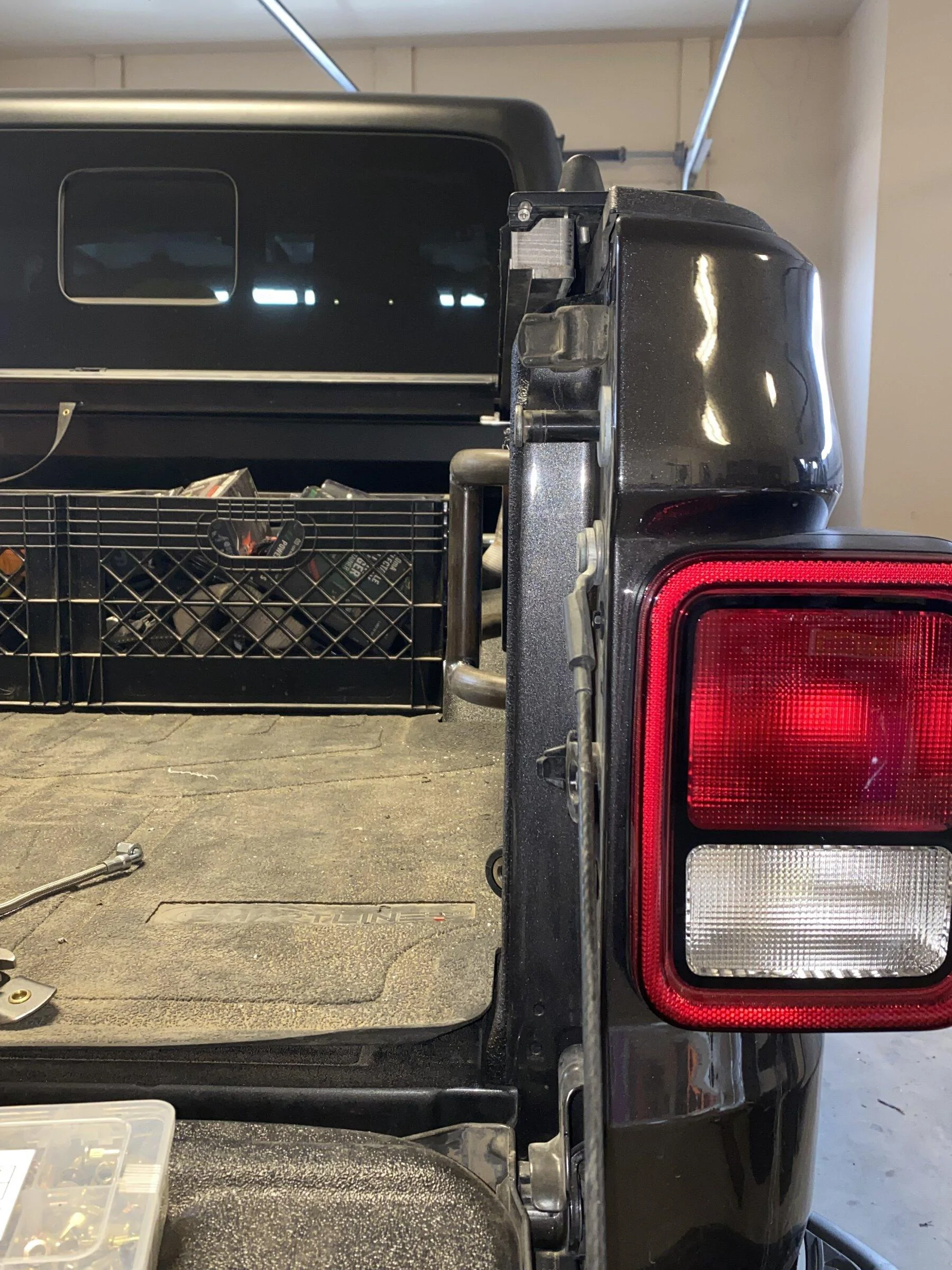

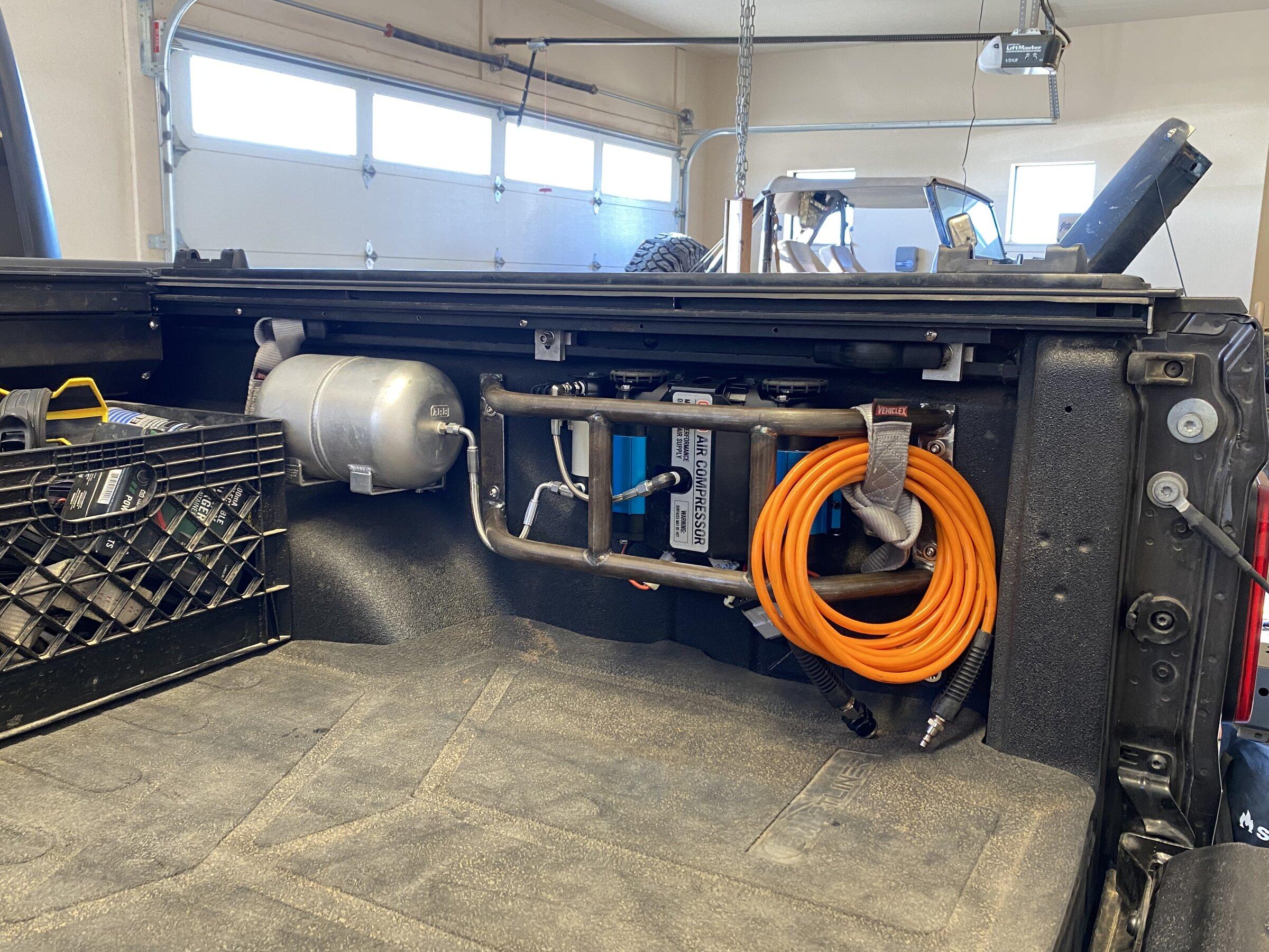

Get a nutsert tool and use your imagination. I ended up fabbing this up instead.
That's pretty slick! Did you buy the medium enclosure that has to mount in the trail rail? The large enclosure mounts under the rail so just wondering.

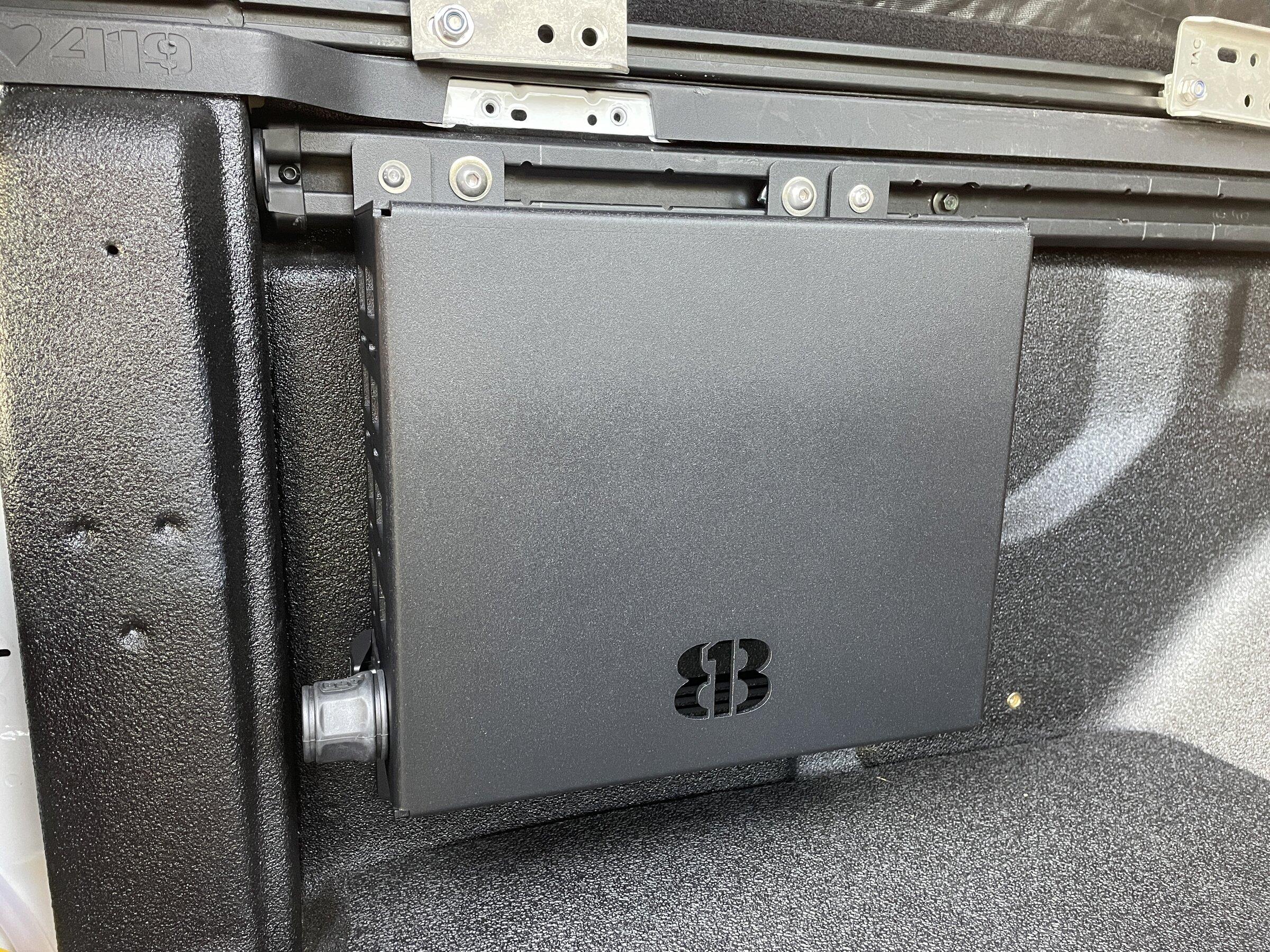

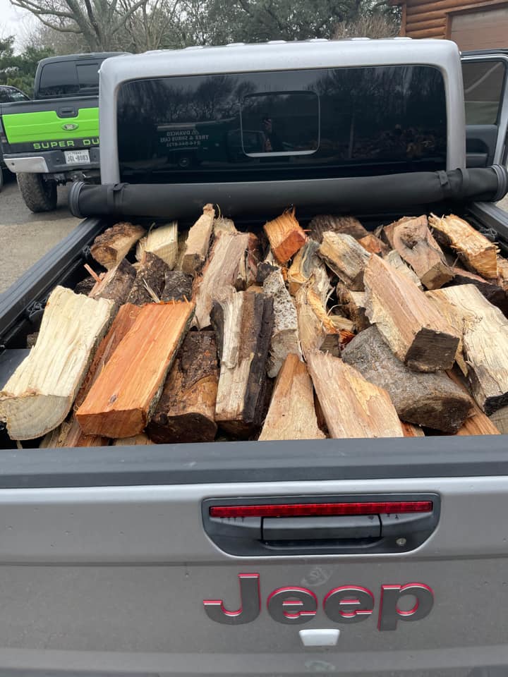

@813 Fabrication & Design, do you have the specs on your medium enclosure? How far does it stick out? Would I still be able to fit a 4x8 sheet in the bed with this installed? Trying to find a solution that still allows me that option without doing damage to the compressor/enclosure or without having to remove the compressor every time I need to get wood or metal. Maybe this under the bed idea is a good solution, just takes a little more work.

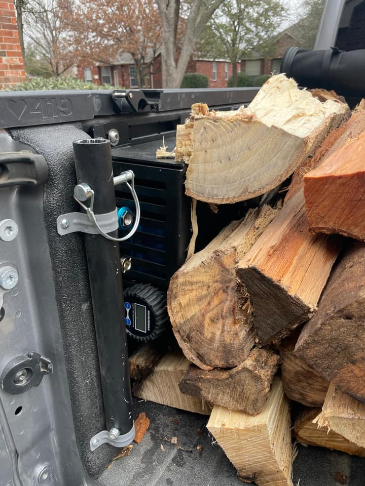

Hey, the enclosure sits in closer to the bed wall than the opening of the tailgate so you should be able to still carry items that are as wide as the tailgate opening. As far as hauling wood and items in the bed, these photos should help answer your concerns :)
