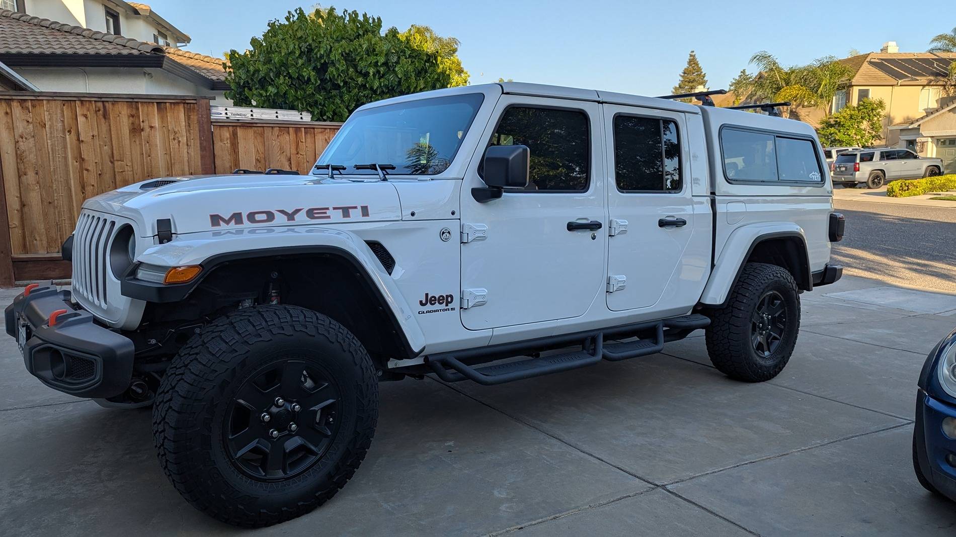

  • Trail Rail clamps: They situated the shell on mine so the back lines up with the tailgate. This means it's also much closer to the hard top and looks good. You will see a lot of pictures of the shell installed on this forum where it's misaligned in the back, (hanging over), and after holding the installer hostage as we did a walkthrough I think I got to the bottom of why this is. If it's clamped in using the Trail Rail system there is a limit as to how far something can be inserted into the Trail Rail towards the front of the bed. There are metal plates in the shell where the clamp is supposed to clamp down on instead of contacting the fiberglass. This cannot be done properly due to the Trail Rail system limitations at the front and rear of the rail as it has notches so you can insert the tie down clamps into the rail. So, I think installers push the shell back some to allow for the clamp to contact the metal plate instead of fiberglass to secure it. My installer lined up the shell but this means my front clamps are contacting fiberglass and not the metal plates. Installer said this "should be okay". We'll see. (I've seen this misalignment complaint from others here and I think that's why the installer does this.)
  • Fit and Finish:
    • Paint match is excellent.
    • They had to add extra rubber seal/padding to the bottom of the shell to give it a slight lift off the bed sides as if they didn't it would rub on the paint along the sides of the bed. The overhang on the sides seems to be too much for the Gladiator and a couple other models of truck where this is needed to avoid damage to the paint. This must be a somewhat generic shell mold for a bunch of models otherwise they would correct this I would think?
    • Along the tailgate left and right edges of the shell there is not a clean finish. There is a rough cut and fiberglass threads,(or some other material), hanging out instead of having a rubber trim edge being installed to clean it up. Lazy. I've seen this complaint from others.
    • It looks excellent and I got what I paid for.
  • Durability: Can't comment on this. Just shy of a month of ownership and it hasn't faced any off-road abuse yet. Washboord trails in the desert etc. We'll see if I have to figure out a new system to secure it after those types of scenarios happen. I'd hate to drill the bed rails to secure it with bolts so we'll see. I wonder why they don't build a lip that goes over the bed rails into the bed maybe one inch to help keep it in place, (at least side to side and dynamic forces that would push it forward into the cab).
  • Ride: The Rubicon rides mushy to begin with and this did not change the ride quality to anything worse than it is that I can tell. It also has not changed the ride height that I can tell. I did not do before/after measurements as it didn't matter, I was getting it anyway. I plan to replace the suspension at some point. I've had AEV suspensions in the past and might go that way again with the 2.5" but there's also the Mopar 2" although I'm unsure if it's the same ride quality the Rubicon already exhibits but lifted, ie. not good in my opinion. I do not like the factory Rubicon ride, it's mushy and seems to fight itself between front and rear and corners, (before and after shell was installed). I've owned many trucks and this is by far the most bizarre ride to me. However it is the first truck I've owned without rear leaf springs. Loved the AEV 3.5" lift on my JKR so I'm leaning that way.
Obligatory picture:

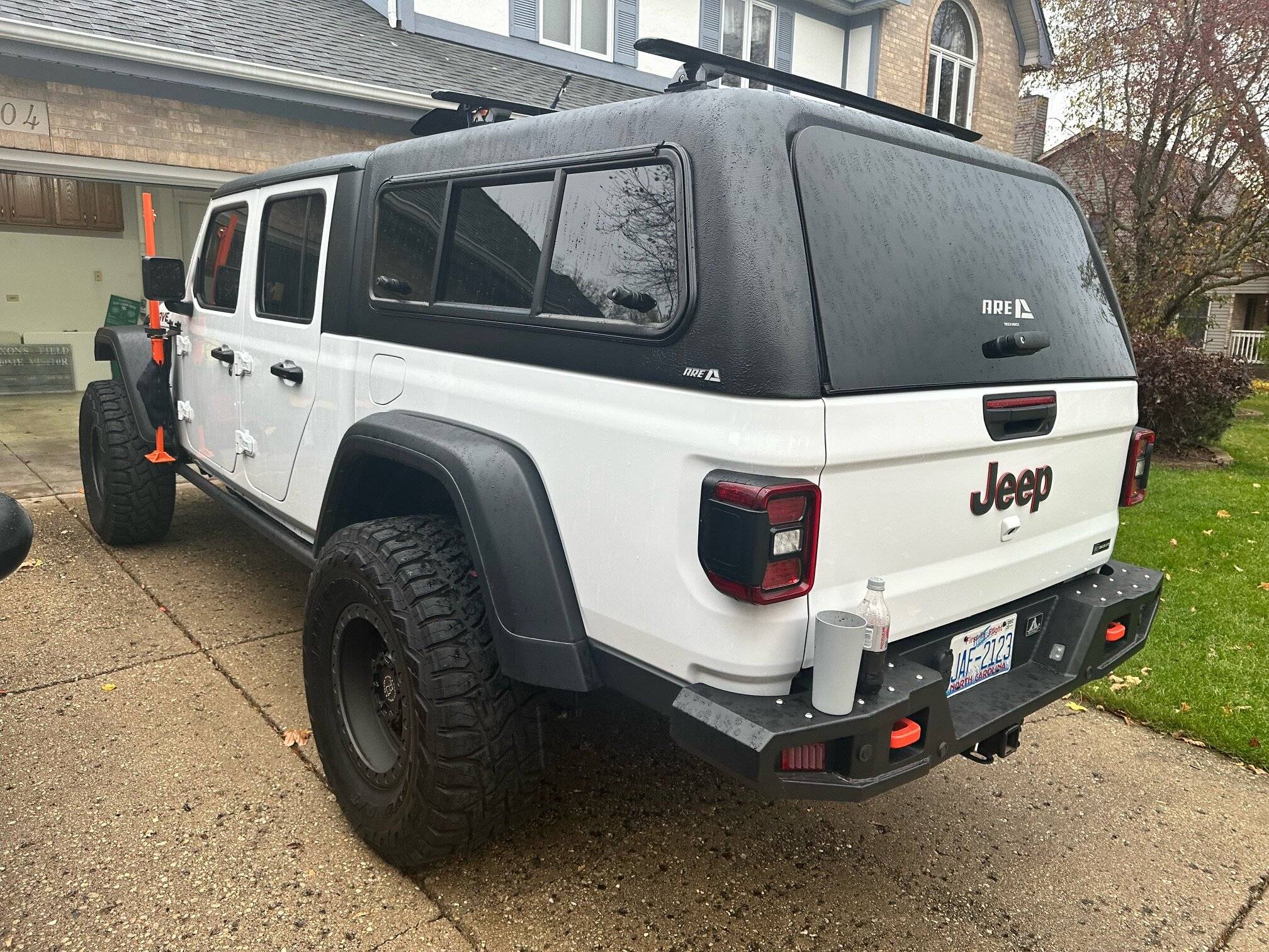

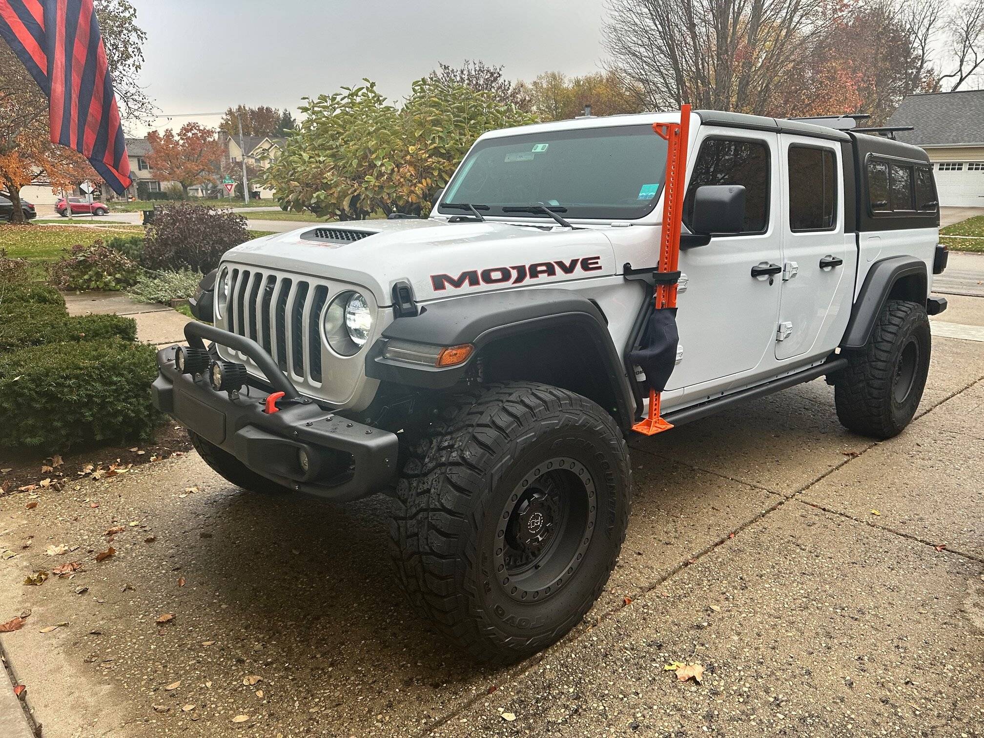

How are the lights hooked up on yours and do you have the keyless entry setup as well?
I did not option lights on the topper. I have the OEM bed lighting and hang some GoalZero crush lights from the interior clothes rod handles if I need to.
The CX Classic does not have the keyless entry setup. I think that's the CX EVO?

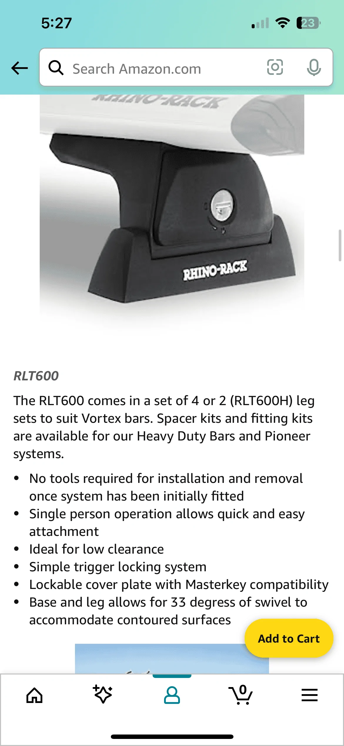

Will these work with the rails on an A.R.E CX Classic cap?
Jeep Gladiator ARE CX Classic Installed (MattK) IMG_2072
will these work with the rails on an A.R.E CX Classic cap?

This is such a great look. I just picked up a 23 Mojave, all white with white top and fenders. Going for this exact look and function to just throw the snowboards on top to keep the bed empty for naps, lunch, and gear. Nothing like keeping the cab clean :) I scanned through and was looking for the added height with the racks on (w/ out any basket). How much higher does it take it? I'm hoping to continue parking in the garage still. LMK. Appreciate all the share and info. I have a quote out on this right now, and goodness I swear I looked just a few months back and it was nearly 50% of what I'm seeing most advertised for.

Hey sorry for the late reply. I’m unsure what you’re looking for when you say “without the basket”. From the shell top to the top of the Rhino Rack is around 5” or so. There are probably lower profile legs you can use to attach a rack to the ARE but I wouldn’t know. You can find my parts list of what was used in a previous post.
Hope that helps!

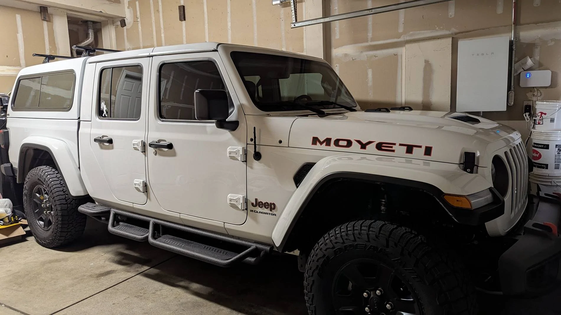

Totally forgot to update! Cap has been on since February. No issues, no change in gas mileage. Did however take some of the take out of the stance (which I didn't care for anyhow.).

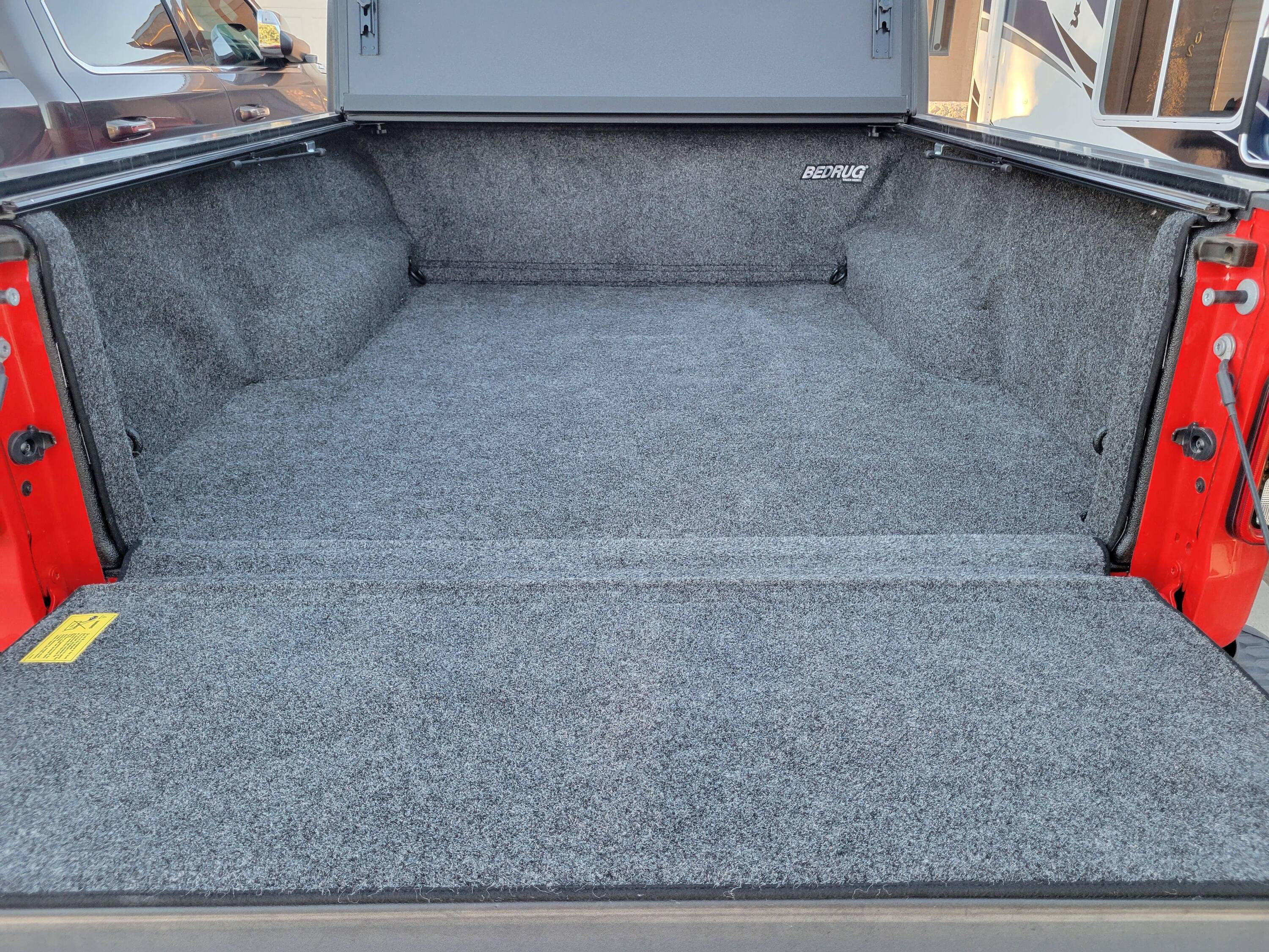

I purchased the following product from Amazon: ESI Ultimate Tailgate Seal 10'
Hope this helps someone wanting to do this. Any questions let me know!
I just put down the BedRug. My goal is to seal off some of the leaks around the tailgate. Thanks for the recommendation. I placed an order a few minutes ago.

I like the Bedrug look in the shell. I might get one once the Super Pacific is installed Thursday.
