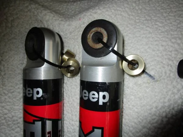

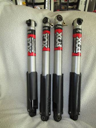

I ran the JT shocks on both my 2020 Willys and 2018 Rubicon and found they worked great for street and light off road
The only difference was the rear upper shock mount. I made bushings/ spacers to make them fit
There are shock manufactures that make one shock that fits both the JL &JT and provide bushings / spacers for the rear to fit a JL ( That's where I got the idea to run the JT jeep fox 2.0 on my JL jeeps )
I have moved on with lift kits and fox 2.5 shocks and selling the 2.0 with the rear bushings
