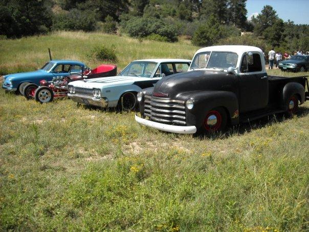

Please make sure your caster is correct. I can tell you from experience.... WAY back when I was an auto newbie... I had a 51 chevy 1/2 ton. First ever straight axle vehicle for me. I had my axle "dropped" 4". I also removed a few leaf springs and these "little wedge things." Truck drove like shit. Was all over the road like a shopping cart. They were caster shims. I now know better. Put them back in. Problem solved.
