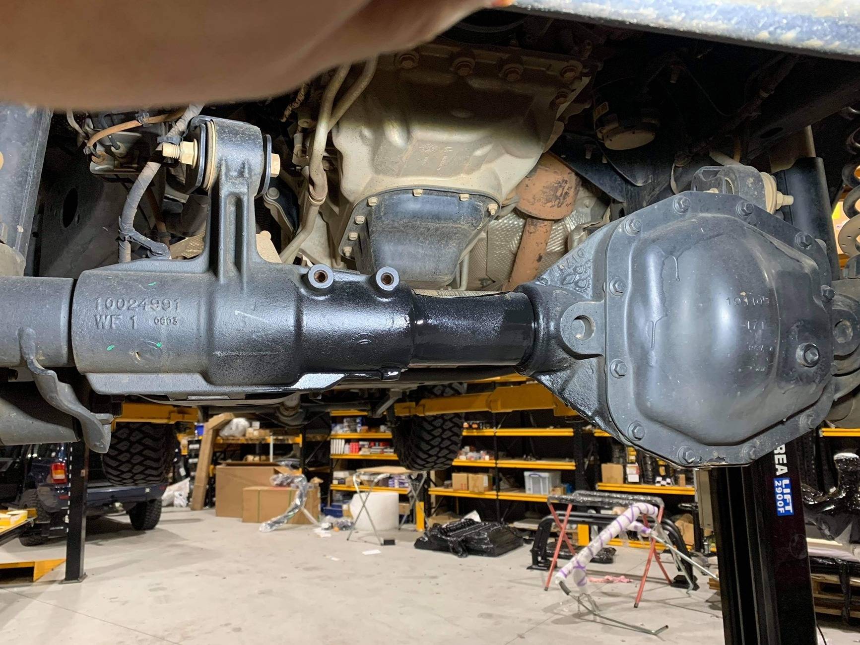

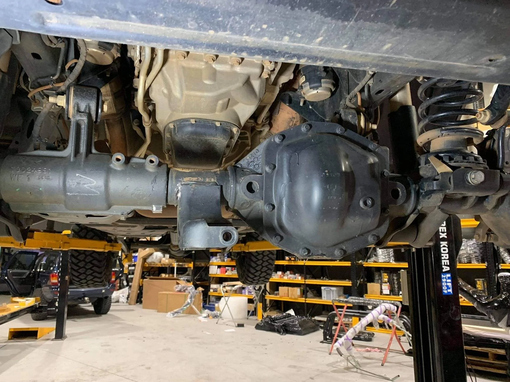

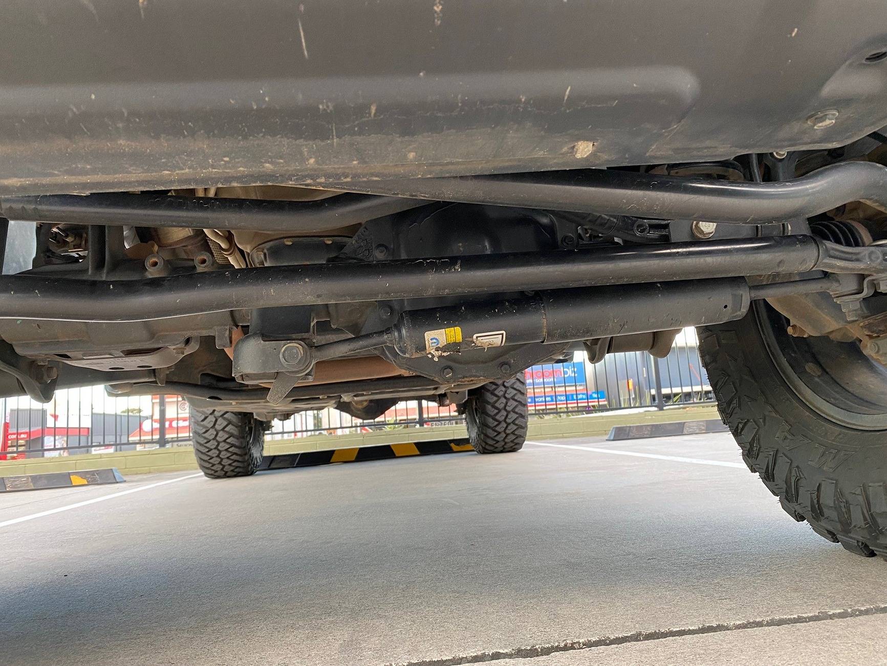

Most relocation kits will work, but make sure you get the right size tie rod clamp for whatever tie rod you are running (stock or aftermarket). I bent my stock stabiliser on my 2020 Rubicon pretty early on a medium difficulty track and relocated it shortly after that.
The kicker with the right hand drive models is that the stock set up has a massive bracket on the driver side (well, more centre, really) of the axle that hangs down even if you relocate the stabiliser above the axle. To gain full clearance you'll need to cut it off, which is a pain but can be done (just be careful to not let the axle get too hot while cutting and grinding). Pics below to show you before and after of my relocation (Teraflex kit) and bracket removal.

Thanks mate, really appreciate the info, mine has the identical dent yours had lol

There's the difference between LHD and RHD. Didn't want to speak up with not knowing.
Our's (LHD) has the axle bracket bolted to the axle, yours is welded.
With relocating the stabilizer to the tie rod bar, I don't think you would have to remove that bracket. Seems you would be high enough to clear, unless it's the relocation collar that hits.

Yes, it's definitely a different set up than the LHD trucks. While the bracket doesn't sit lower than the differential, it does seem to be located at a point where there have been axle tube failures, so my preference was to get rid of it so it wouldn't catch rocks and transmit a direct hit to the axle.
It is a pain to remove, but I do hit trails with a fair number of rocks so decided that it was worth the effort. I know some others over here who haven't bothered to cut it off, so it's not absolutely necessary to remove.
