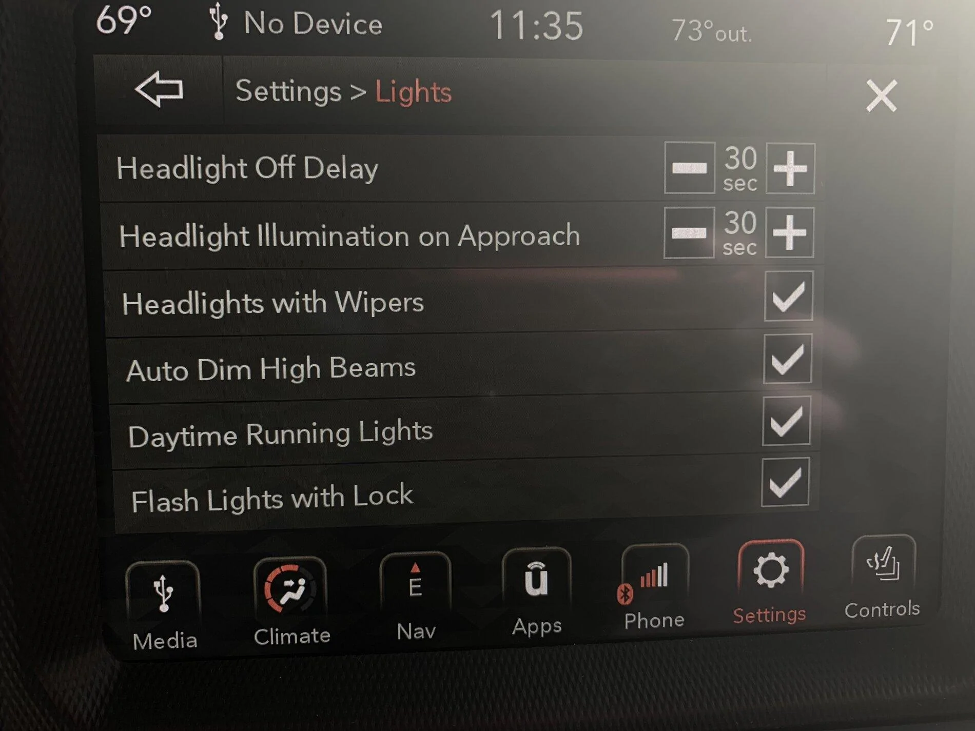

Here it is! “Auto Dim High Beams”

It's not as simple as enabling things otherwise I'd have mine with auto dim headlamps already. There's obviously something else missing, something in those that have it vs. those that do not. It's not a setting. I've been all through everything I could find related to the auto dim headlamps - nothing.
Think about this, too - if it was always as simple as a setting, Jeep could never sell such things as people would never buy anything you can later flip a switch and have. Why would any here pay $100, $200, or even $300 for anything they could later program in?
Funny thing - this has been hashed over for how long and so far, no one has made it work simply by changing settings. That should be a clue.
Not sure if you were replying to me... but I posted the page from the manual. I was trying to find a way to disable it because it is honestly not worth it. It doesn't work like it should - at least not on my truck. The requirement is the front facing camera according to the manual.
Any who, got it disabled so I can quit randomly flashing my high beams for no reason whatsoever!

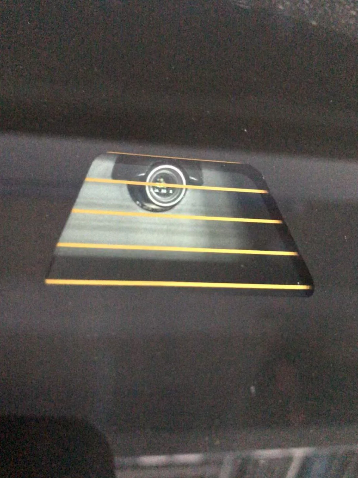

Anyone that has the auto-dim high beam care to take a picture of what is behind the windshield for the ACC/FCW? Maybe there was a change in hardware? Mine was built in 11/19, I have ACC/FCW and do not have the option. I also have the trail cam but I doubt that is part of this system as it points down.
Here is a photo of mine:

Not to resurrect an old thread, but for anyone that might be reading this moving forward, the front facing (trail camera) is not a requirement. Mine has no trail cam, but has auto high beams. If you have it it'll be on your build sheet. If you don't, it won't. The camera that is required is part of the ACC and FCW system (the one behind the mirror), not the trail cam as some here have said.

Yes, like mentioned on other pages, and as shown in a photo on this page, it's the SAME camera used for the ACC and forward collision warning, above the mirror inside.
