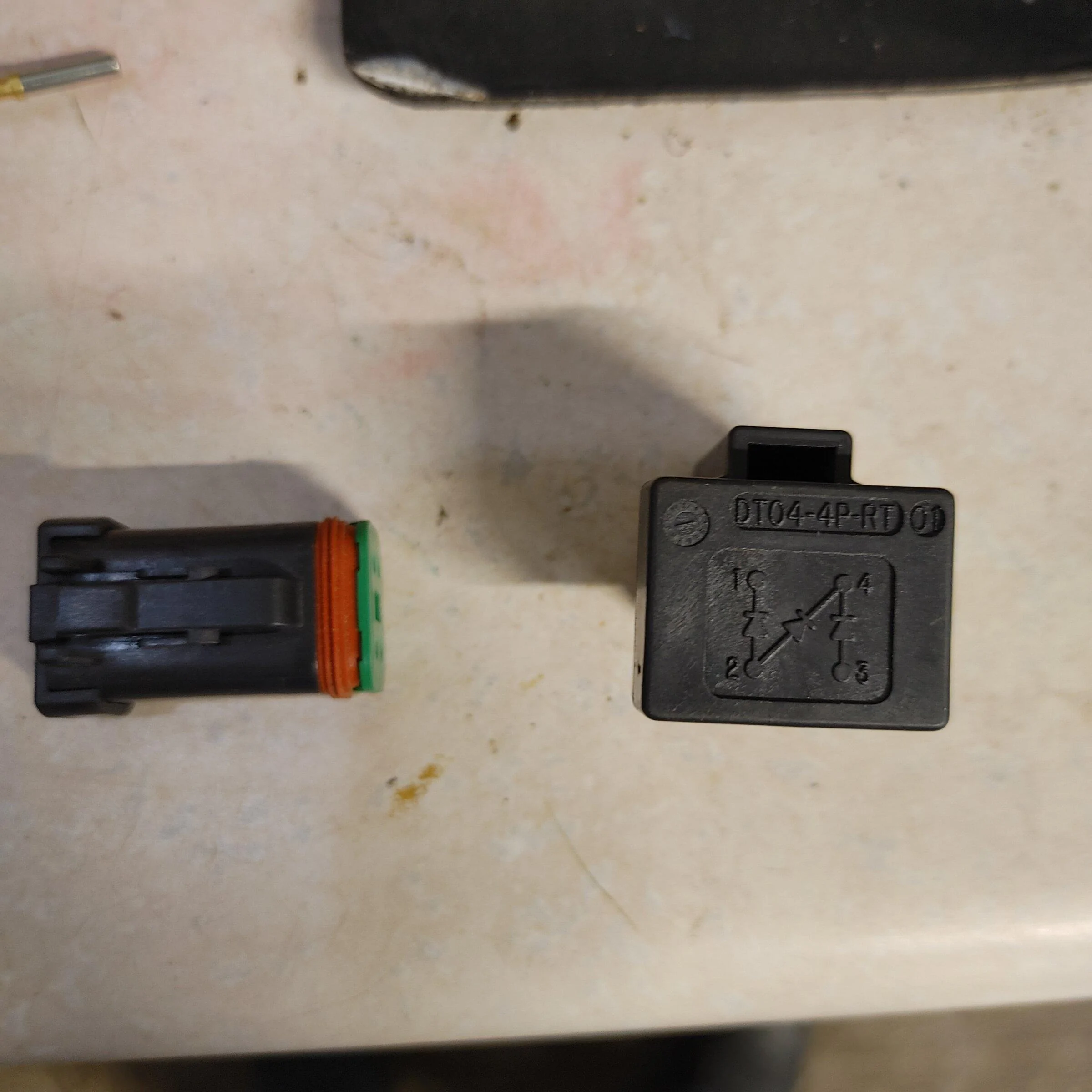

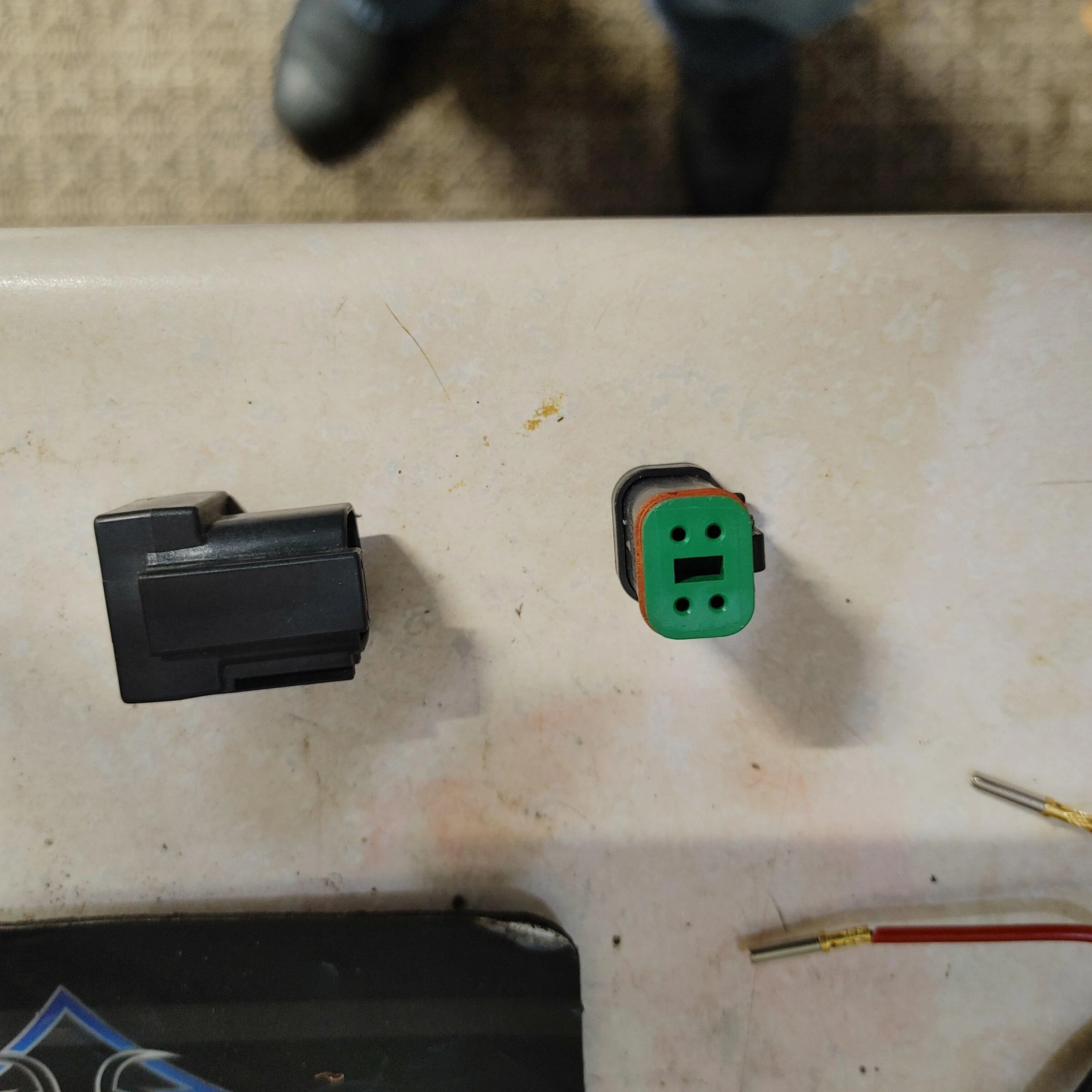

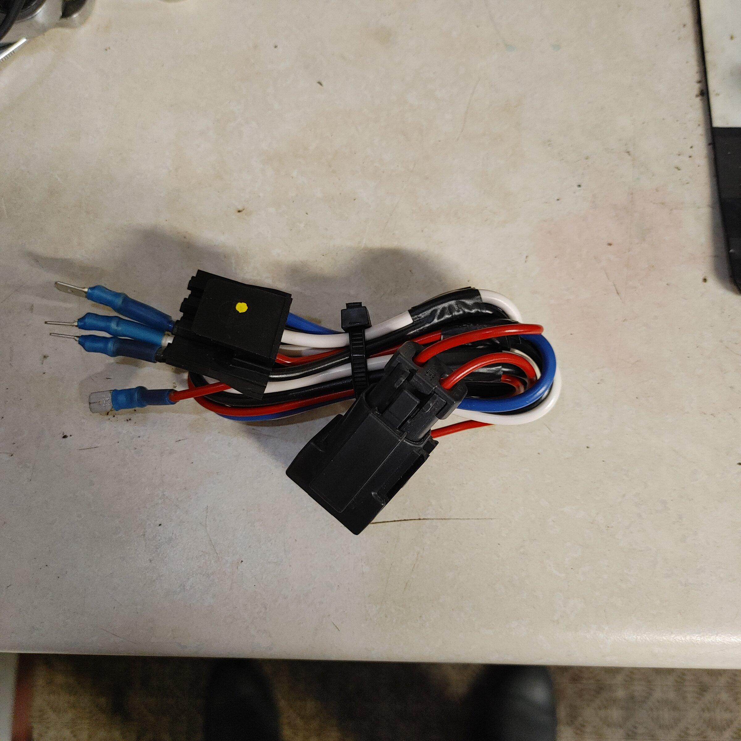

So reviving this thread a bit. I have had the insight brake controller since I first purchased my Gladiator. It has worked flawless, no codes, great brakes, I was like what is all the fuss. Fast forward to tonite. I rewired my trailer because the hacked up factory wiring made me wanna cry when I looked at it. Feeling all good about my sealed and soldered connections with kevlar wire loom, I jumped in the truck ran all the lights, and hot the brakes. All seemed good. Then I slid the manial slider to see how much brake force I could get. All the sudden, the traction control light and the avengers light comes on. I spent hours tracing grounds taking apart brakes, inspected the old harness. It had a broken ground wire and aux wire. I tried this and everything works except my brakeaway won't charge and I am grounding through the hitch.
So I start searching for ideas and low and behold my favorite forum pops up. Well know I have a bit of an issue. Do I risk taking it to the dealer for the ABS flash, or do I try the diode fix? For those of you that know me my truck is pretty far from stock, especially on the electronics side. What really tweaks my nogen is how well it worked miswired. Given if I ever had a breakaway that would of been interesting. Also I am really surprised how well it grounded through the hitch. Not sure what is causing the feedback when it is done right. I do notice my controller reads brake padal percent on its little screen.

The issue we faced with the brake controller causing the cluster errors, ABS and such to freak out was that the brake controller puts a signal or voltage on the brake light line. Since the ABS doesn't see you pressing the brake pedal, it sees the signal on the brake light circuit as a problem and disables things causing the lights on the cluster.
The flash tells the ABS to ignore that signal on the brake light line.
If you press the brake pedal, the ABS knows you have pressed the pedal and the voltage in the brake light circuit is expected. If you apply trailer brakes with the controller and not press the pedal, the ABS before flash would see a problem because the brake pedal isn't pressed.
The fix was simple - tell the ABS to ignore the signal on the brake light circuit when the brake pedal isn't being pushed.
The state of confusion - pardon me, I mean - California, has a law that says if you manually apply trailer brakes with the brake controller then brake lights must be activated. Not sure how Jeep is handling this...... but since you are my neighbor, you probably don't give a rip with CA thinks. (or maybe no one in CA cares because how are they going to catch you unless you are pulled over and inspected or there's an accident?)
I guess - your call, but I figure you will get the update for the ABS eventually in the future if they ever release any other fix because this fix will roll forward to any future versions of the software. Did I word that right?

Well you nailed it on the head. I added the diode to my controller harness, and everything works awesome! The trIler rewire and this has the brakes working better than they ever did.
I used a Deutsch diode pack. I had it laying around.
Thanks for the heads up. No more errors and all is good.
