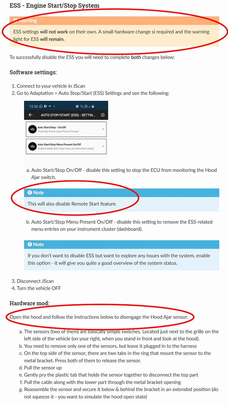

Had to replace my main battery it was over 5 years old. Disconnected the aux battery and pulled f42 fuse. Then I used my J scan and disabled the auto start. Has anyone else done this ? Could I run into other issues. Be interesting to know.

You can't use JSCAN to disable it. It looks like you can, but the feature truly doesn't work. They just never removed it from the app.
If it isn't working it is NOT due to jscan.
The only way is tazer, press the button every time or auto stop/start disable device.
JSCAN can't do it.

Sir, if you don't want to believe one of the most knowledgeable people on the subject in this forum, would you believe the makers of Jscan itself?
Jscan can't disable the ESS. Opening your hood disables the ESS so a mechanic can diagnose a problem while the engine is running. Dismounting the hood switch makes the computer think the hood is open, so the ESS doesn't function. Jscan then simply turns off the warning that your hood is open. Of course, your remote start ALSO will no longer work if the computer thinks the hood is open, and if for some reason your hood really IS open, I guess you will find out when you go fast enough for the hood to fly open and smash into your window.
