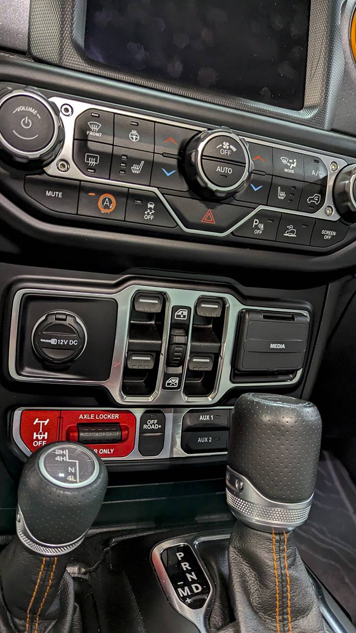

If you don't need extra and reserve battery capacities for camping, the easiest and most cost efficient thing to do is to simply bypass the auxiliary battery. It takes maybe 15 minutes and it effectively takes the aux out of the game.
As far as disabling ESS, you can use a doo-dad, lay down the hood plunger, or get in the habit of pressing the button after you start up.
I've done it for so long it's just like pushing the start button and buckling up.
I did enhance the visibility of the button for low light conditions.

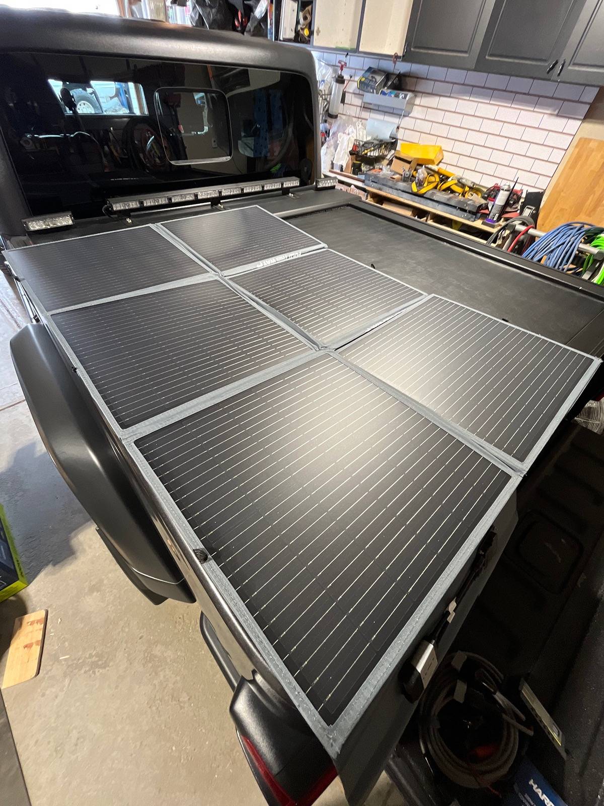

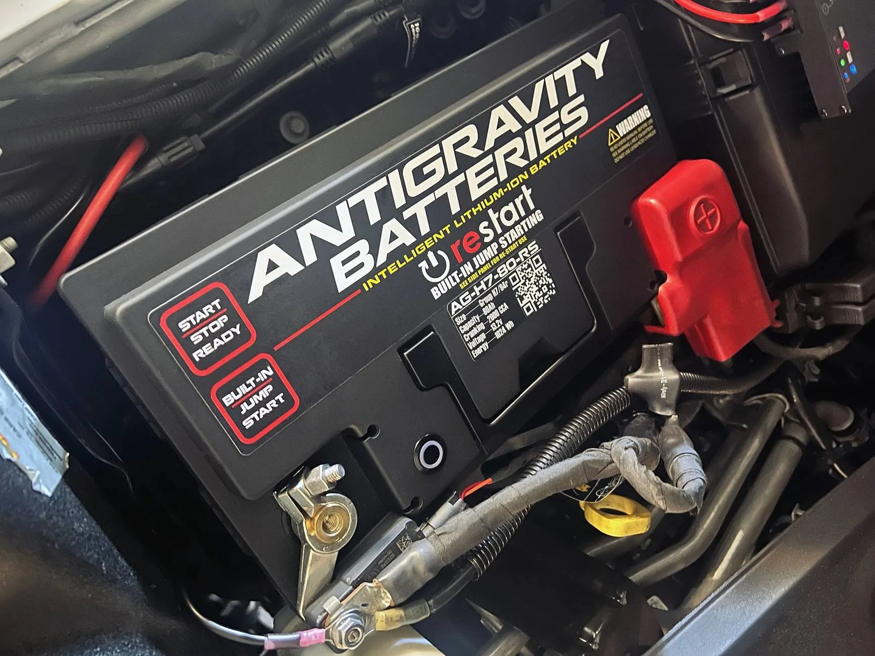

XraytecH
Bernie
Jan 14, 2021
209
1,903
2,803
South San Francisco
2021 Jeep Gladiator Sport
Xraytech
If looking to change out factory battery set up which of the following options would you go with and why?:
  • .Genesis dual battery set up
    • Nice set up for overlanding maybe.
    • Have heard hard to get/source group 25 batteries in short order. In other words without ordering.
  • .New Antigravity battery (lithium) and disable auto start (Tazer or auto-start eliminator cable)
    • Lithium battery long life and lighter weight.
  • Or would you just leave factory style battery and replace with like kind when time comes and disable auto start (Tazer or auto-start eliminator cable).
    • Ease of sourcing batteries.
Thoughts/comments?

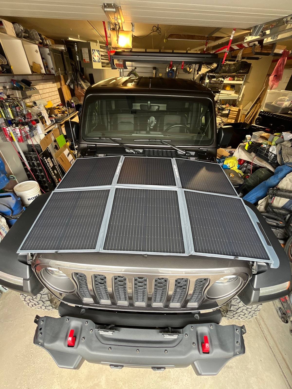

I don't see a lot of posts about this type of battery tech used in Gladiators. So thought I'd make my Gladiator a guinea pig.
For context...
- I live in the San Francisco Bay Area where it doesn't get HOT or COLD
- My Gladiator is parked in a condo parking garage
- Prior to the battery swap I've been running the Aux Battery Delete for about a year. Antigravity also states not to connect their batteries in series or parallel. So I took that as an AUX Battery Delete is requisite
- The battery that was swapped out was an Optima AGM H7
- I have Parasitic draw but who doesn't, can't be bothered to track down the usual suspects
- Installed hood solar panel to counteract said parasitic draw
- Daily Driven but a really short commute, the other reason I installed a solar panel
It's been a week so far and no issues as described by other folks on the interwebs about these types of batteries. Like the BMS disconnecting the battery when the alternator puts out more than 14.4V and ambient temps outside of 33-113F. To be honest those two conditions are the only issues described by some folks about these types of batteries and maybe half of those folks heard from another guy who heard from another guy who heard from another guy who read a post from another guy online. I paid a lot of money for this battery so yeah... I was on the fence for a while.
Check back for updates and please share any "FIRST HAND EXPERIENCE" with this specific battery or similar.
