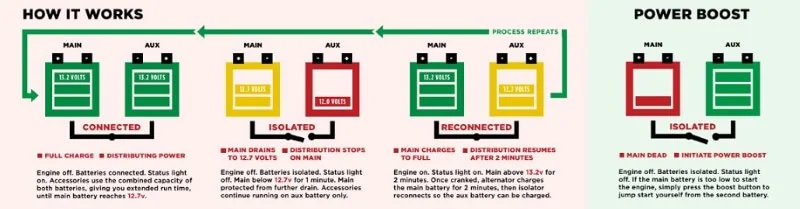

But, there are other advantages, too. First, most battery isolators--an integral part of a good dual-battery install--have a provision to override the isolation in the event the start battery isn't powerful enough to crank your vehicle. Usually it connects the two batteries for a minute or so, during which time you can use both batteries together to get your vehicle started. Think of it as self-jump starting. After the minute, the isolator returns to normal function, isolating the two batteries so that the start battery is first connected to the alternator to recharge, then connecting the aux/house battery into the circuit to charge both.
