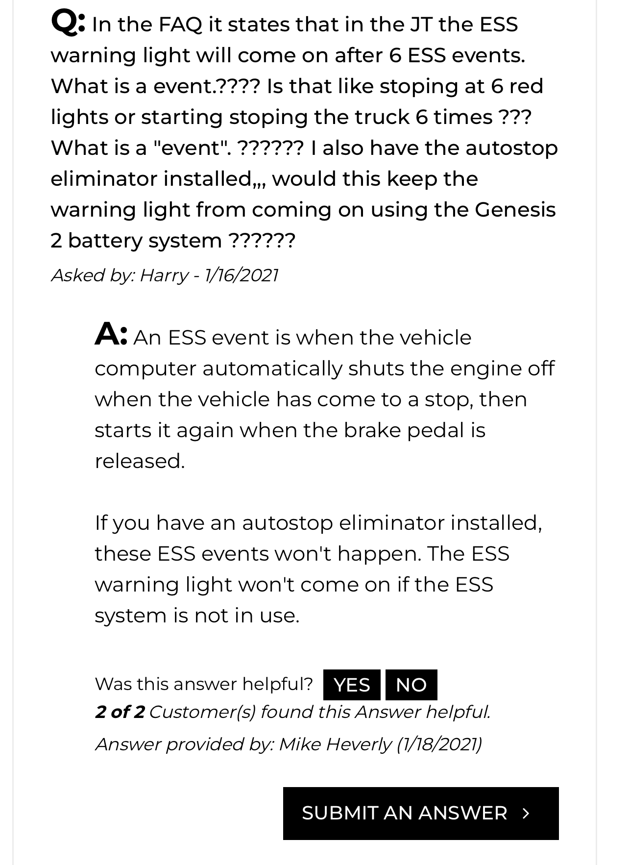

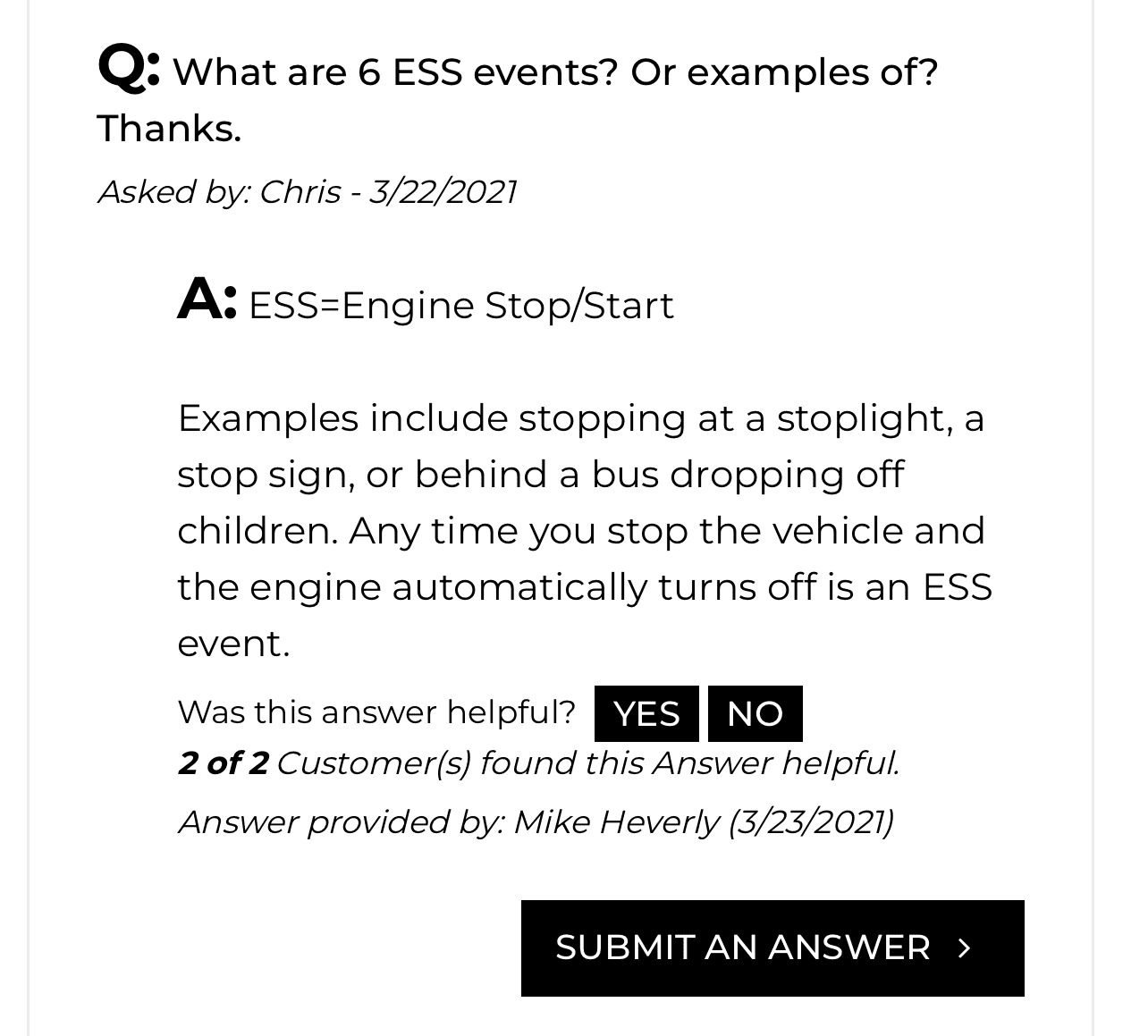

if i'm reading their faq right (link below) after 6 ess events the warning light will come on as the system detects voltages are not what they are expected to be... i.e. no more tiny battery, etc. an ess event is any time ess is active.
if you disable ess, there are no ess events and the light never comes on. did not see any way to prevent the light without disabling ess.
https://www.genesisoffroad.com/jt-dual-battery-kit

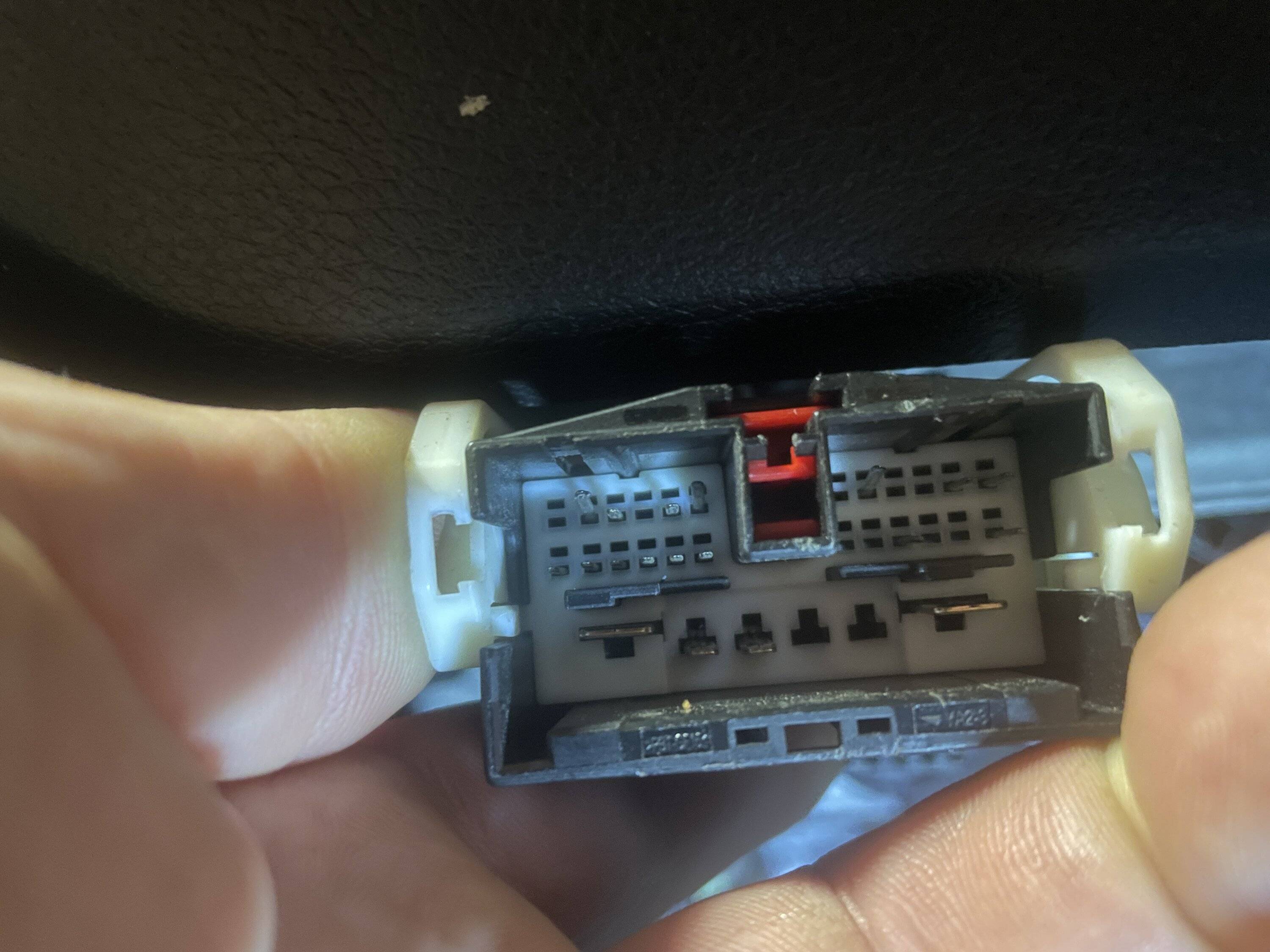

I’m having this issue.
Here is how it starts up.
Ess is off because Taser
I also just put the doors back on.

I suspect a bent pin on a door connector. The combination of autopark and auto start stop message really points to that for me.
agreed
got home from dinner and found bent pin. Fixed and all good
mac ‘back in business’ gyvr

Were you able to detach the harness from the body of the Jeep?
Great question.
That was last fall and I don't recall.
I will have the doors off again soon. I'll try to take a look.
