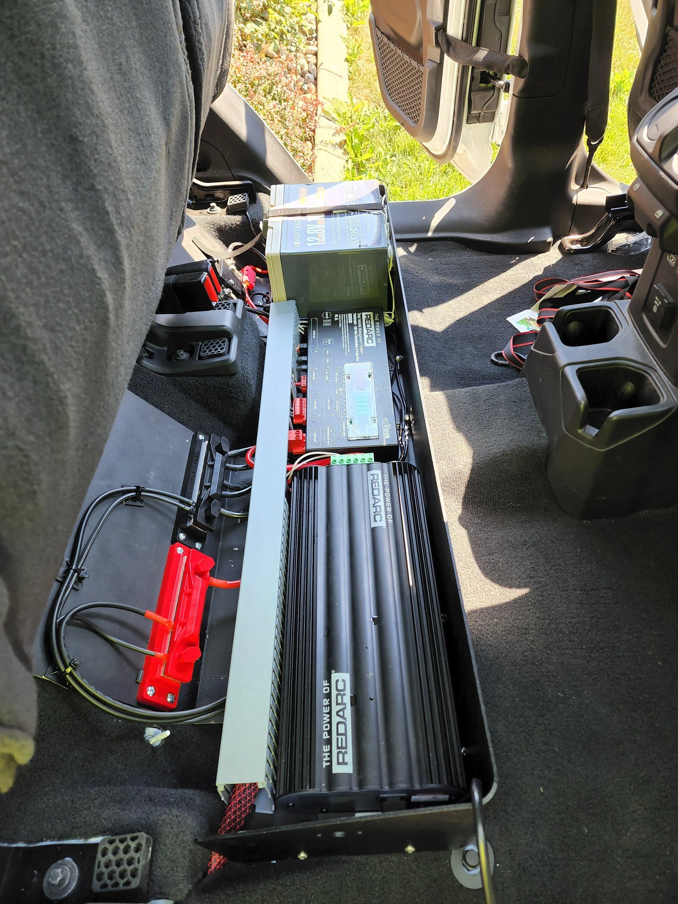

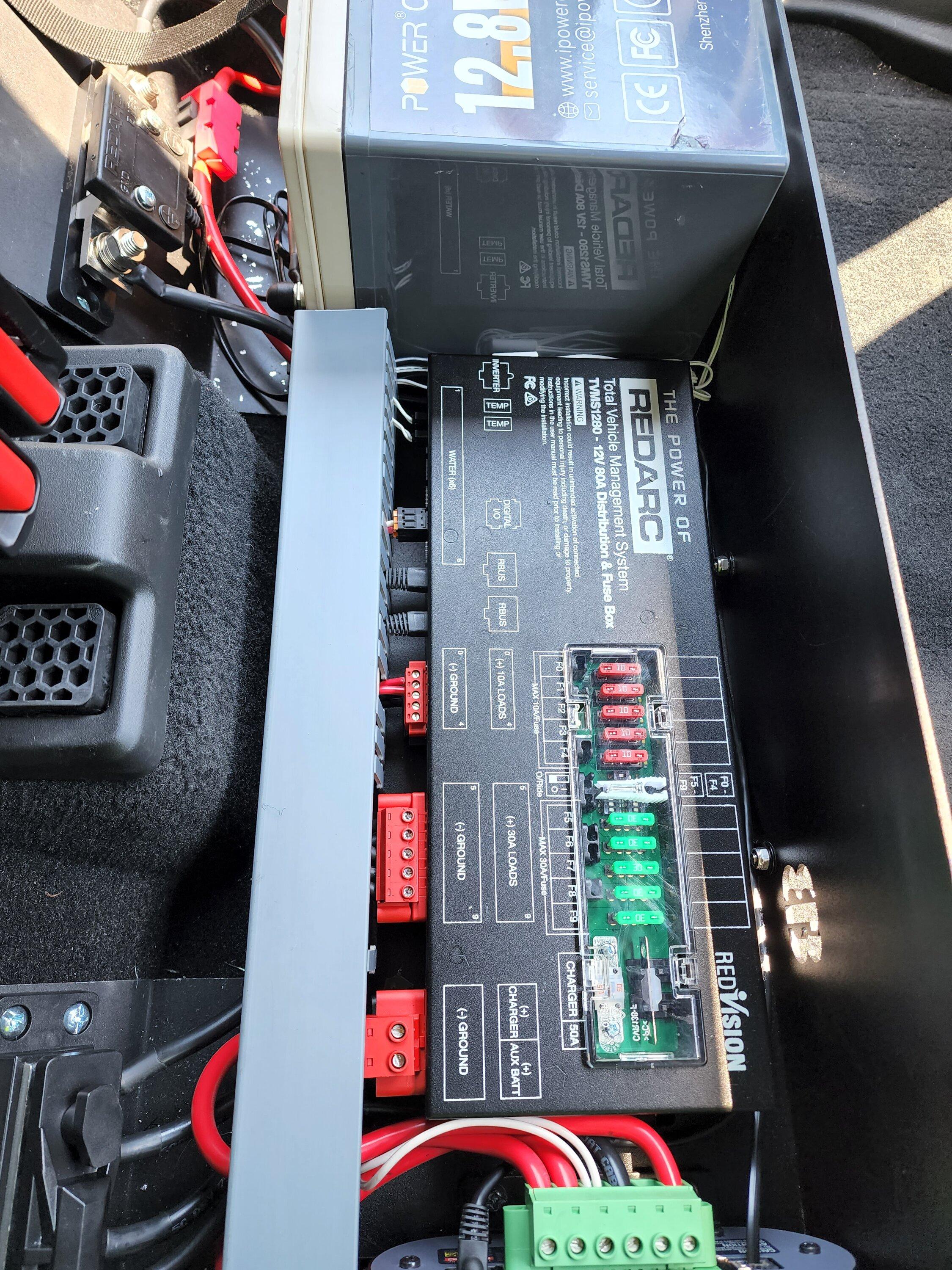

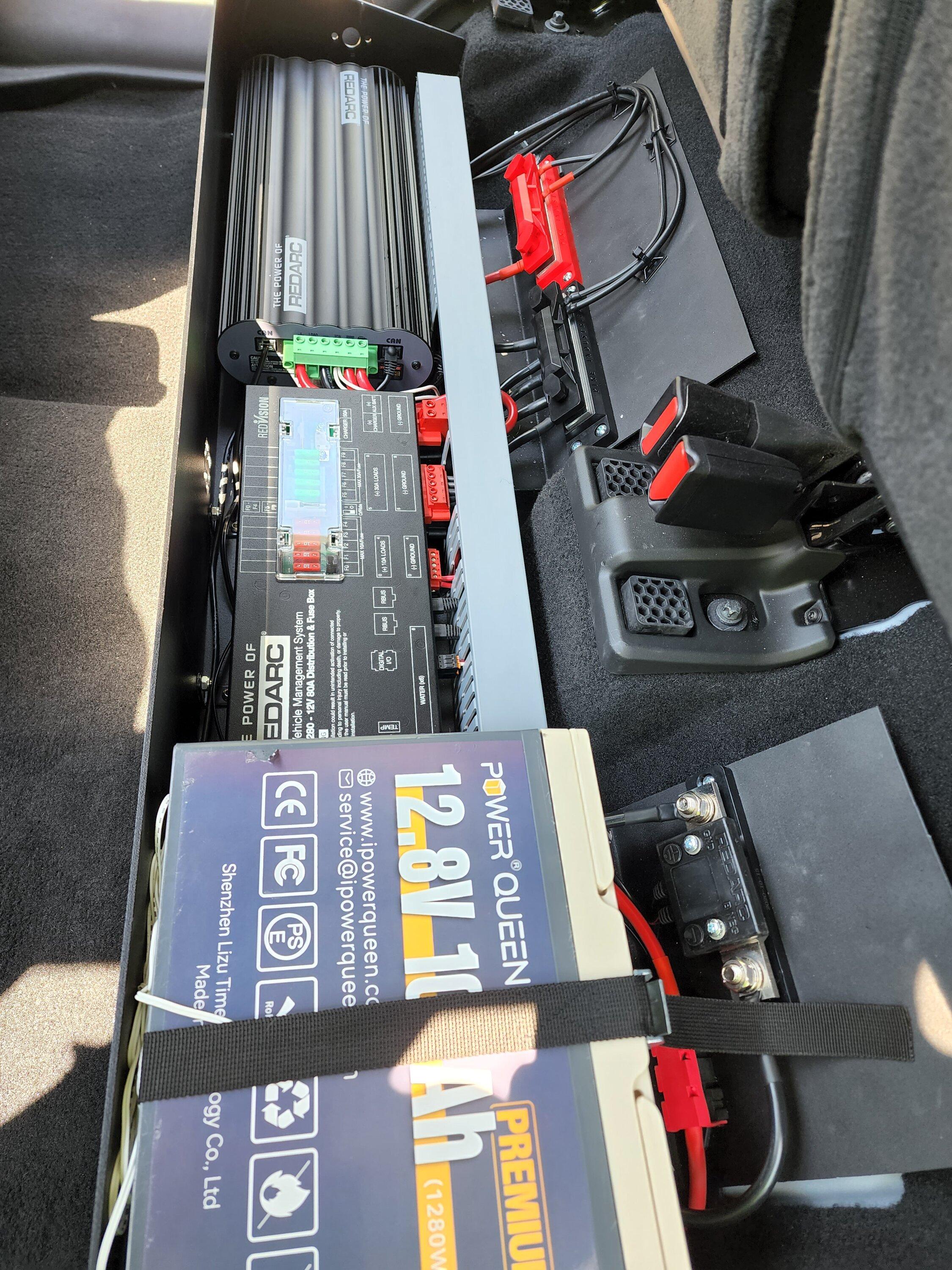

This is a setup that a customer put together for his Redarc Redvision system using our Underseat Storage Bin. This customer used a battery that required removing our 1" spacers under the bin, which does take away using the locking seat brackets, but it is something I am looking to correct with some new brackets maybe. But, using the correct size battery will let you still use the current seat locking brackets. I think you can save even more cost and space going with a smaller Redarc BC-DC unit, rather than the full Redvision system and have a nice dual battery system.
Jeremy, could you share any other info regarding this particular install?? Im planning something very similar. Im interested in the mounting plates where the fuses are mounted to. What size battery would fit in this container and still be able to use the locking latches? Any info is appreciated. Thank You
Hey, sorry for the late reply! The mounting plates for the fuse blocks is something the customer made so I don't have any info on those.
For the batteries, he used the "premium" version of this 100ah battery because it was a little shorter when on it's side. They now have the "mini" version which would probably work better but it is slightly taller, so when on it's side, it would be just a bit taller.
https://ipowerqueen.com/products/power-queen-12-8v-100ah-mini-built-in-100a-bms
https://ipowerqueen.com/products/power-queen-12v-100ah-premium-lifepo4-battery-built-in-100a-bms
Let me know if you have any more questions!
