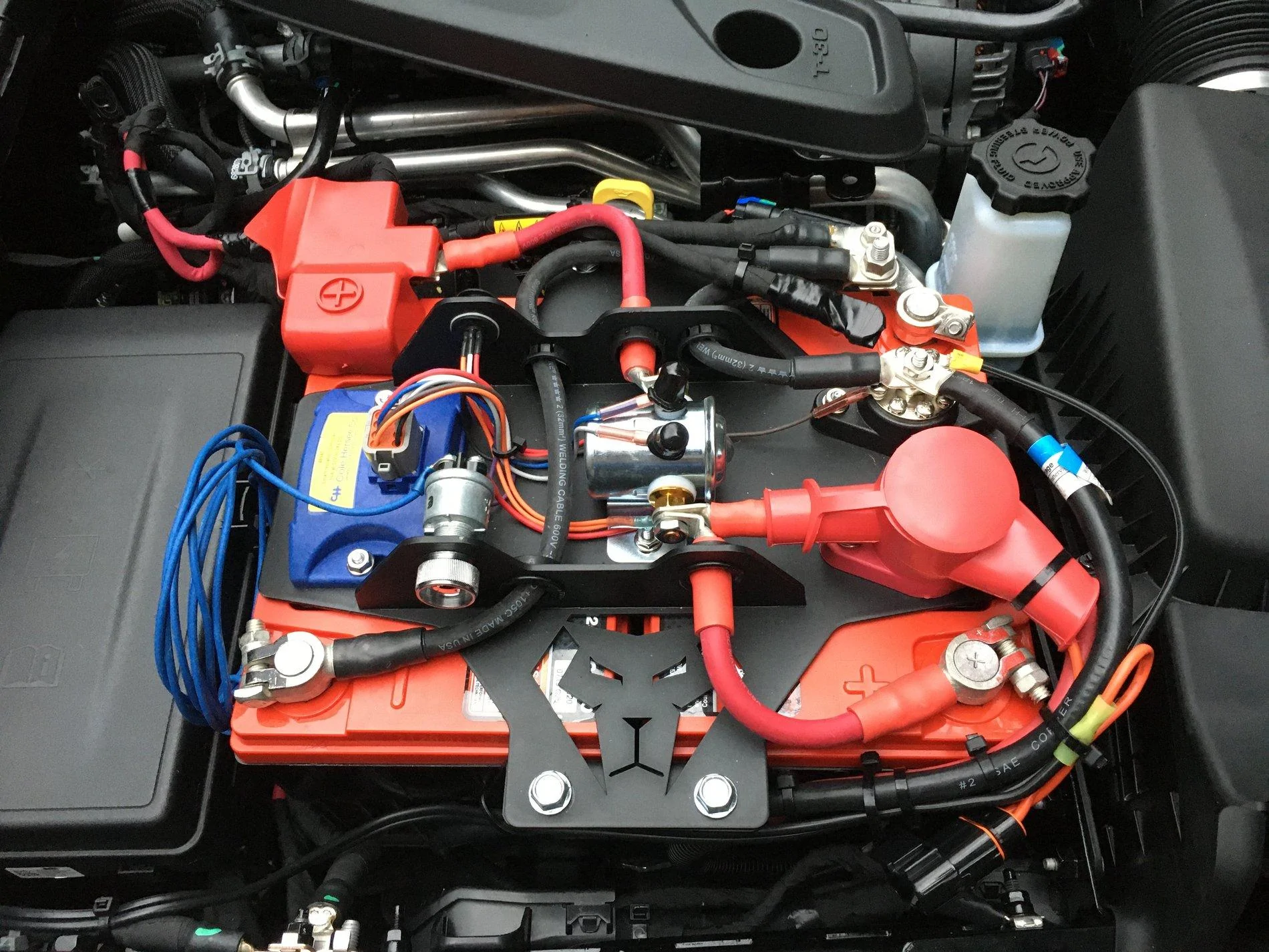

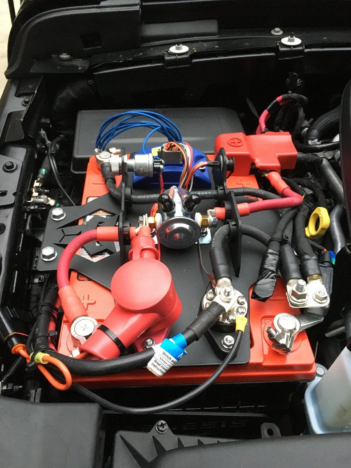

Put in the Genesis bracket and batteries today, very straight forward install. If anyone has any questions, I'm glad to help. Waiting on Shane (Mr. Genesis) to let me know if I can use aux switch 4 in the momentary mode instead of the push button switch on the bracket. I was hoping that I can use my inside switch, if ever my battery goes down, instead of having to open the hood. That's why the blue wire coiled is still not yet hooked up.

I watched the Genesis install video. I didn't want to take things that far apart, and remove the ESS battery. I mainly didn't want to spend that much money.
Instead, I bought a battery box and a Cole Hersee Smart Isolator off Amazon. I'm going to mount the the battery behind the right rear wheel, and then run cable up and mount the Isolator by the battery.
This will give me a separate battery for the winch and lights, which is charged by the alternator, and I'll only have to buy one new battery.
If the Aux switch can be programmed for momentary operation, it should be able to activate the boost function. The only problem is if the main battery is low, it may not have enough juice to get the boost to activate. I believe they have it wired so the voltage to activate the boost comes from the auxiliary battery.
This set up is probably just what I am looking for. Its probably written there in your post , but did you take the auxiliary battery right out ?
Go to the Genesis site and watch the installation video. It should answer most of your questions. Removing the ESS battery is part of the process.
