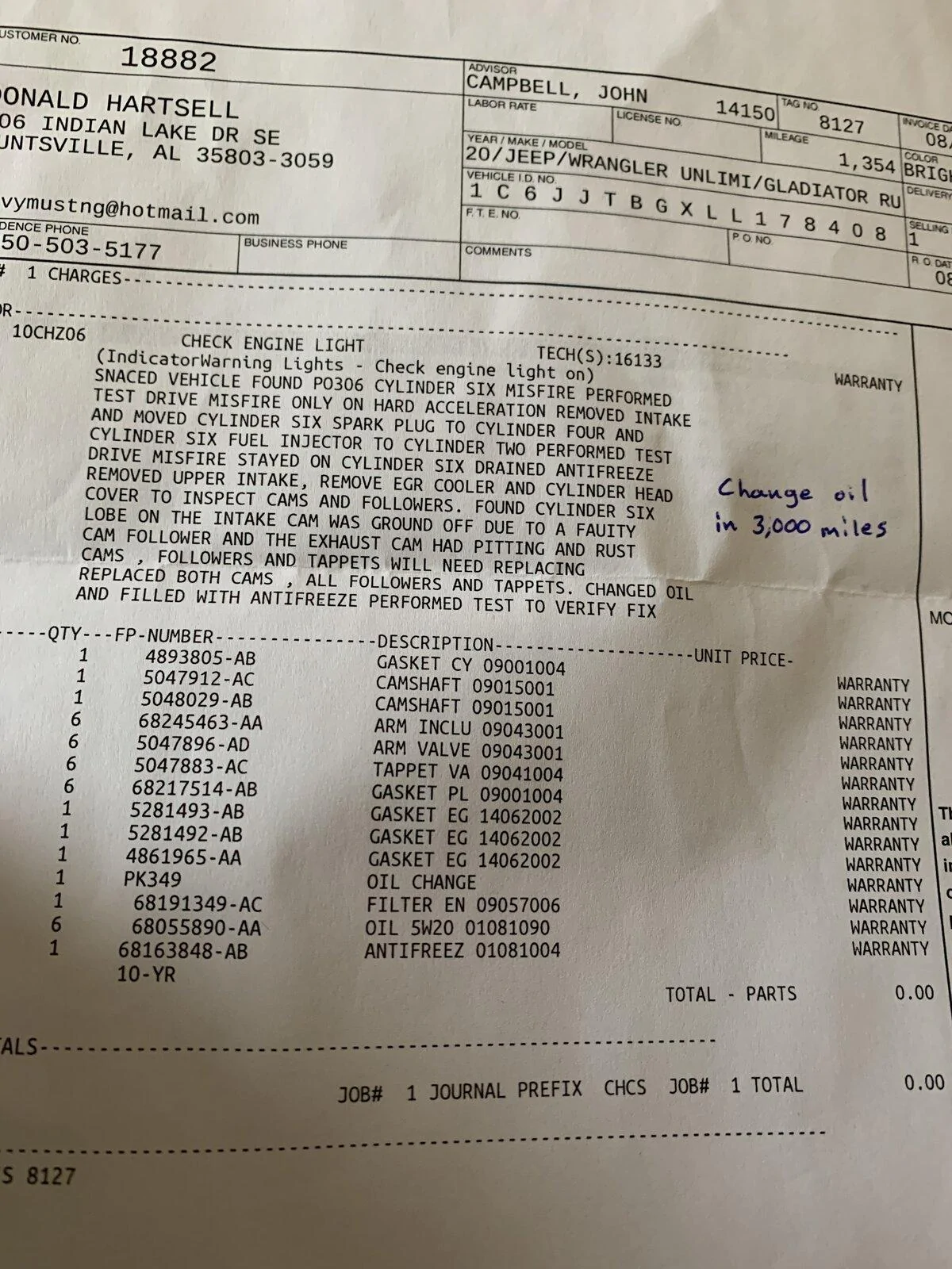

Update to my original post.... engine started pinging to the point where super unleaded didn't even get rid of it, gas mileage plummeted over the past several months and the check engine light finally stayed on long enough to get an appointment at the dealership. codes came up as right bank camshaft i was told. They ordered parts and came in the next day. Service advisor said it should be done the next day. The next day no calls and no return calls from the voicemails i left. Finally got in touch with the service advisor after two days and oh boy, now it's the intake cam on the right bank, exhaust cam on the right bank, lifters, rockers, journals and a host of other crap for the number 5 cylinder. One year of ownership and less that 5000 miles, yippee. Even better than that, they said they have no loaner vehicle for me. All the engine noise concerns started between 1500 and 2000 miles. Every time it went in to be looked at, came back with the same BS... tech could not duplicate noise, no CEL, all systems functioning as normal. This is sue doesn't even address the intermittent auto start stop failure light. That comes on at least once a week and goes out after a restart.
Fixed mine! See attached!
Jeep Gladiator Auto stop failure, now check engine light. 2FAA596E-CDAD-4152-8DEF-3F0674306C17

Damn, that service write up is everything that I was told was wrong with mine but mine is number 5 cylinder. I hope it fixed when it gets back. I was told the rest of the parts finally came in Friday. I may get it back Tuesday or Wednesday but I'm not holding my breath. Did it solve all of your problems?
Absolutely did!
40,440
53,854
Absolutely did!
There's been others post similar - damaged cam, rusted cam and things similar to what's on your work order there - crazy!
I think every dealer needs to be sent a copy of your paperwork!
