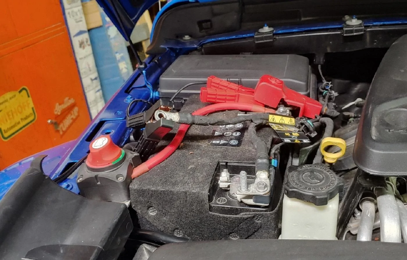

Well main battery good. Now 4 bolts to check aux
250
40,612
54,309
You can check the voltage or even charge it without removing anything other than the aux black battery cable from the top of the IBS on the crank battery.
You don't want to load test it that way because of the massive draw through the relay down there, but you can charge the aux battery and check voltage simply, remove a cable.
Thank you for this. I bought a certified used Gladiator Rubicon last week. The dealer said the battery was dead from sitting on the lot. I took it home and got the dreaded A! On the dash. I took jumper cables and let it charge up for about 10 minutes. The next time I started the light went away and hasn't come back. Thanks for the simple visual!
