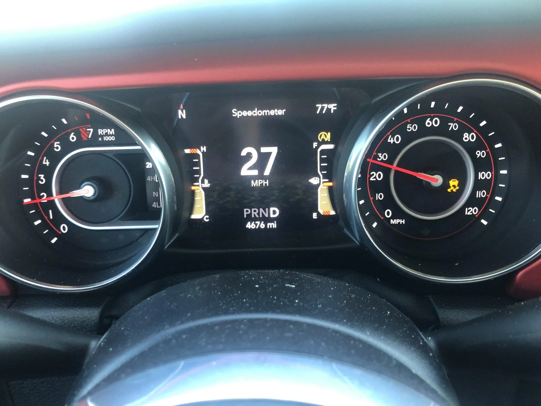

I'm having the Stop/Start & the Service the electronic control lights come on. Only 4,600 miles on mine! They reset when you shut off the truck and come back on within 5-10 miles of driving. Goes to the dealer on Thursday.
Jeep Gladiator Auto stop failure, now check engine light. IMG_2541
