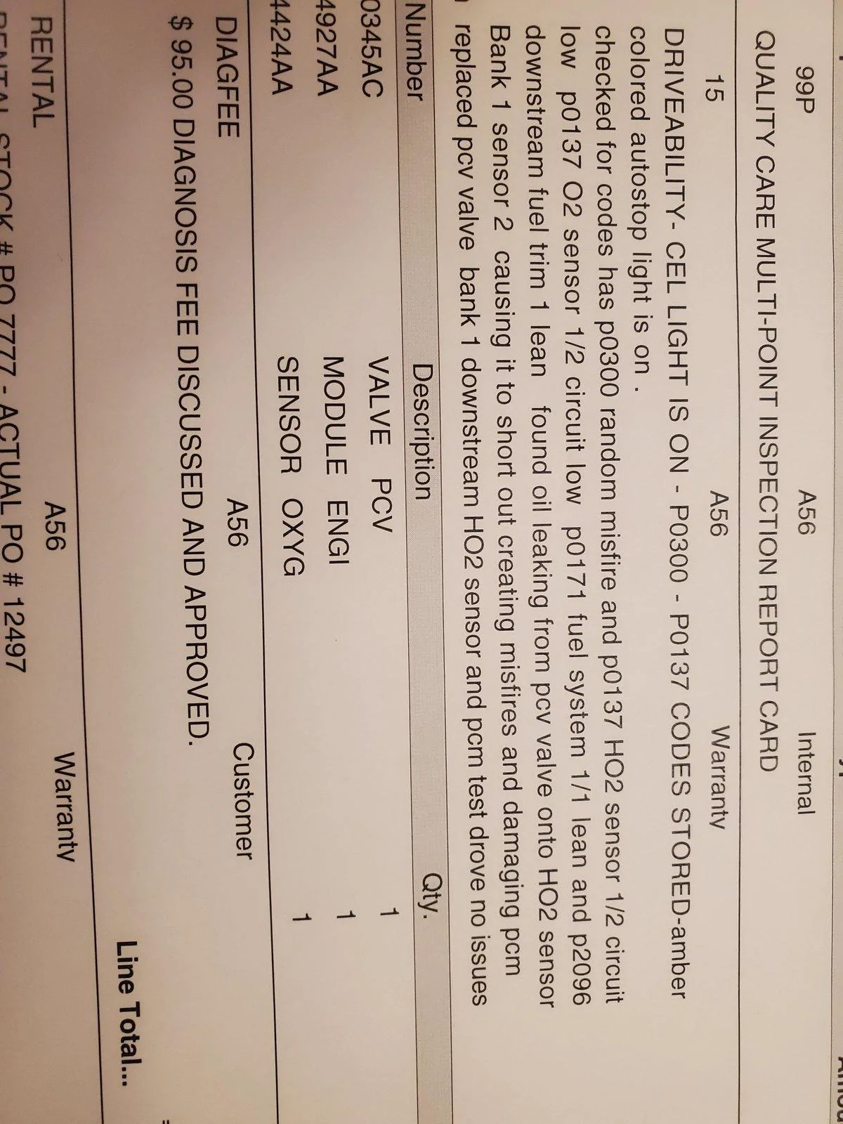

All, wanted to post this up here in Hope's it may help others dealing with this. I'm on day one of having it back, but no lights are currently on. Good luck.
