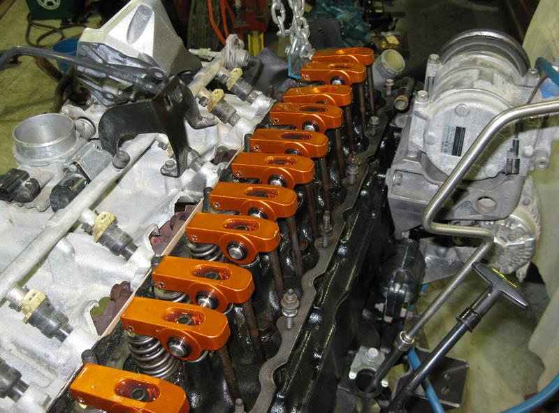

These are more followers than ordinary rocker arms. There is a "lifter" involved, and the "rocker arm" follows under the cam with these.
And there are bulletins about this - here's a quote from one regarding replacing a rocker arm if...........this is a direct quote from a MOPAR bulletin -
>>The symptom/vehicle issue is ticking/tapping noise from the upper engine area. In addition, this failure can also set a Diagnostic Trouble Code (DTC) for an engine misfire.<<
Even on non-overhead cam engines a worn or misaligned rocker arm can cause misfire.
Doesn't take much to cause it, either.
I had it happen on a Jeep engine before, abnormal wear, valve didn't open enough, misfire under load.
My solution to that sort of wear was this on this particular engine. I was tired of fussing with wear and poor alignment - (one of many dozens of engines I've built)
