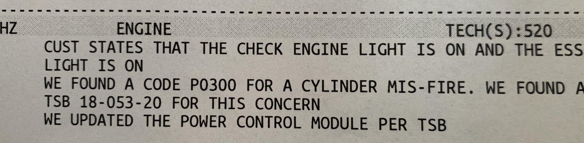

Just an update. I had it back to the dealer a third time and they FINALLY said they got the update for the computer. If anyone needs the actual language for their dealer please see the attached...
Check that, not even 24 hours later and both CEL/ESS lights are back on!

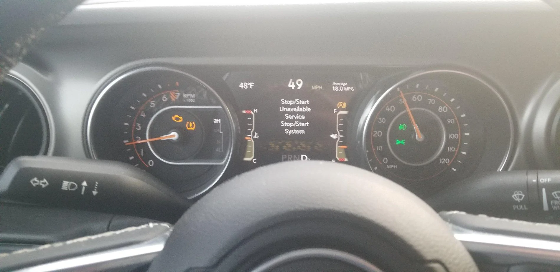

I’m in the same boat y’all. JT has 10,900 miles on it. I was accelaerating into I-35 in San Antonio and the check engine light came on. I continued my trip with the family and got gas. Light went off. Pulled back into the highway and had to pass a truck. Accelerated to get around him and the engine light came on again. It seems to be running fine. Last night when I went to get in I started with the remote start and the dashboard said that the remote start was disabled. I’m going to take it in next week when I get back home. It’s pretty frustrating.

I had engines issue right from the start in Aug 2020 when I got it. 60 days or so in the shop and I got a new engine. 2000kms later I have constant CEL & ASS Light. I now call it chitty chitty bang bang. It runs so rough now. So I guess it’s back to the shop to start the process again. All this on a brand new 2020 with less than 8000kms. Very frustrating.

Great, This is the stuff I'm in for with my auto start/stop failure light and check engine light. This now and the rattling clicking sound from the motor. It's been to the dealer three times for the engine noise that they can hear but tell me new Gladiators make the same noise. It was quiet as could be when I first got it. When i took it in to have it looked at the third time, I took the service manager for a ride. As soon as he heard it he immediately said that's not normal and lets go back immediately. Tech looked at it and said he couldn't hear it. There were no CEL's on so i guess no problems then. The noise is still there and now i have the other faults at 3100 miles. Dropping it off at the dealer Wednesday.

Calling Dealer this morning. Ess light on every now and then and check engine light is now on. 1700 miles.
