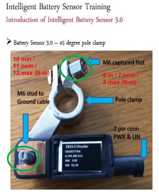

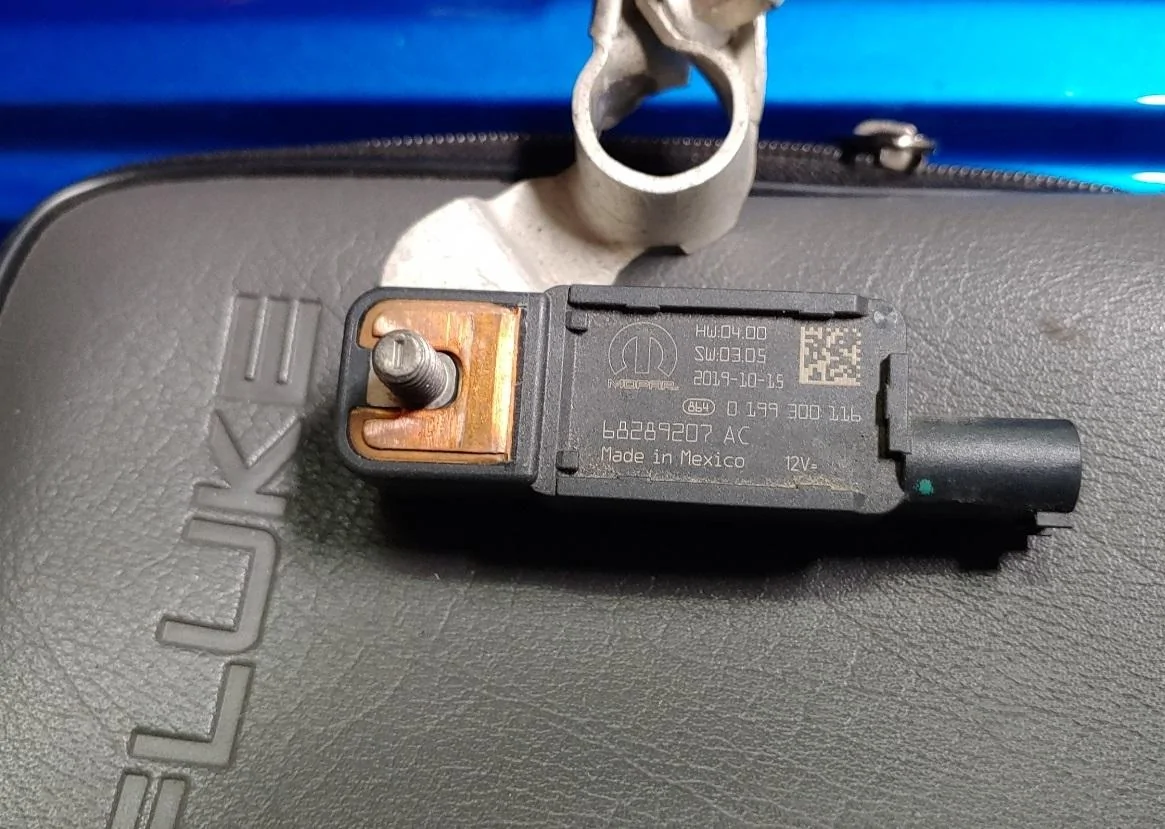

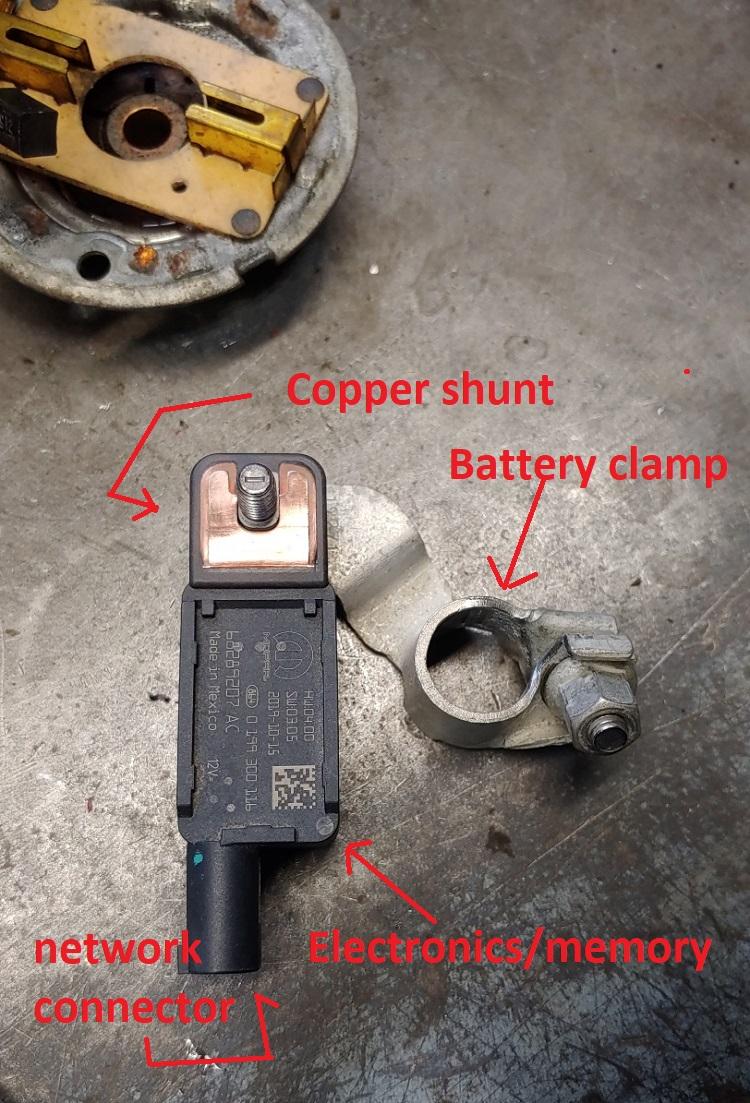

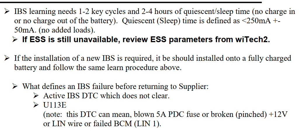

IBS, irritable bowel syndrome - or, Intelligent battery sensor. I guess it's our choice.
Seriously, it's a small device that goes on the crank battery negative battery post, and the other cables connect to the IBS.
That way, anything going into or coming out of the battery is sensed, and it also tracks battery temperature, state of charge (you'll see that as SoC) and other fun stuff.
The only thing you'll need to do is reset the IBS and let it relearn - as shown below.
Resetting it is simple - remove the negative cables from the top of the IBS, remove the IBS from the negative battery post - let it sit a few minutes disconnected.
This is the one from my truck - >
Jeep Gladiator AUX Battery 20220329_094914
Jeep Gladiator AUX Battery 20220329_093938
When putting in new batteries, if the IBS is disconnected from the batteries and ground for a few minutes (something like 5 minutes I believe the training materials I have state), it will reset and need to relearn.

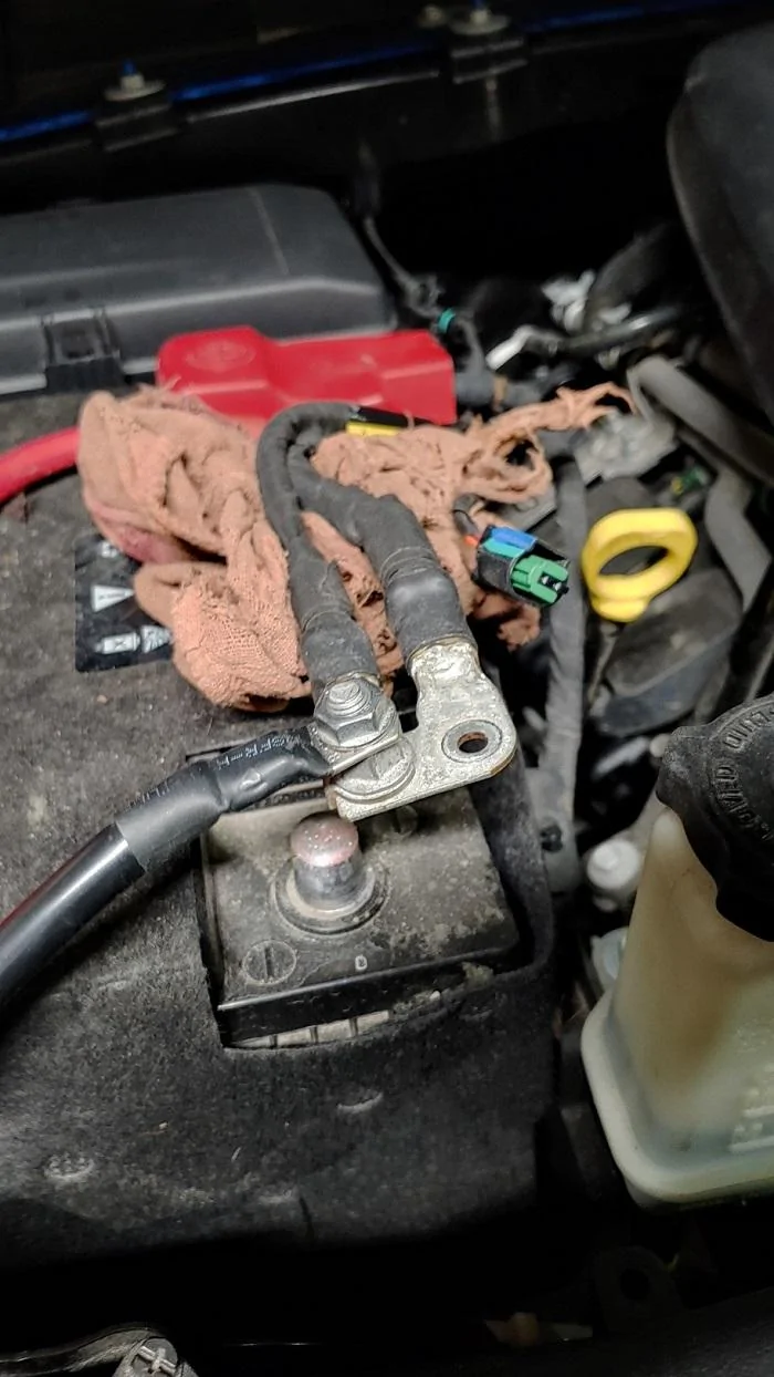

Pic below is where I took mine off the cables and the battery post. It's not necessary to remove the network connection, but I did just to get it clear out of the way ->
Jeep Gladiator AUX Battery 20220329_094211_HDR
If you replace batteries, make sure the batteries are fully charged when put in place, leave the IBS disconnected to force it to reset, and put it on last.

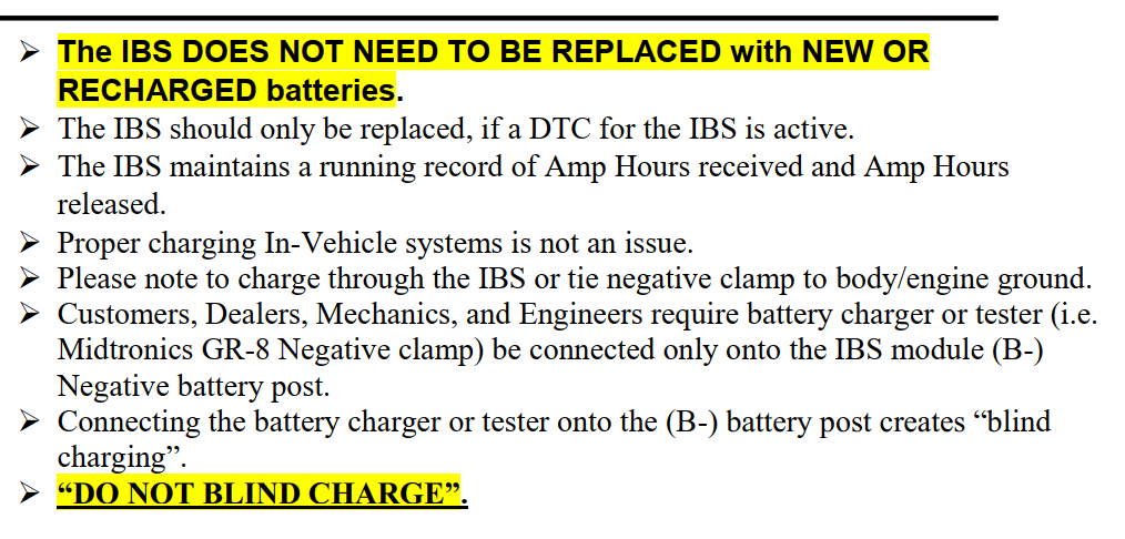

It will require "relearning" as outlined here -
Jeep Gladiator AUX Battery 1654200035033

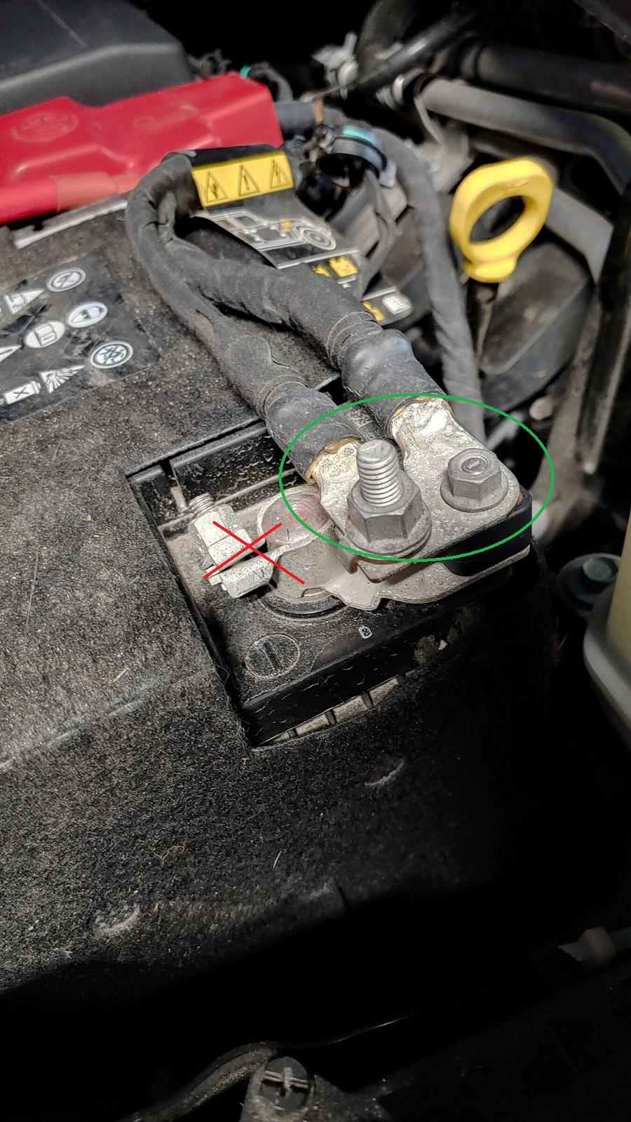

From that point on, all charging should be done via the studs on top of the IBS, not directly to the negative battery post below it........... bypassing the IBS or connecting directly to the negative post is called "blind charging".
Jeep Gladiator AUX Battery JT-neg-bat-post-connect
Jeep Gladiator AUX Battery 1654199978329
Jeep Gladiator AUX Battery 1654200084824
