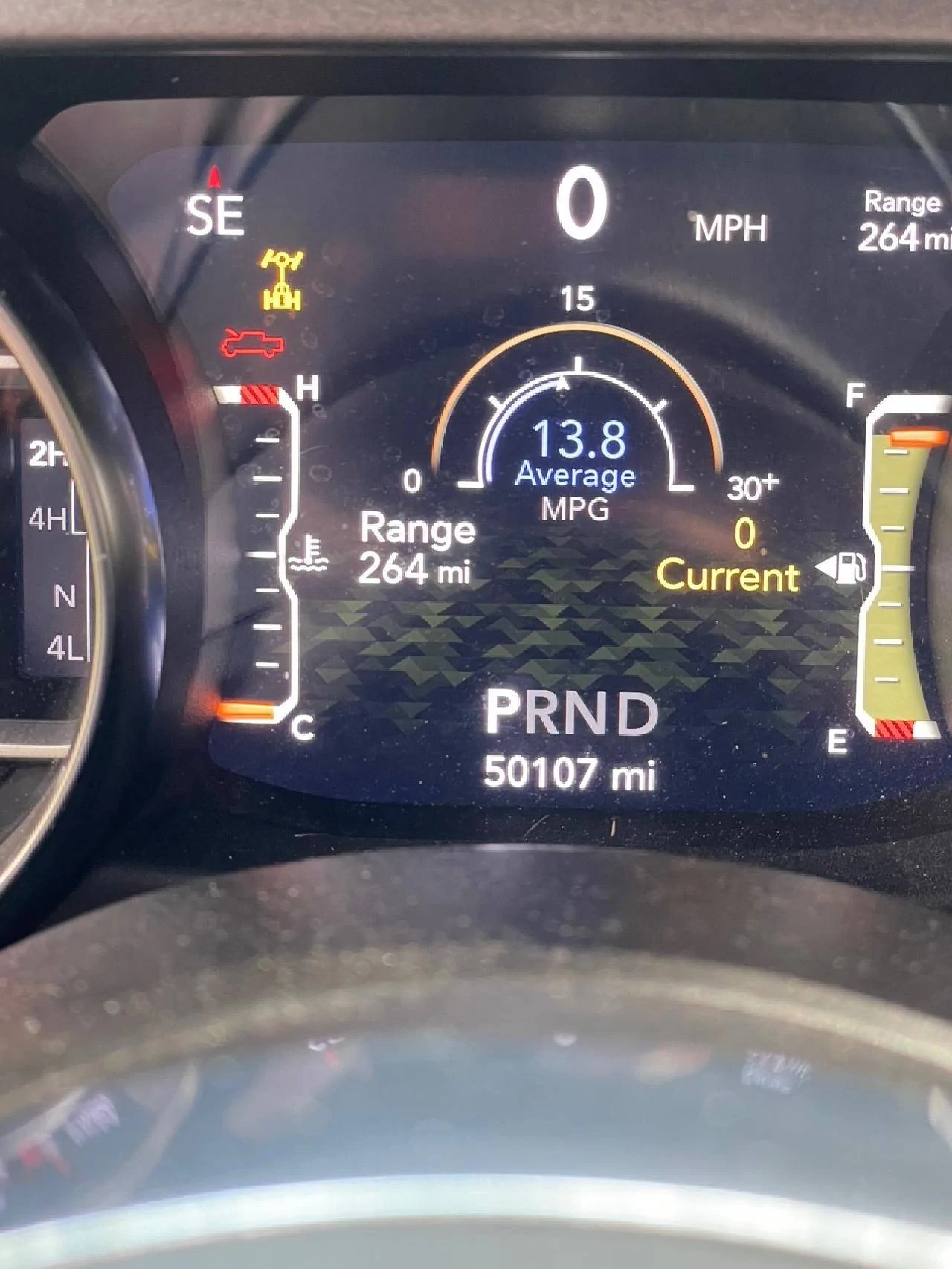

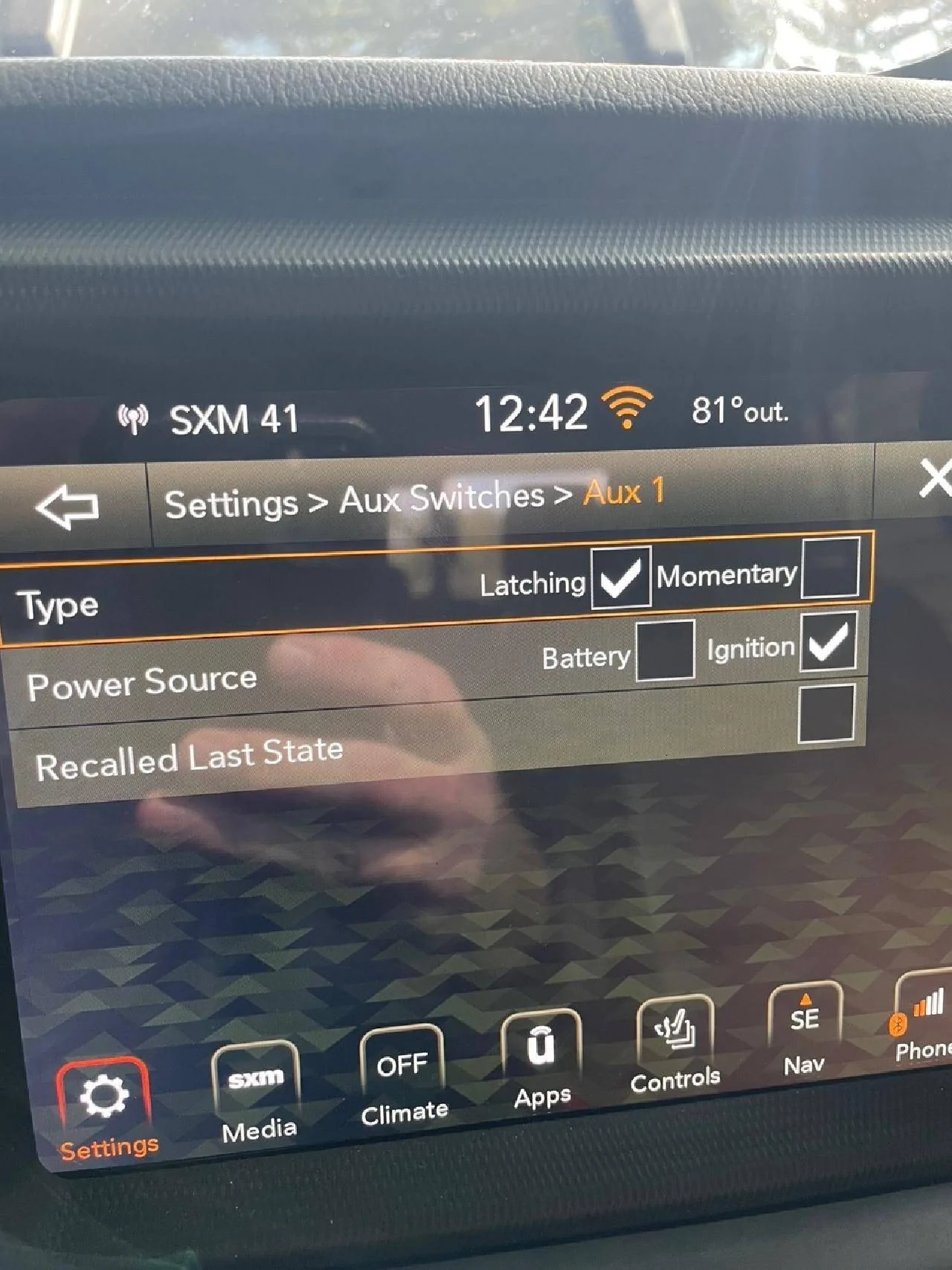

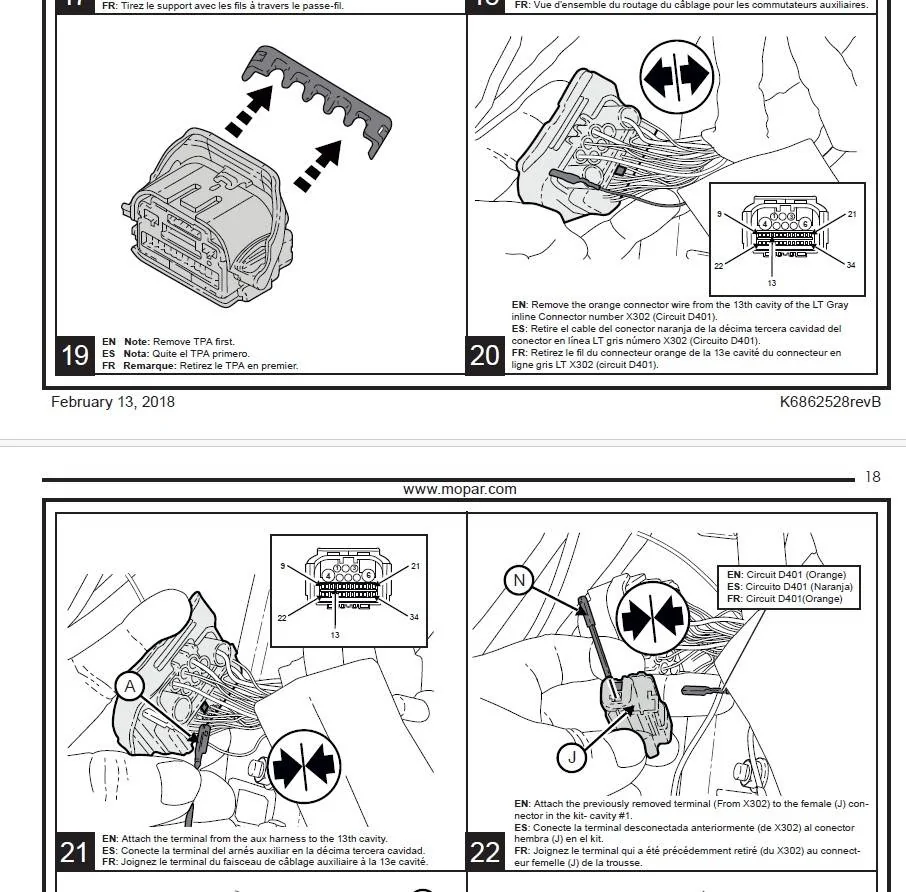

Update, I think it's fixed. I pulled everything back apart and made sure wires were secured again. I didn't find anything. Long story short I reassembled everything and did the Tazer reboot cycle again. When I cranked it the locker warning was gone, and dash said AUX not available due to low voltage. Doors were open all day because I'm slow. I did secure the connection @ecidiego mentioned without the supplied connectors. I have an hour drive to work so I'll know for sure in the morning. @Hootbro I'm pretty sure I had enough space between harness and switch harness. I used plenty of tube lube and it just slipped right through. My “nipple” is at 12 as well.
