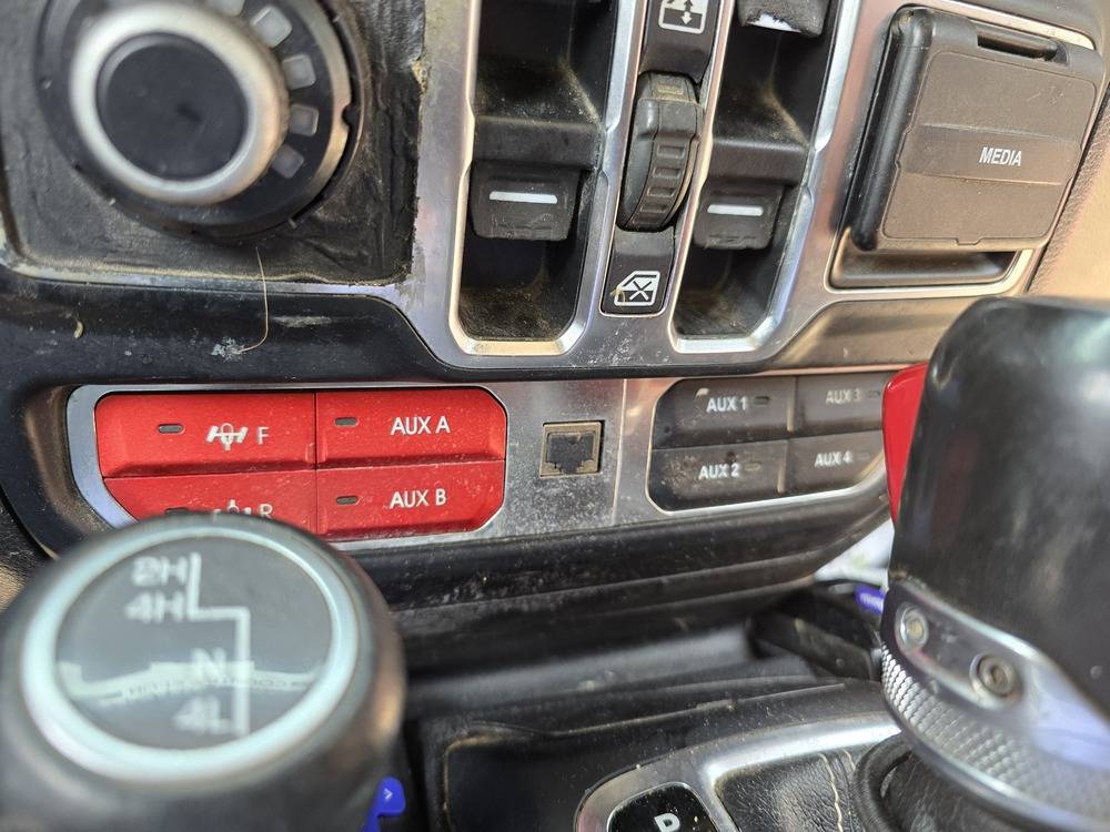

Here is my experience and opinion.
A simple and better solution for aux switches is to get the aux switches setup from Lasfit. They look factory and they have their own fusebox. That eliminates you from having to interfere with the stock fusebox and still have switches that look factory. And most that are adding the factory aux switches and wiring harness are having to enable the option within the PCM. With Lasfit, you don't have to do that.
My Jeep came with the factory aux switches, but not the locker switches. So, when I installed lockers, I needed switches. I bought the Lasfit setup for the left side which gave me the locker switches and two extra switches.
And they have them for both left and right sides.
That looked like a good option. Sadly the site says "not compatible with manual transmissions". I have a MT...grrrr. Now I wonder why a MY makes any difference!
