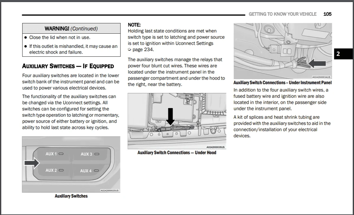

I re-ordered my jeep as well, and opted in on the AUX switches- would recommend.
As far as functionality that non-OEM switches may not have, there is an integration with the Uconnect system, memory function (remembers if it were on/off when you turned you truck off), assigns switch type to each button, and whether the lights go on or not. Explanation of the AUX switch system starts on page 105 in the owners manual.
Jeep Gladiator Aux switches worth it? 1604784676037
Basic functionality, but I appreciate the OEM integration and pre-installed wiring harness, so it was worth it for me.
