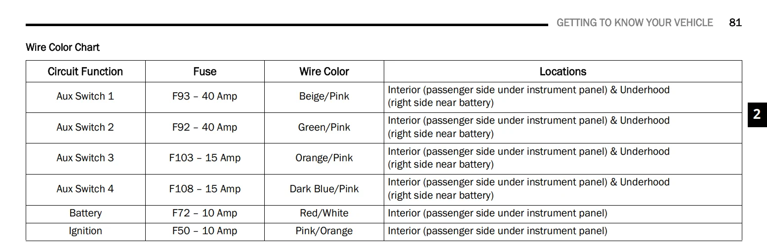

If it's the factory setup, the relays are in the PDC/fuse panel.
And there is a battery feed and an IGN feed wire inside in addition to the 4 aux switch wires inside.
Only the dealer/owner installed package doesn't have those wires and has the relays in line with the harness..
I use one to control my winch disconnect solenoid I installed.
Another will turn the power off and on to a 12v outlet and USB port I'll install in the bed.
Still another can trigger my bumper mounted Oracle backup lights for use when I'm strapping cars onto my trailer, etc.
Uses limited only by imagination. If the factory relays can't handle the amperage, use them to control even BIGGER relays you install elsewhere.
If it's FACTORY installed, this is the wiring key -
