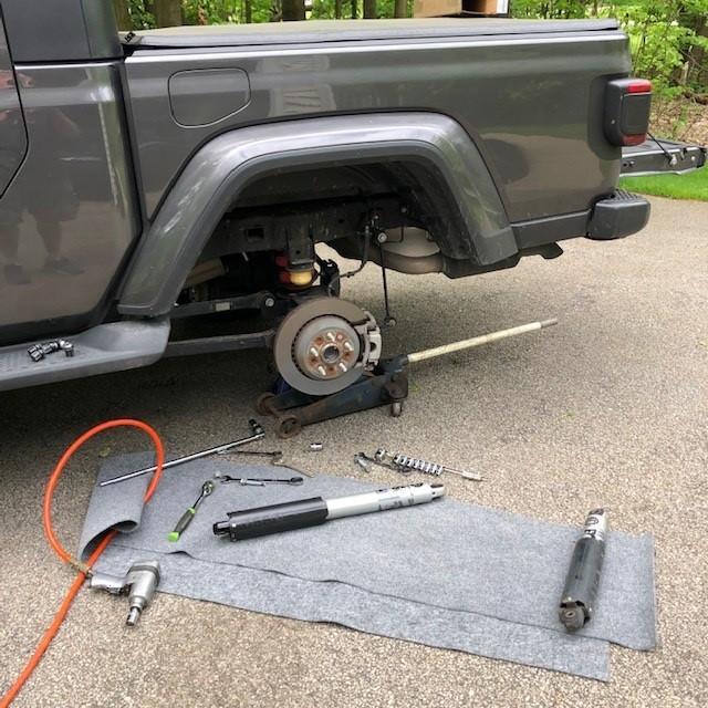

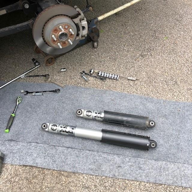

Update: The new shock arrived, so I was able to swap it out. That original shock was crap for sure. I was able to compress it easily between my hands, and then it just held all squished. Compared to the new one that took every bit of strength I had to push it up into the axle bracket!! No more clunk when I drive!!!

You know it's bad when you can compress it by hand and it stays.
I bet that thing not only doesn't clunk, but you can feel the difference on certain road conditions.
6,369
14,539
There's no pressurized gas left in that shock. It all leaked out.
For sure! The ride is very noticeably improved. Glad I finally got this fixed.
