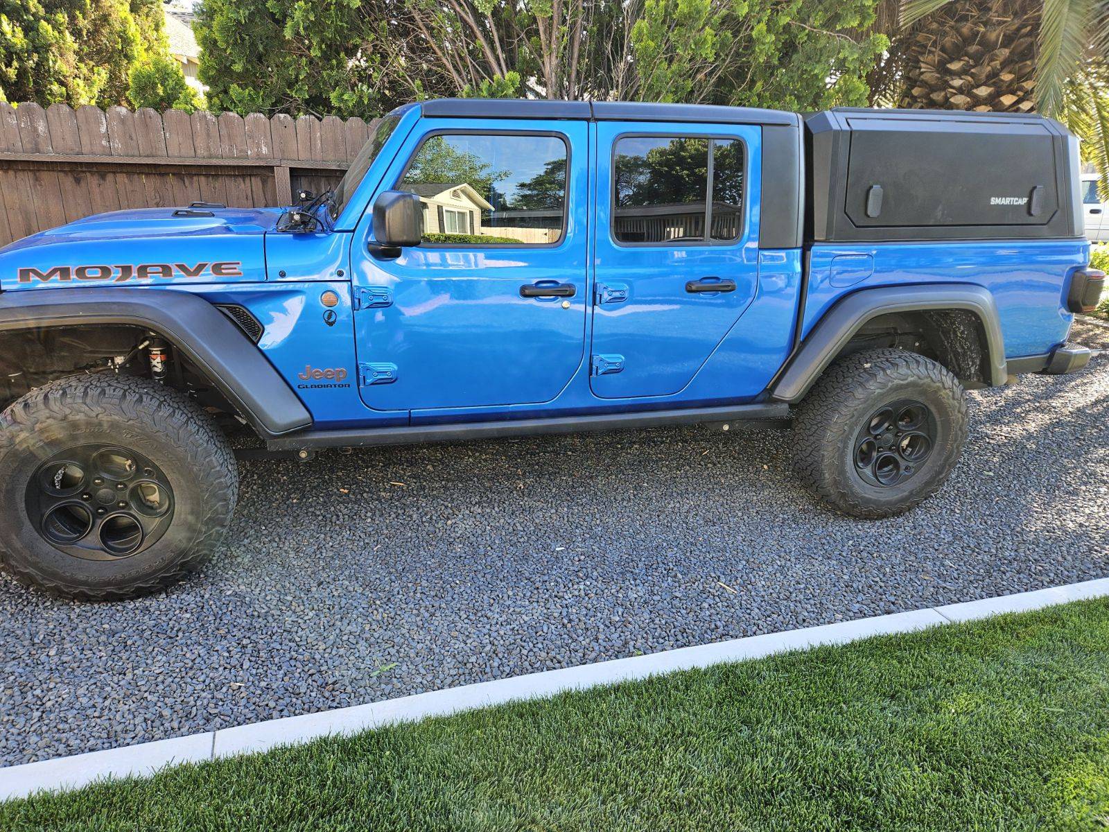

I have a '21 Mojave with stock suspension other than the AEV spacer lift. When I drive the truck first thing in the day, usually early in the morning when it's cold outside, I get a lot of noise from the front shocks. Not a popping sound but more like a rubbing or wiping sound. Within a couple of minutes it goes away. Curious if any other Mojave owners have had this. I'm not a fan of Fox stuff and in time I will be replacing everything.
