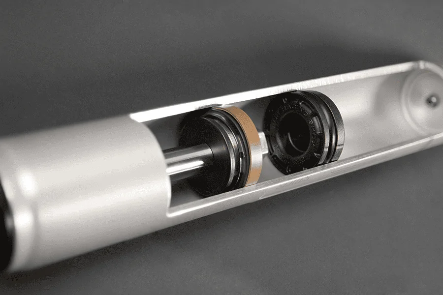

Realize that these mono tube shocks are filled about 60-70% with oil, then a spacer (called IFP) and then the top is nitrogen. Any breakdown of the seals can lead to mixing of the oil and nitrogen. It's called shock aeration. They use nitrogen because it doesn't mix as readily with the oil as air would, but it still mixes.
https://www.shockwarehouse.com/news/what-is-shock-aeration.cfm
Jeep Gladiator Bad Fox Shock 1652124865585
I can't wait to open my shock up and look, suspect I have a breakdown in the IFP disc or the piston seal itself and some oil is leaking out.

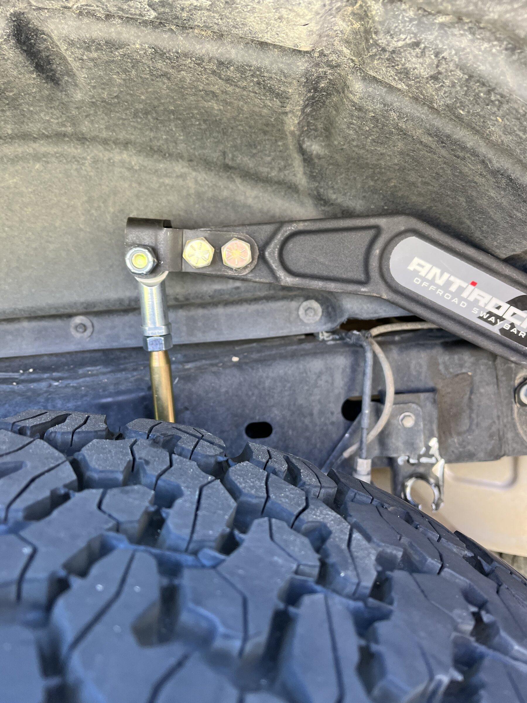

check your sway bar links at the frame...I had the same issue and it turned out to be the sway bar mounts ripping out of the frame..
Was that with the AR? My ARs make some noise due to the type of joint when going over larger bumps or anything off road. Seems to be normal afaict.
no it was with the stock bar/links on..had a knock and thought was tight when checked with a wrench driving would cause the link to twist and hogg out the hole for the link eventually splitting the link mount as you see in the pic. had to put the AR on in its replacement
I see it now! The AR is a big upgrade in many ways but not cheap.
