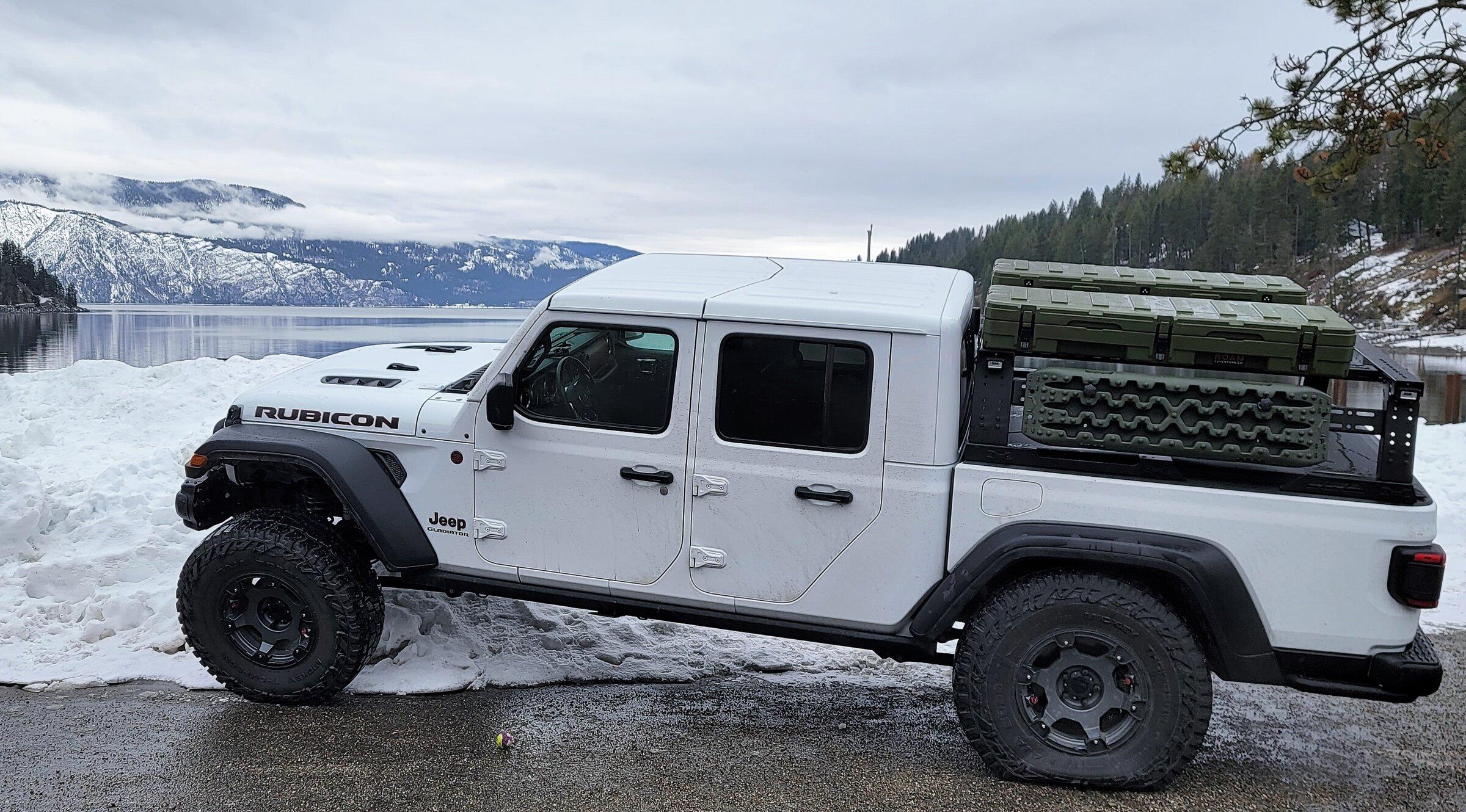

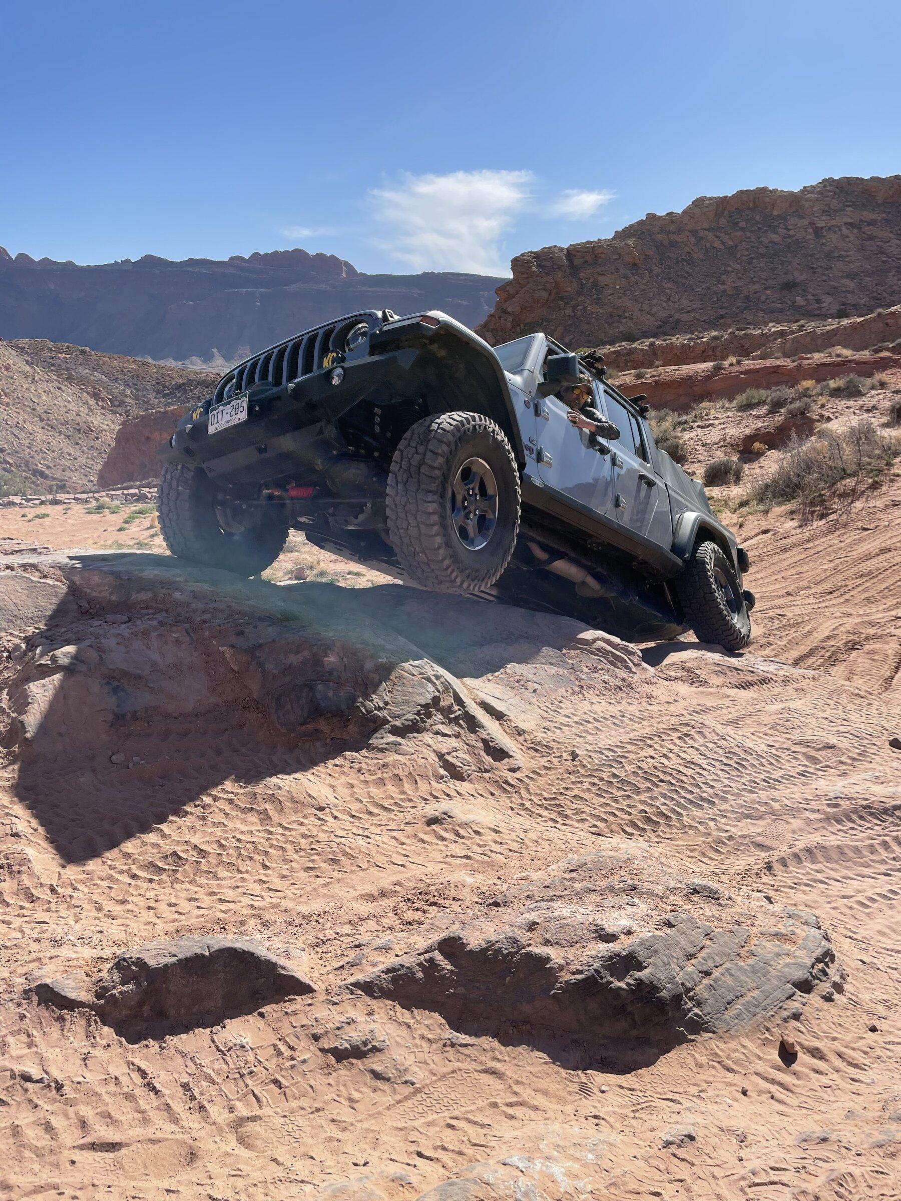

Reporting back. The Ram 1500 rear spring mod and clayton rear track bar are on. It rides really great. The rake is amazing and seriously helps for steep climbs and departure angle. Not stiff. Rides better than stock. And I still have enough flex to stuff them into the rear fenders, but without touching. It’s fantastic. I’d recommend it all day. I need to take a better side picture, but here it is in action.
Awesome! Would love to see some pics from the side when you get them ?
