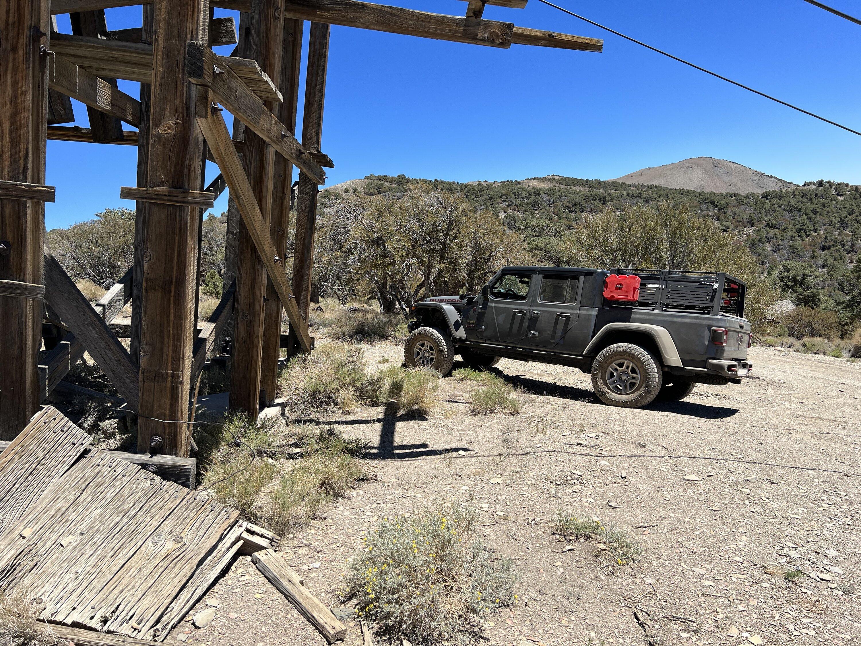

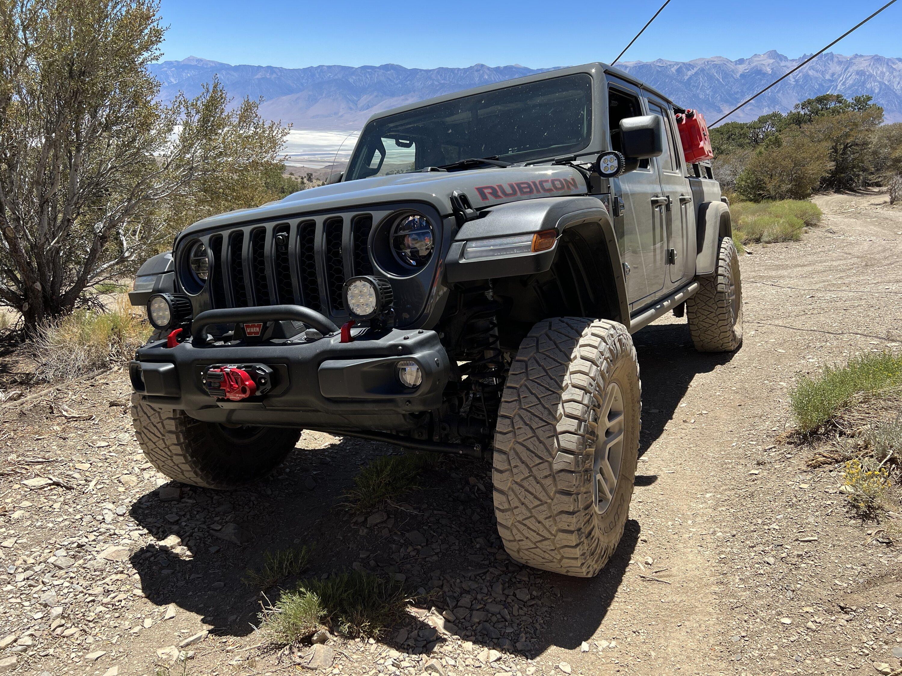

My son and I were exploring trails around 395 and Mojave this week. On one trail, my son noticed a wet tire on the JT. My passenger rear brake line was leaking. Guessing I hit a rock perfectly, and it loosened the bolt enough to help drain my brake fluid down to near nothing. I had to descend using 4Lo in manual. Just curious, anyone run into this issue other than me?
A pic or two from the trip (Cerro Gordo):
