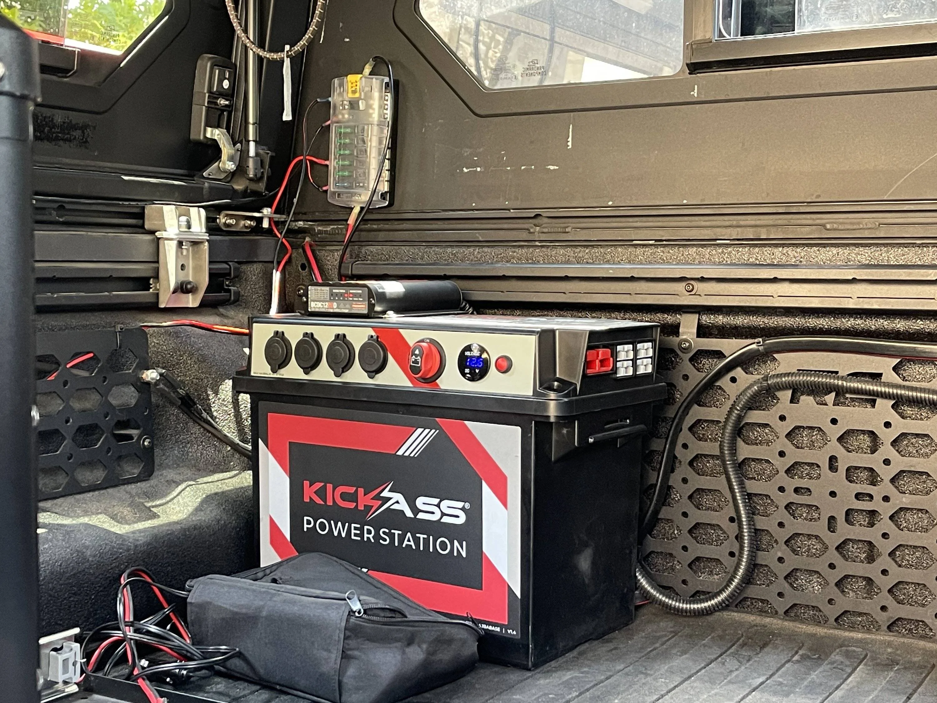

I looked hard at the KickAss system, but I didn't want to take up space in the main bed area. And I wanted just a little more than 100AH so the fridge will run for two days without any charge.
This battery and tray will fit between the wheel well and tailgate, tucked away so it doesn't interfere with the main part of the bed. I'll have a slide on one half and fridge on the other half of the bed. Behind the fridge will be storage.
Battery - https://kickassproducts.com/collections/batteries-systems/products/kickass-lithium-120ah-battery-fg
Tray - https://kickassproducts.com/collections/batteries-systems/products/tray-for-battery-ka12120slim

knowing what I know now… I’m actually planning on doing a similar set up to what you mentioned. Slim battery where you mentioned, and the kickass control unit mounted on the cab. Trying to find a good molle panel to mount on there. I got the battery box with the kickass dcdc charger, but my dumbass accidentally swapped the positive and negative when I was replacing the battery and now it wont work. So went back to old faithful. I contacted kickass and they weren’t really about sending me a new unit.
one thing to keep in mind, is the environment.. I’m in Texas and battery gets so hot in the canopy that the BMS will stop the charging and your fridge will possibly drain the battery. I just ordered a 12v fan, gonna see if it’s gonna be able to push that hot air out the cap, enough so that battery can remain chargin
Other than that, I left my truck parked for 5 days and the solar panel kept my battery topped off and fridge running with no problems (this was a couple months ago when it wasn’t 90+)

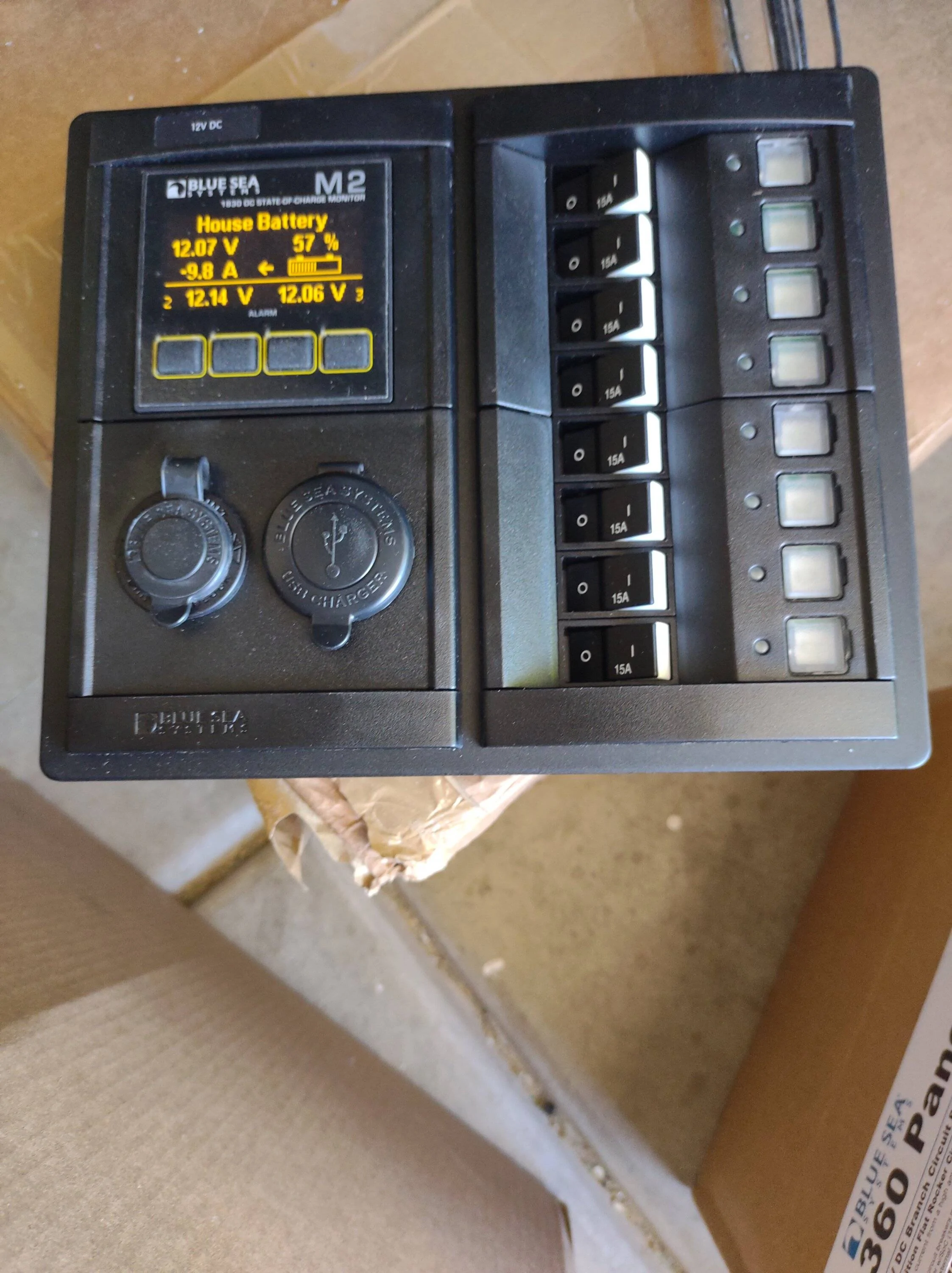

I looked at a mini LifePo4 not all that much smaller IMO at least not small enough to call it mini. But speaking of Blue Sea System Panels

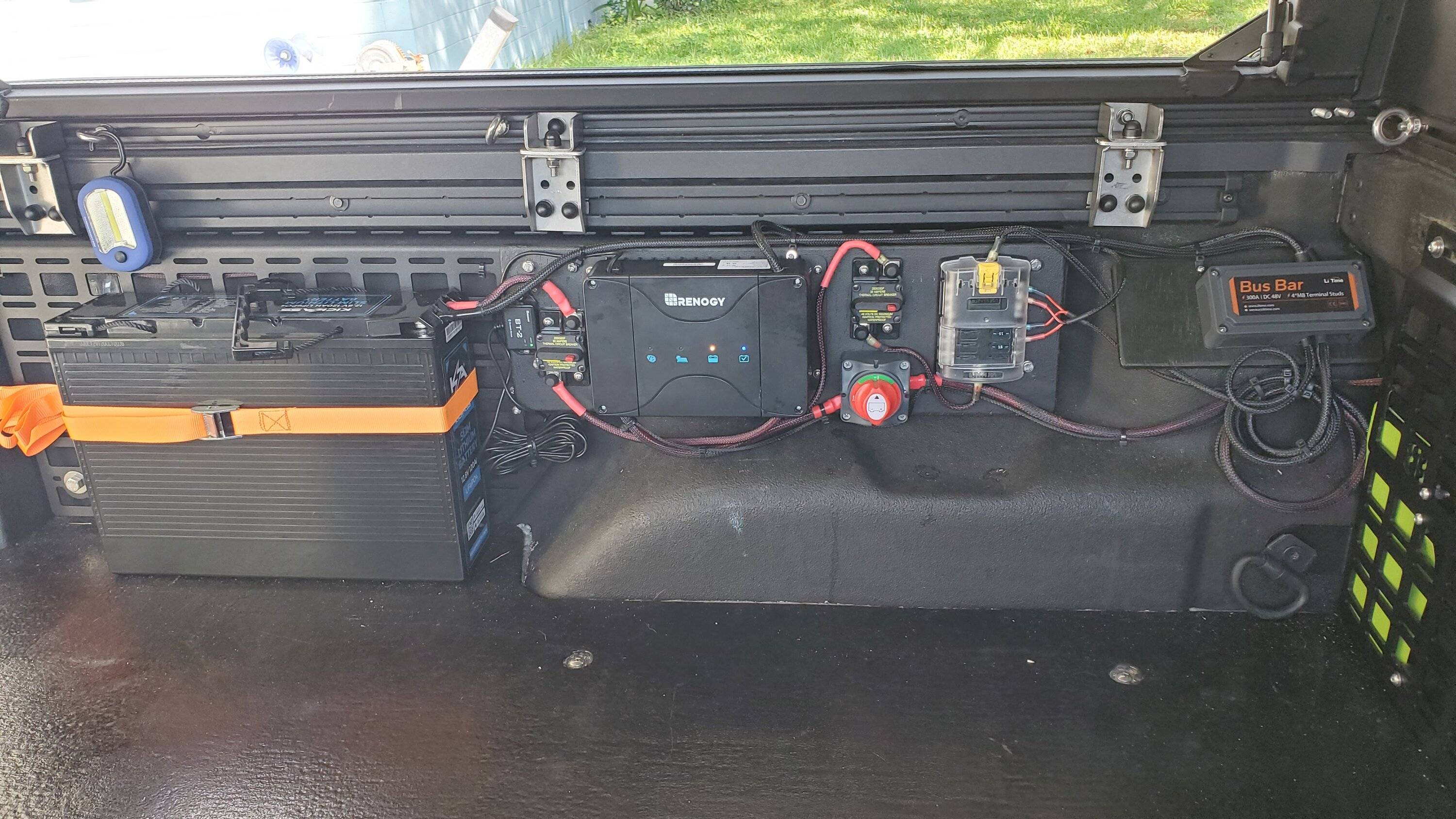

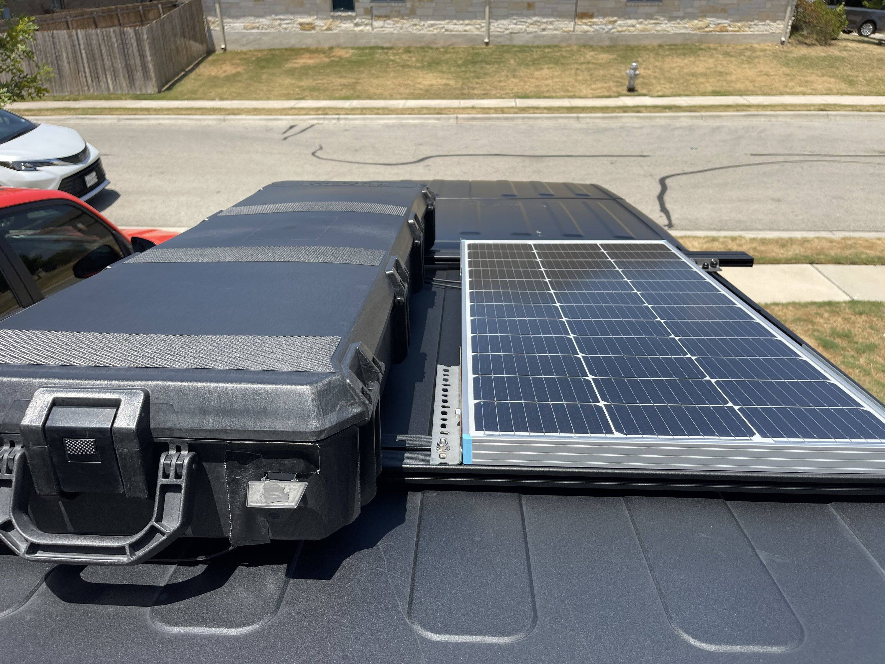

I forgot to follow up with the results. Renogy DCC50, KickAss Slim 120AH, assorted Blue Sea breakers and distro panel, SolarHawk solar panel for the iKamper. It's all complete! Thanks for everyone's input.
