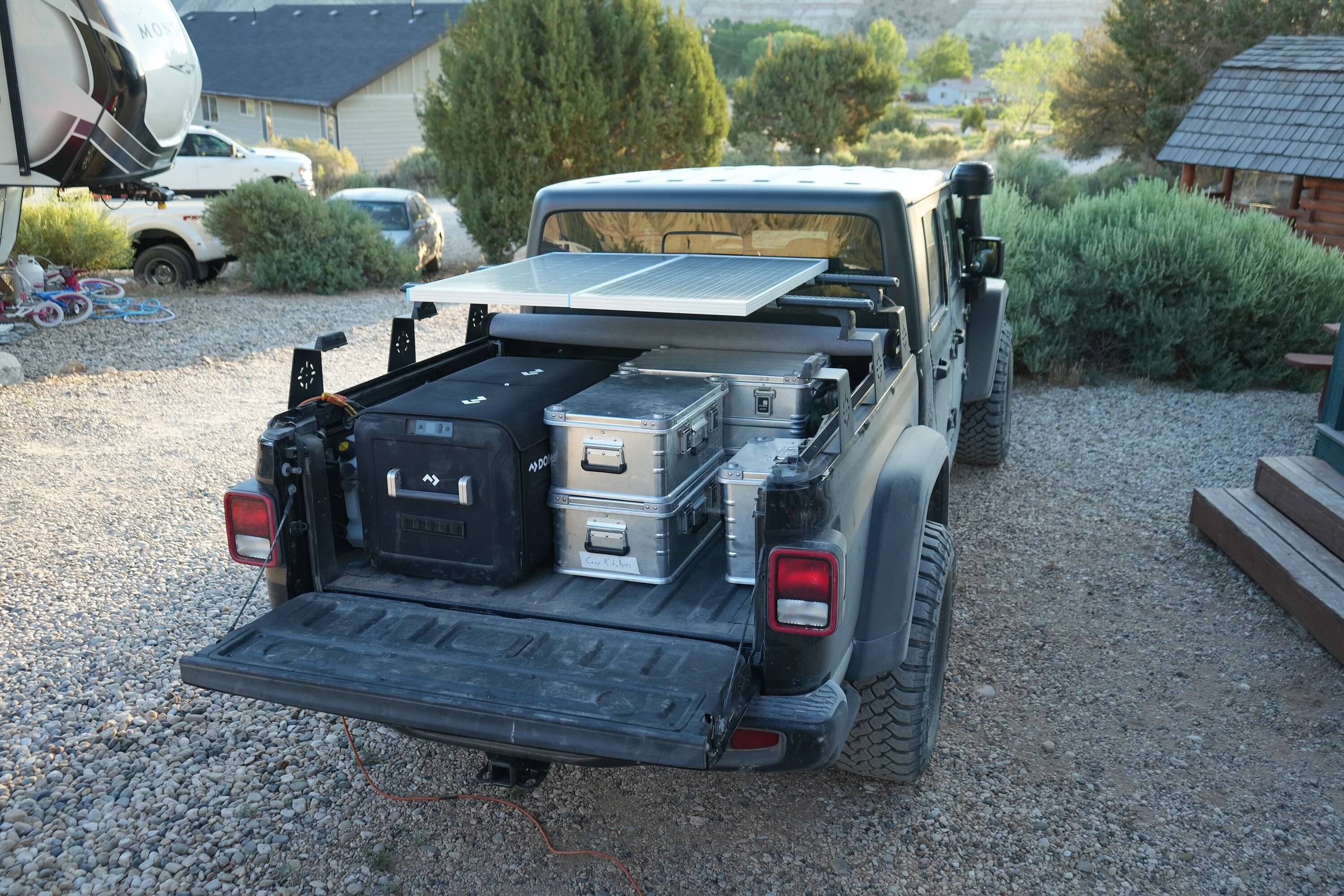

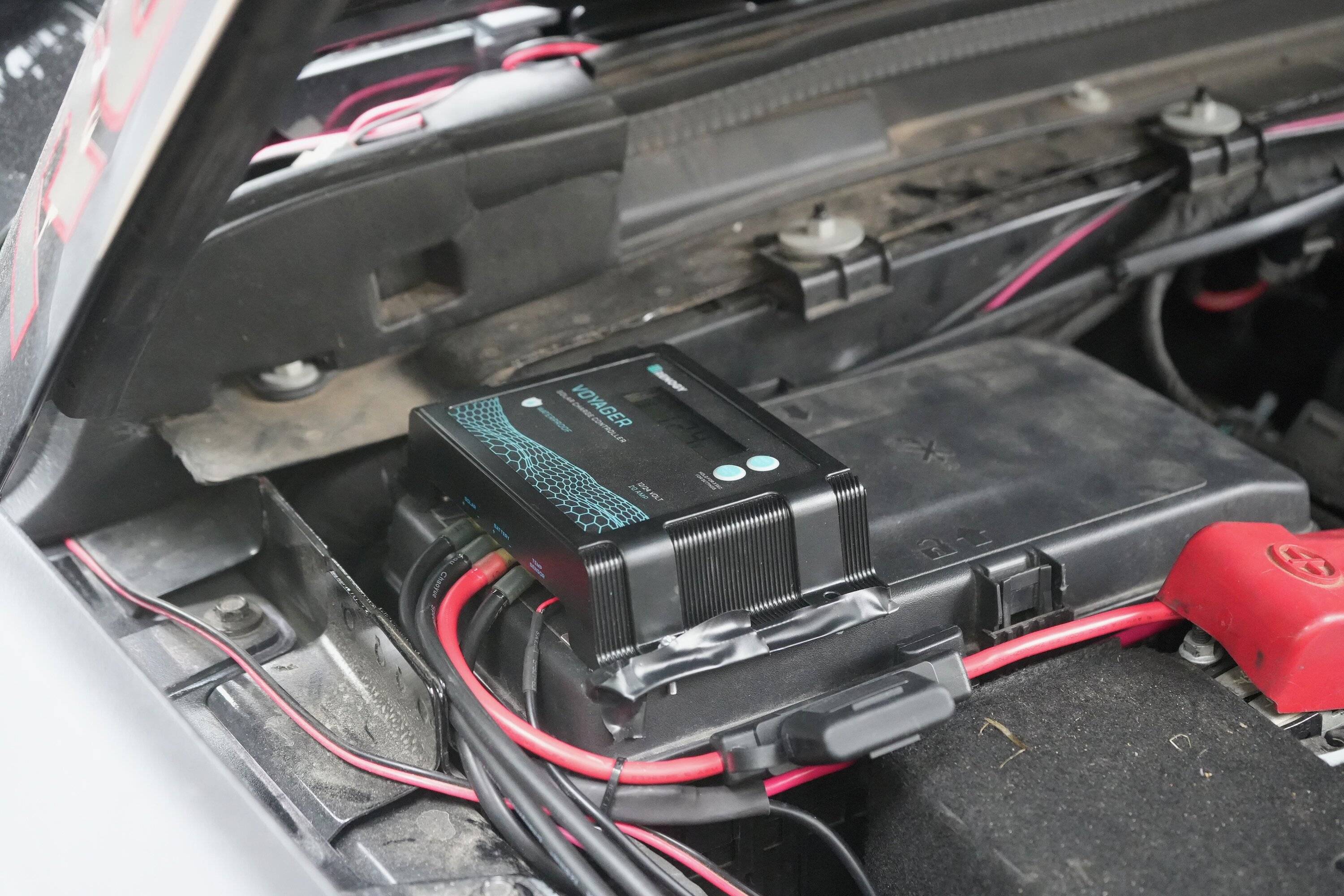

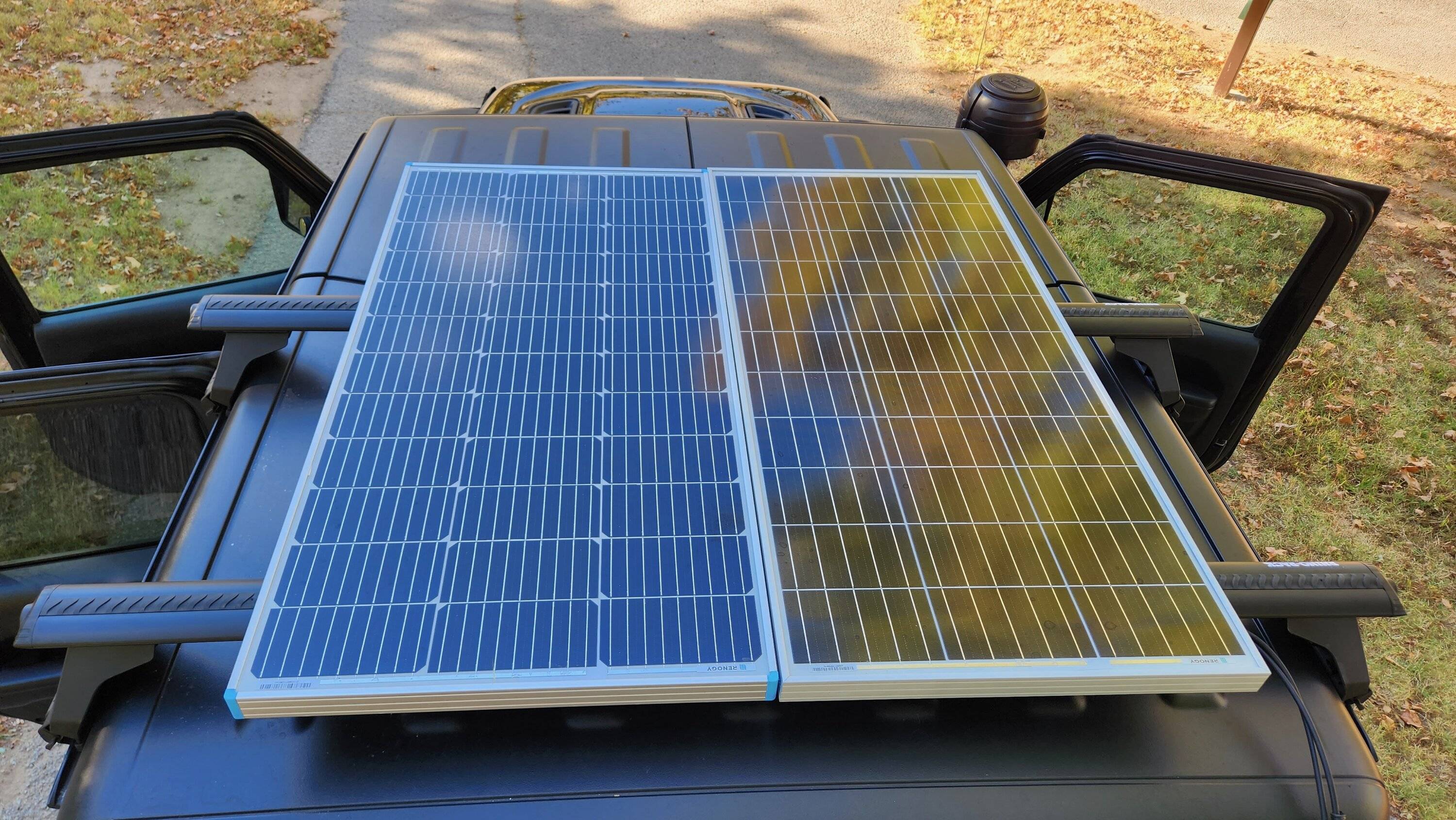

I have two 100w Renogy panels that I either mount to my roof or bed rack, depending on what I'm doing. They're wired to a Renogy charge controller that's mounted in the engine bay. Last summer I took a trip through Utah and the charge controller understandably overheated, and only worked after it had time to cool. That was fine because I was parked.
It's unlikely you'll get what the solar panels are rated for. I use them to run my Dometic fridge and charge camera batteries. Even on a cloudy day I get sufficient angry pixies. Cheaper panels will have severely reduced output if even a little shade because they likely don't have bypass diodes.
