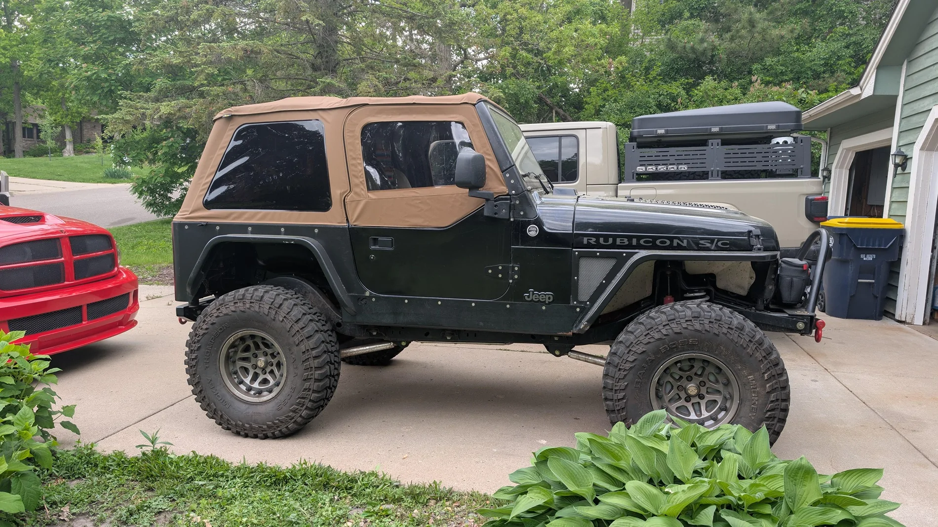

I run Hutchinsons on my TJ. Absolutely love the wheels, I've gone through a few sets of tires on them now and they're so easy to work with. Had them for maybe 10 years now.
After sheering another valve stem on my Saltas on the Gladiator I've been casually looking at beadlocks as well and I also just can't stomach the price on the Hutchinsons anymore.
I think I might go with the AEV Borahs, myself.

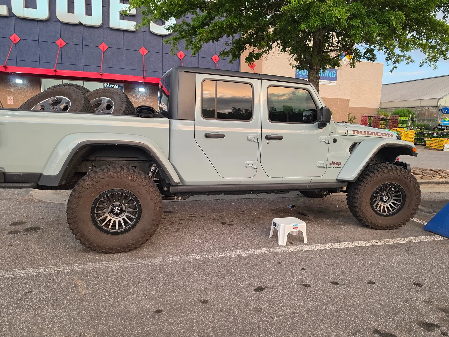

Just had Icon Recon Pro's installed today. Same as the rebound pro but with replaceable rash guards. Will see how they hold up.
I had Discount Tire install. They gave me a hard time at first then agreed to install them $110 for all 4. I had already prepped the retention pins with anti-Seize, TPMS, Long Apex deflators and silicone on the o-rings. They tried to get out of it saying they didn't have a tork wrench for 20ftlbs. I said, here, use mine and I provided the bit as well. 7/16 12point long socket is required. They tried to say they don't do beadlocks and showed me their litature. It specifically stated Icon Interlocks are not beadlocks. After making a couple of calls, they installed them and did a great job.
Jeep Gladiator Beadlock Variant Options 5509
wife made me buy her a step stool at Lowes. 37s and 3.5 springs.

Looks good! Thanks for the heads up. Went back into Icon to do some further research there. Looks like they have a few different wheel patterns with the bead locking nubs and a rash guard. Makes my choice a little harder but gives me options. Ugh. 😂
