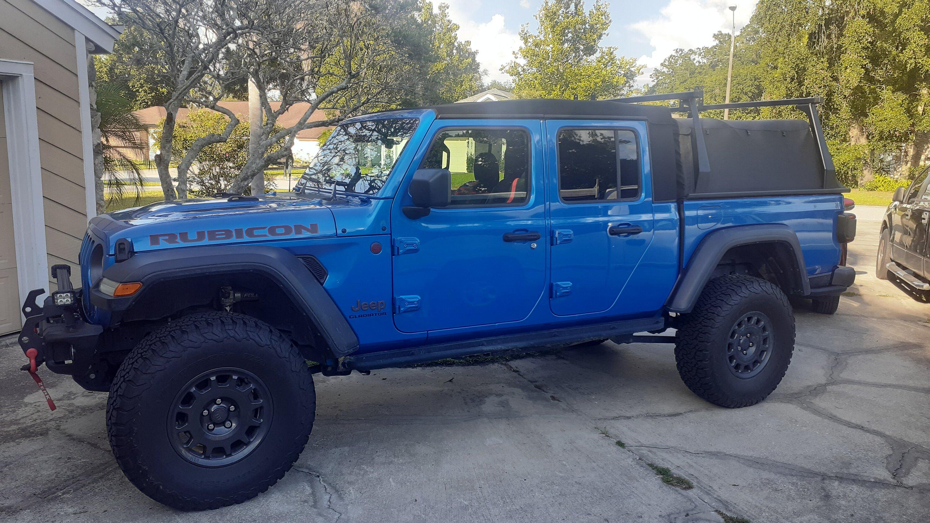

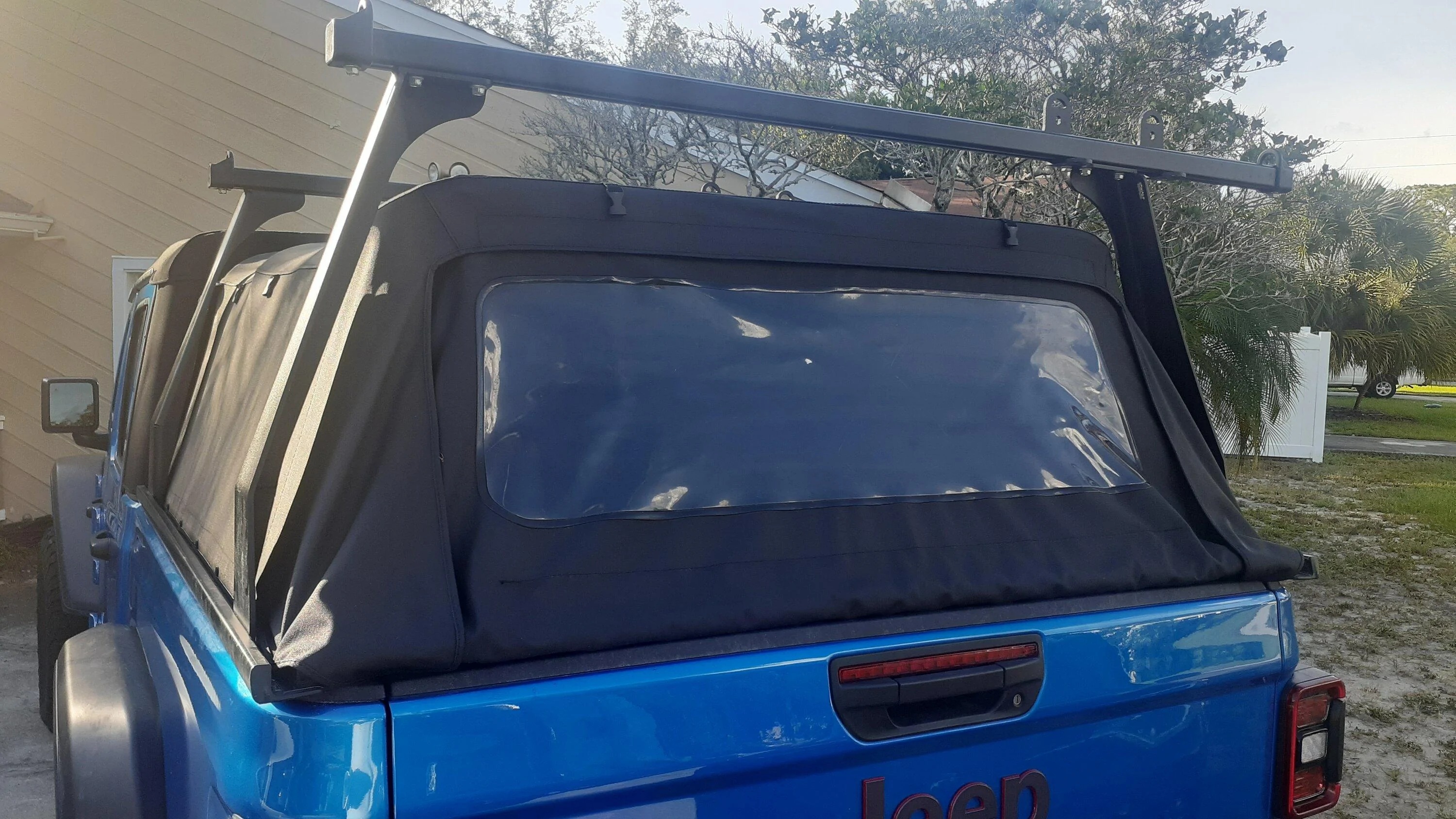

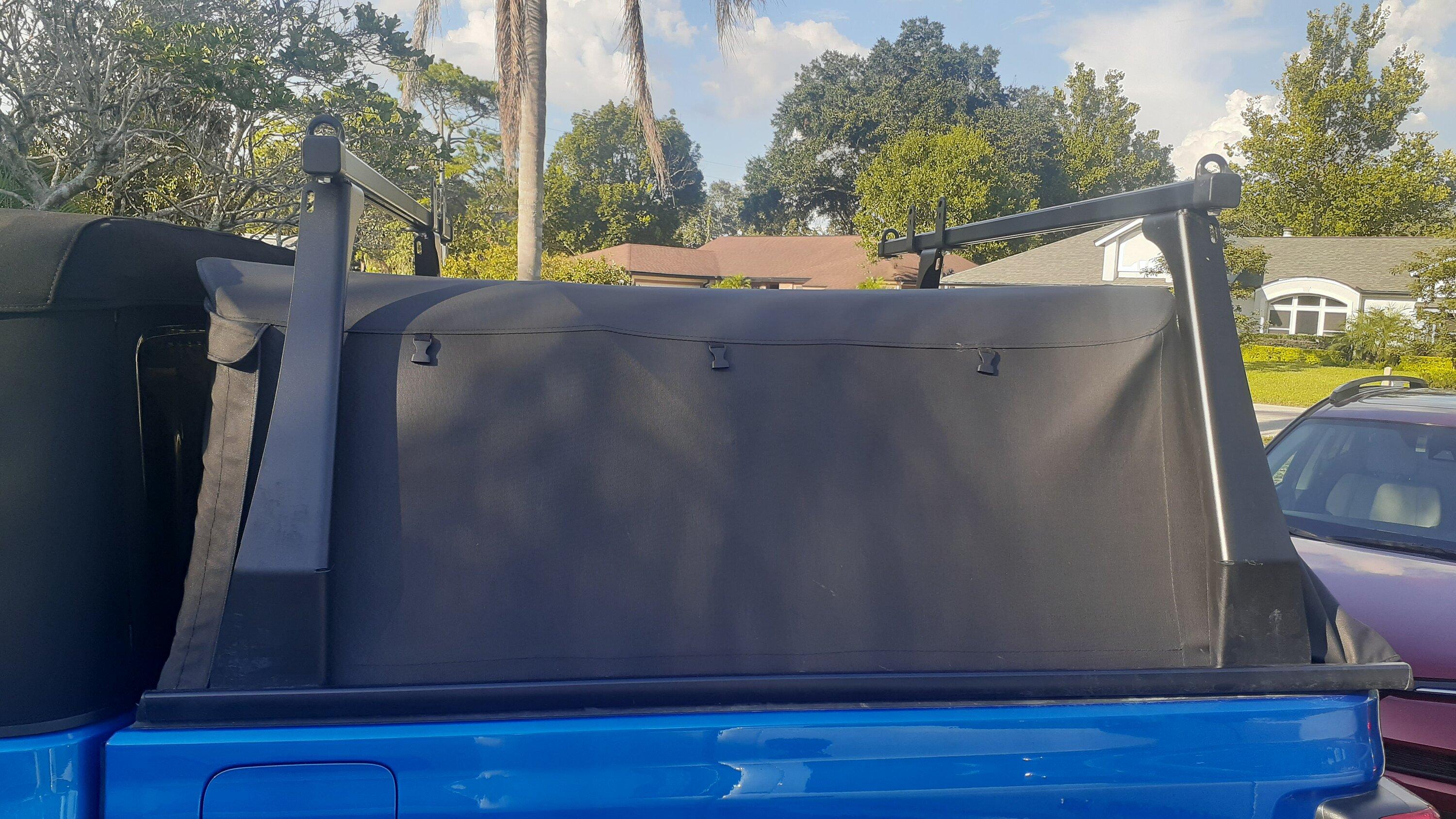

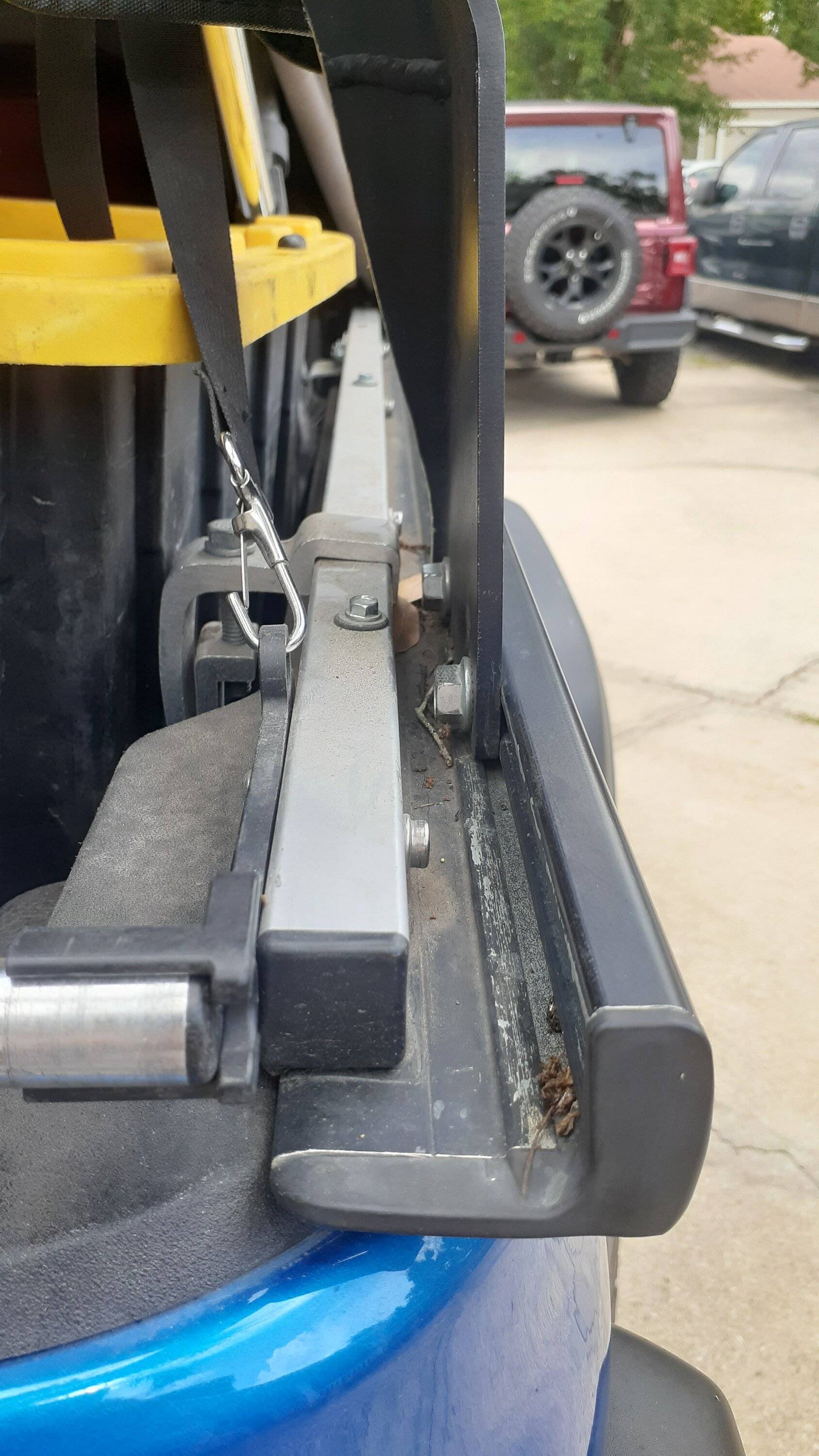

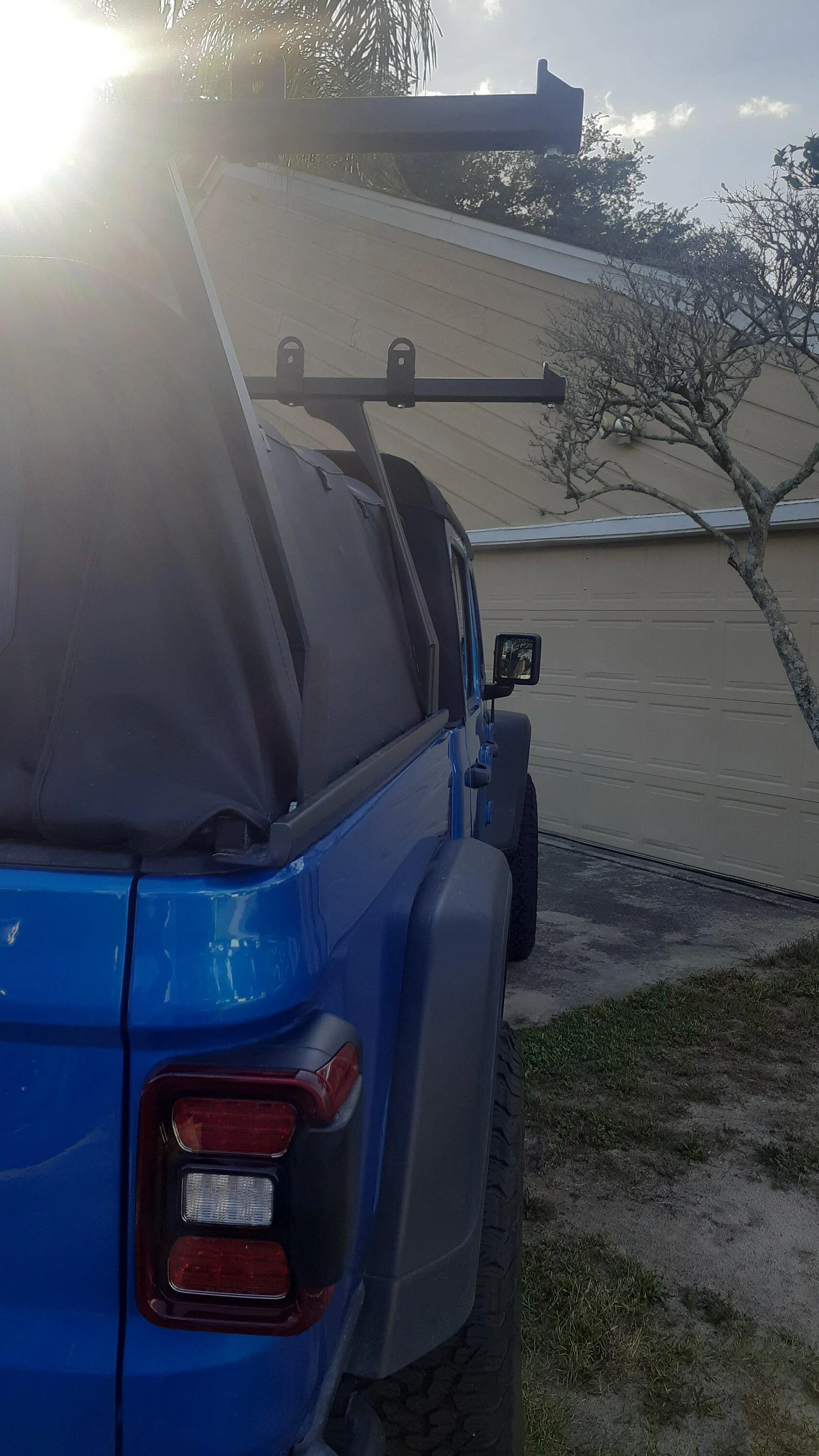

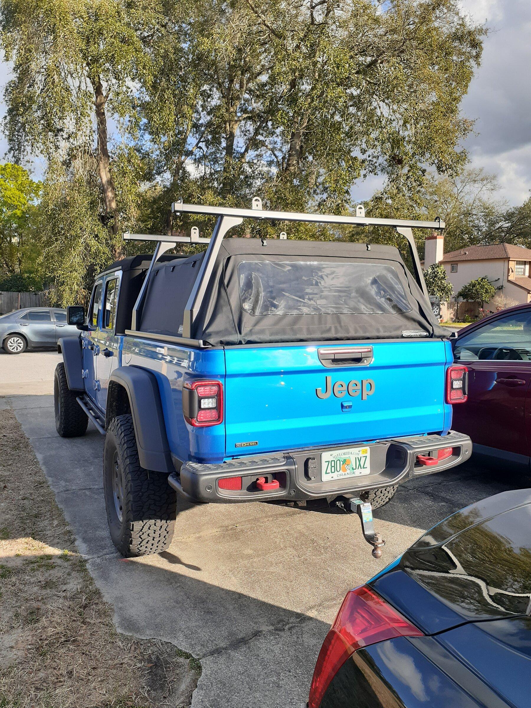

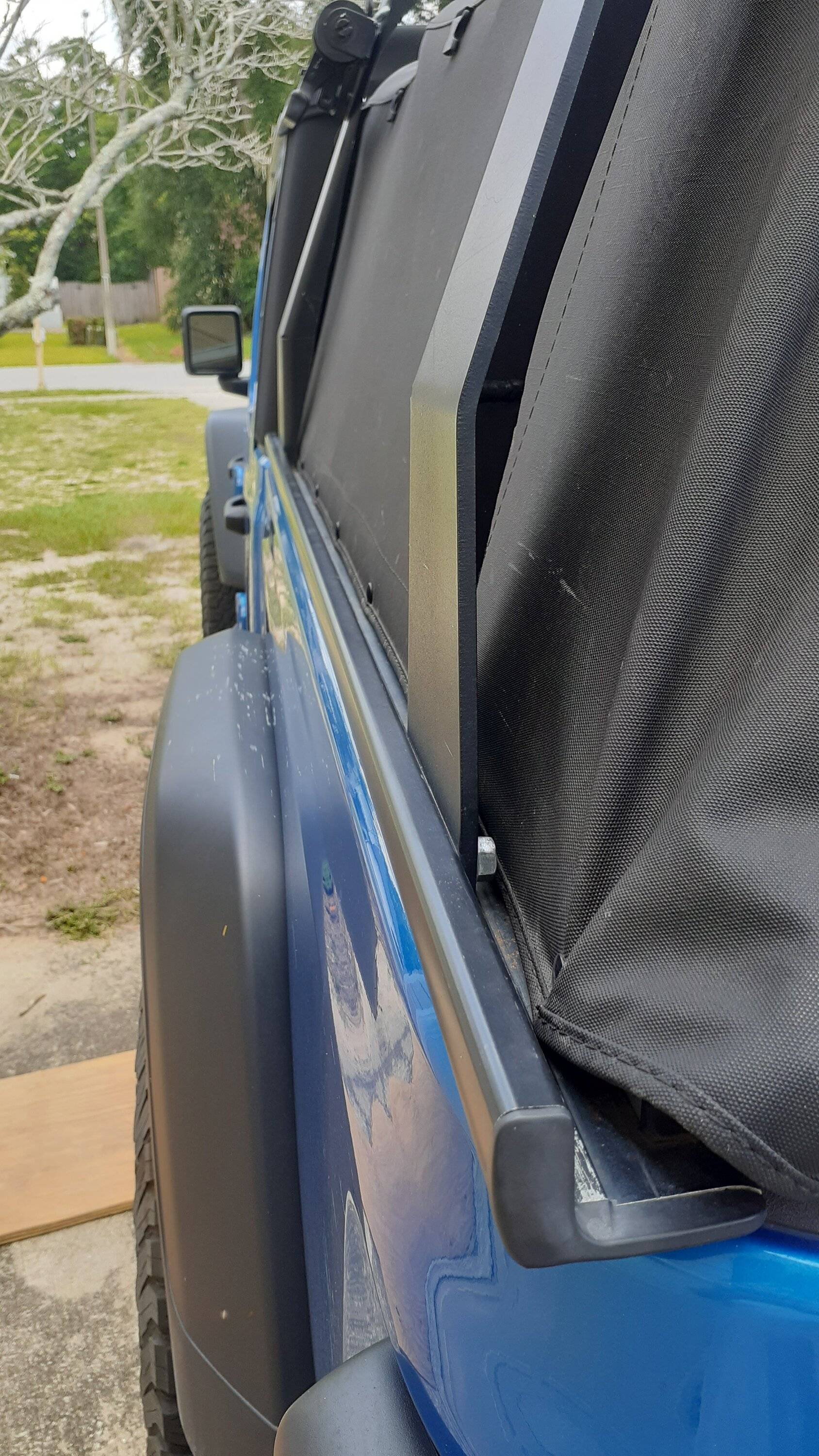

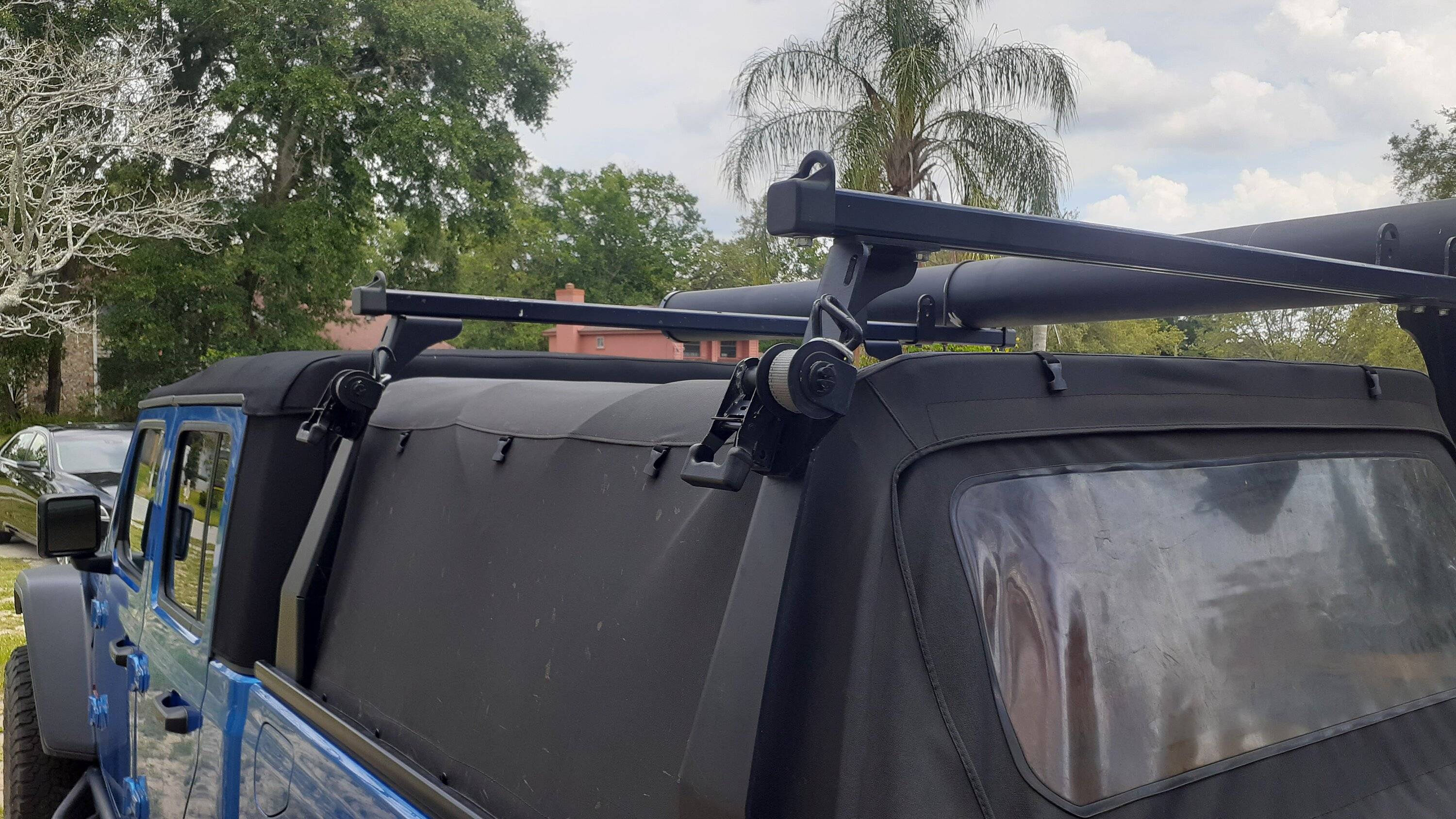

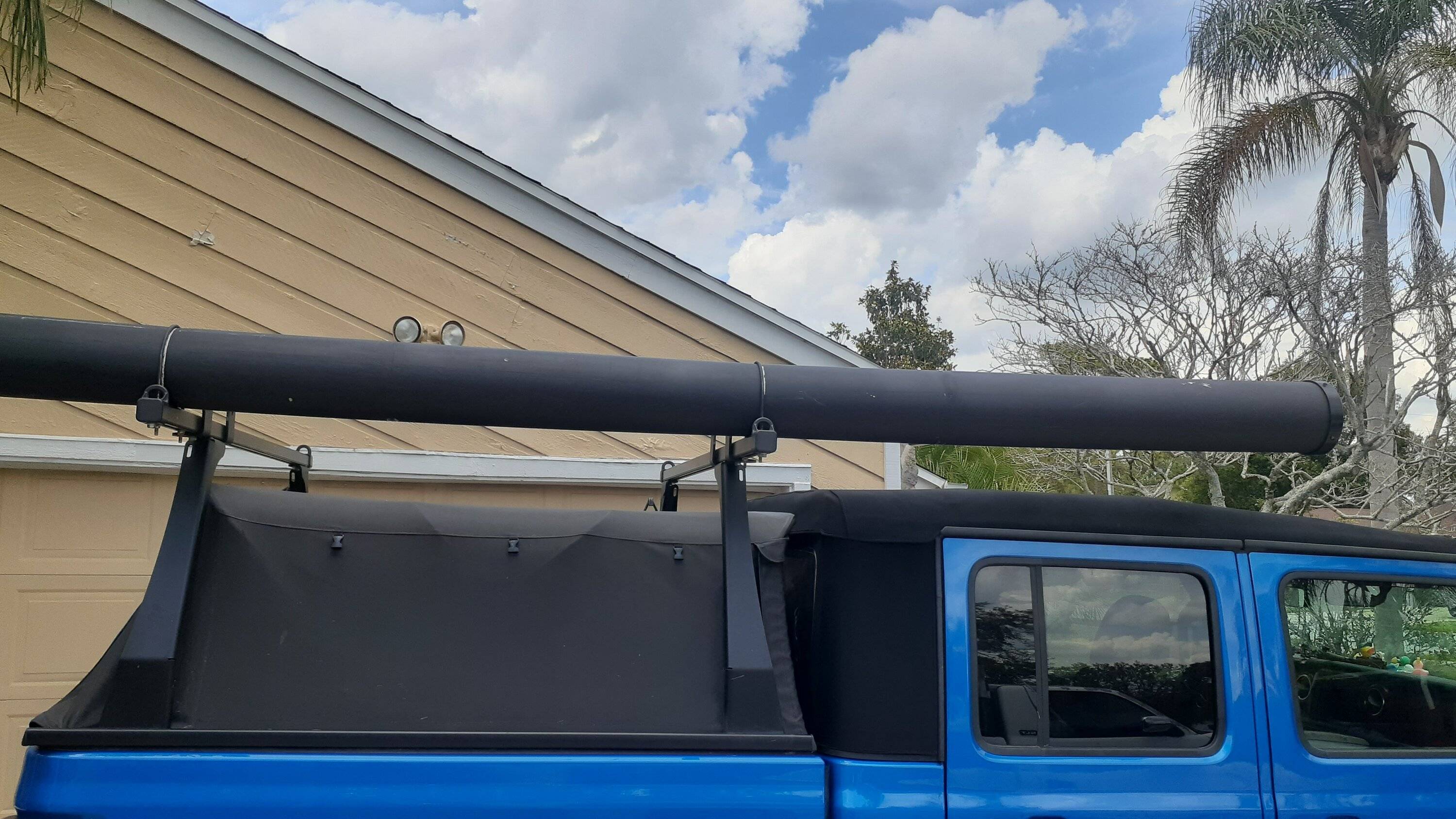

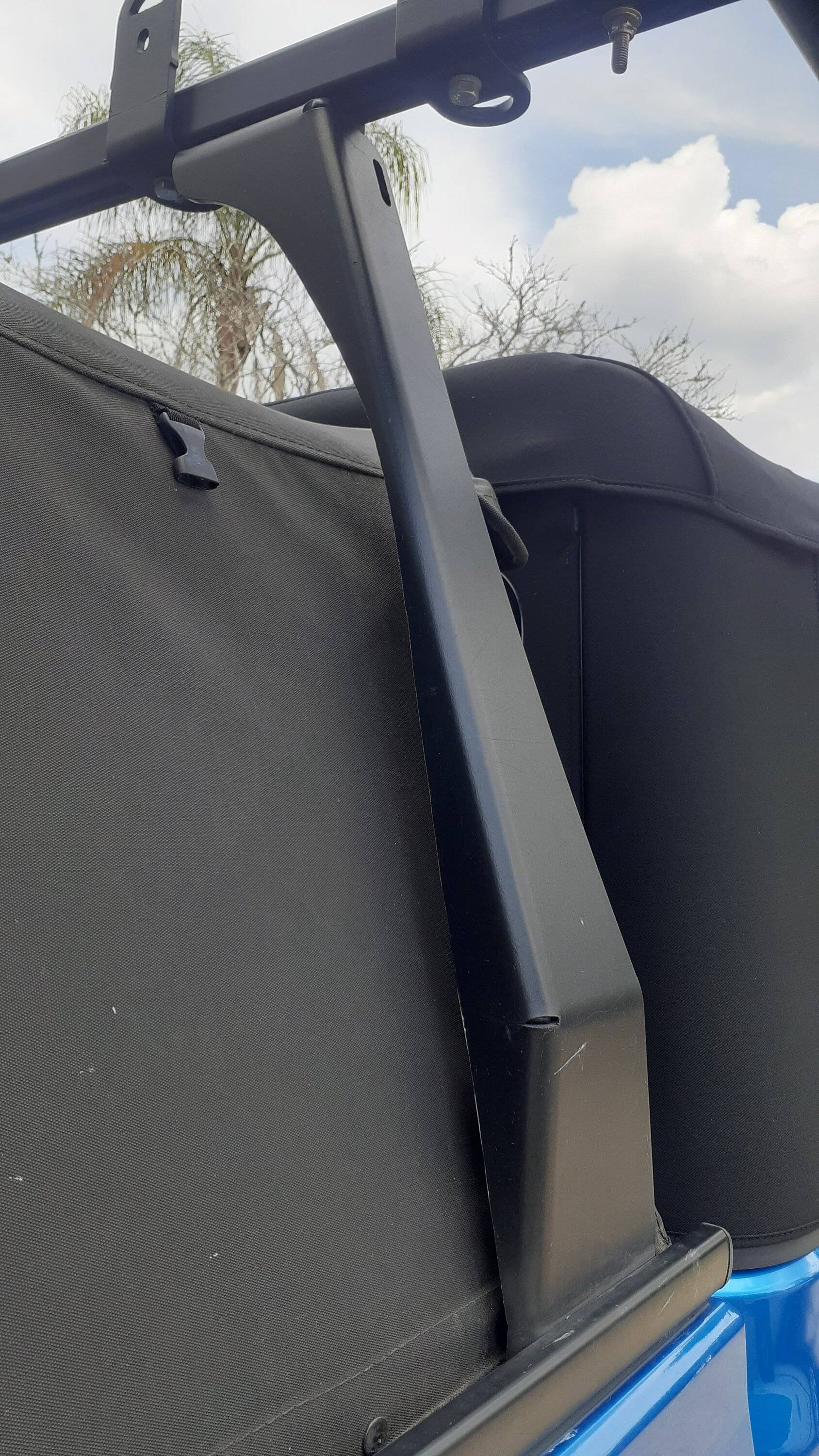

I made an F-250 Adarac system work with a Tacoma Softopper:

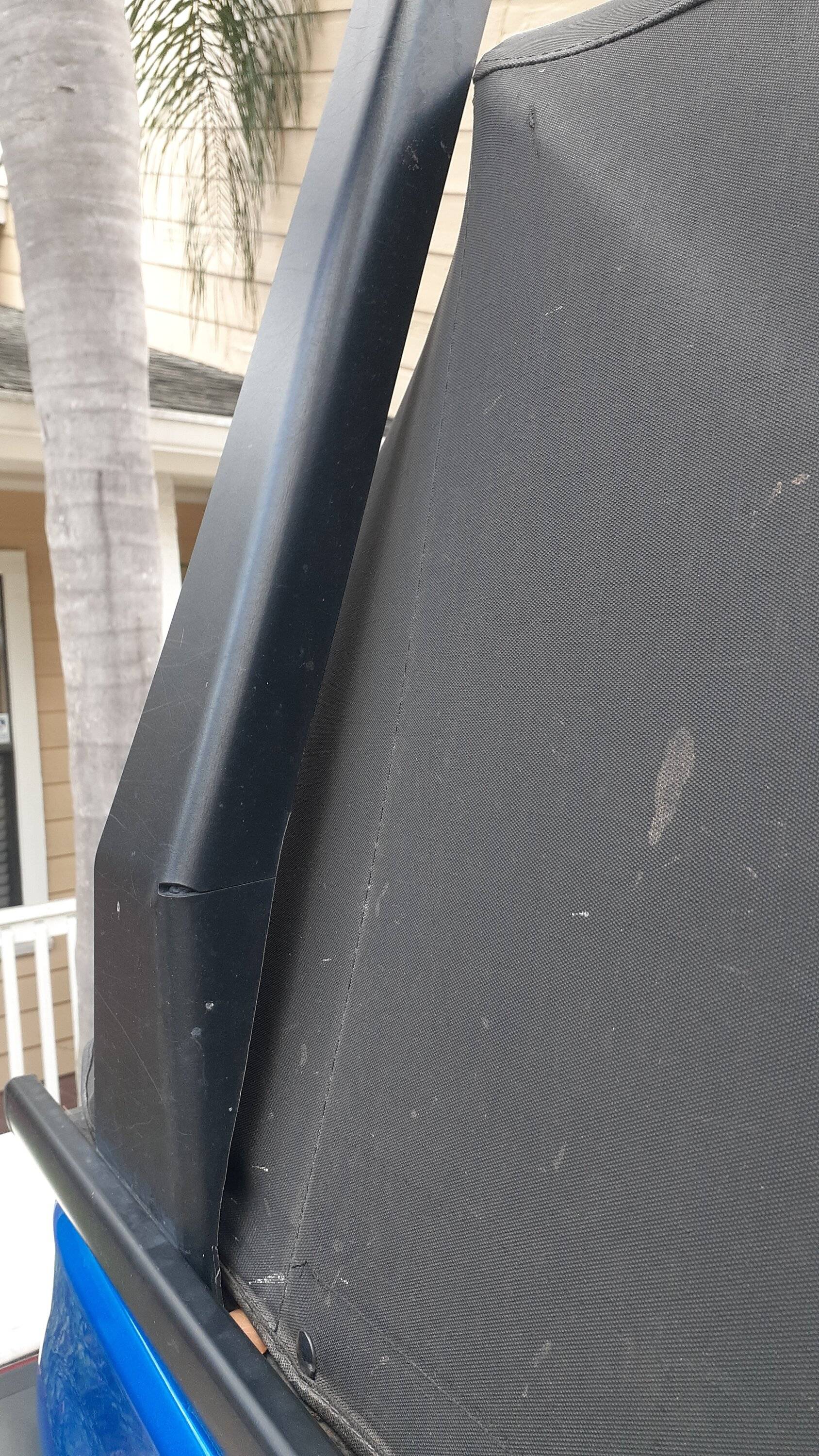

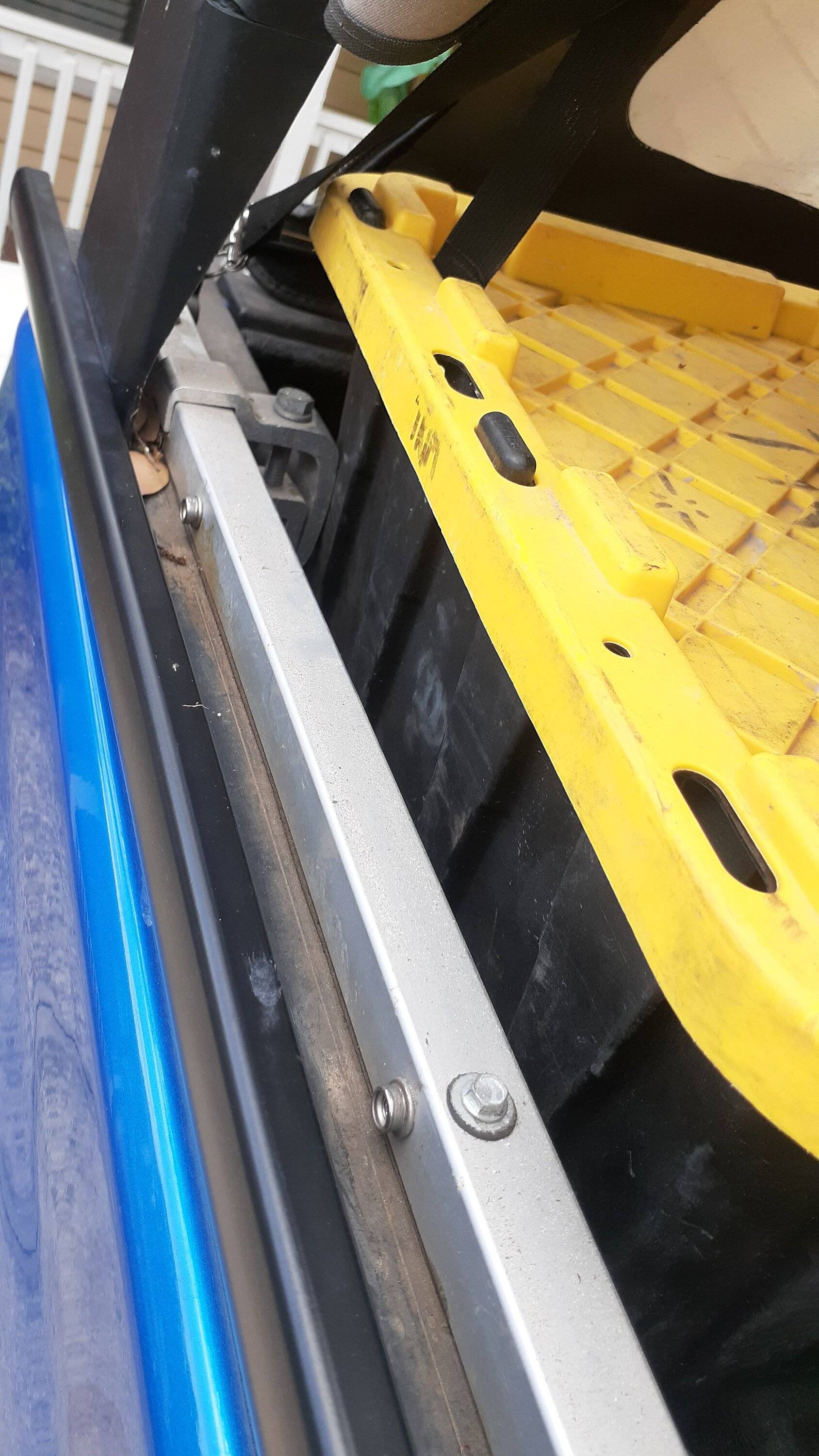

how much did you chop from the uprights ? any shots of the softopper bottom rail and adarac bottom rail alignment ? Looks great...... i'm leaning towards this
Just enough for the topper to clear the uprights.
I had to cheat the softopper rail over the Adarac rail to get enough clearance to unsnap the sides.
Perfect! Thanks for all these shots. Much appreciated. I'm going to ring them tomorrow.
The aluminium Pro seem to be far more vertical and dont follow the line of the softopper's side. Is there a certain reason you went with this angle of upright? And if you had gone with the more vertical uprights i'm assuming you wouldnt have to shave as much off the vertical uprights where they angle inwards ? Or am i missing something ? Thanks again, Michael
I thought it would compliment the angle of the topper.
Possibly. Not sure.
It's straight up.

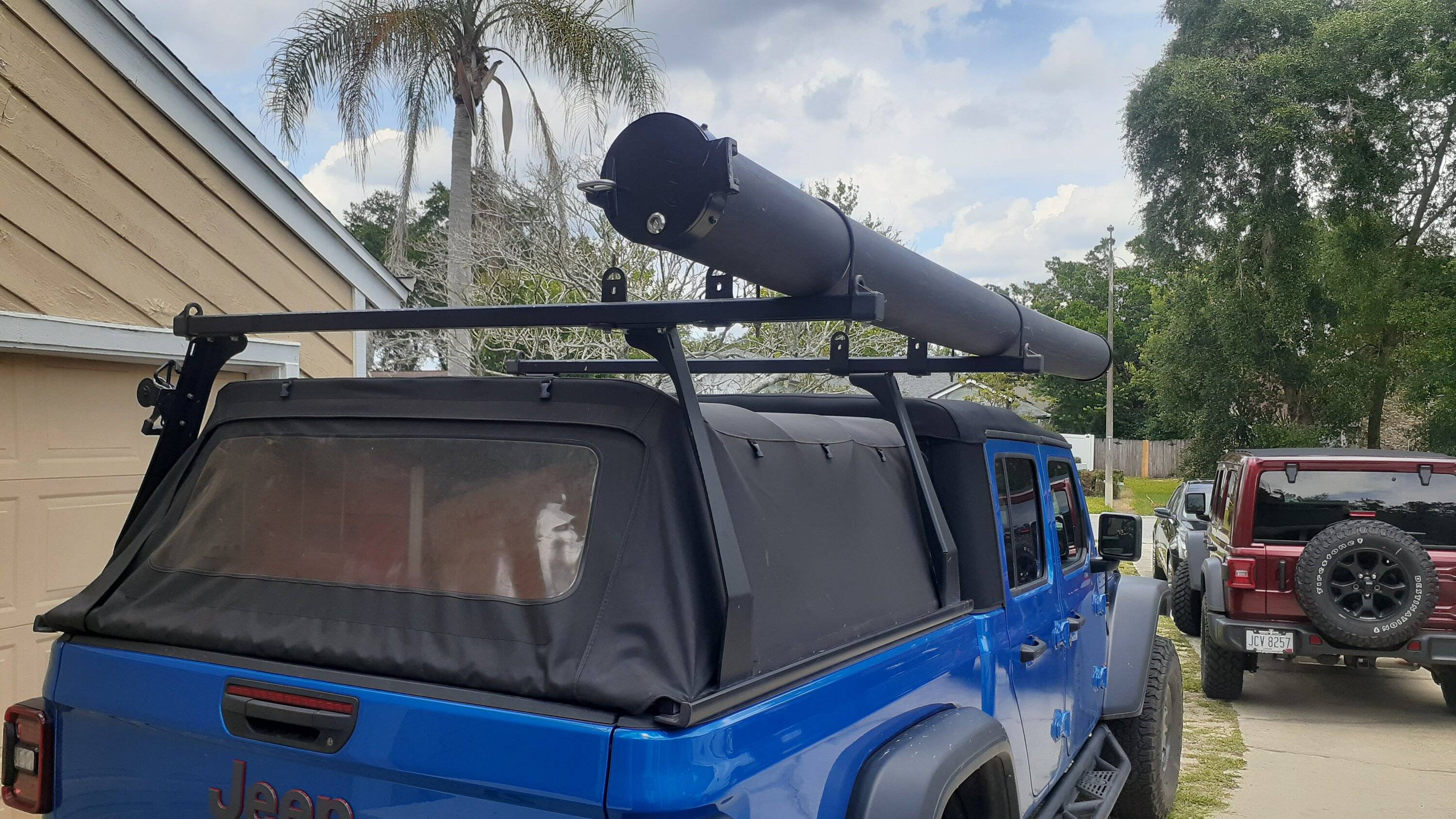

No it won't follow the line of the cab or topper but ... while the upper angle of the uprights does well complimenting the lines, to my eye the first few inches which is straight up, takes away from the aesthetic. I've tried to get several friends and others to confirm this but feel like I can't get an honest answer out of anybody, lol.
I likely would've swapped them out already but if I do that, I'll lose the ability to offset my storage tube out of the way allowing me to drop the cab top, so for right now and the foreseeable future, it's all function over form.

Thanks Chuck, just one more question, how many inches taller are the adarac crossbars over the softopper?
Hey this got lost in the shuffle.
3-4". Anything on the rack is about 1-2" over the soft top.
