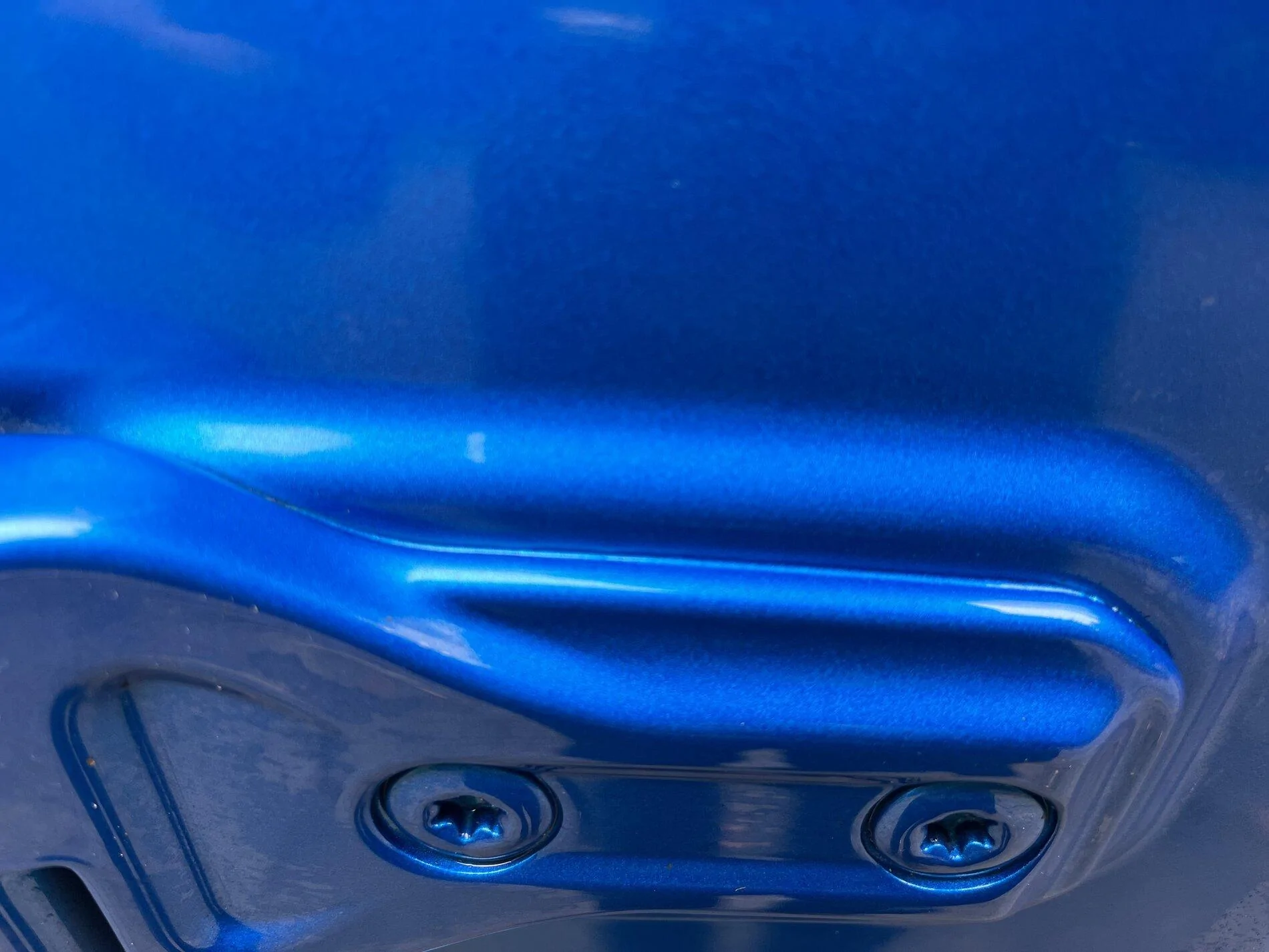

IMO anytime I have painted parts that are tightly bolted together and surfaces are flush paint creates a seal at the edge where the two meet. Jeep door hinge looks exactly how I would expect based on my experience.
Jeep Gladiator Best  Approach to Prevent Hinge  Rust 8199C824-1009-451C-82E2-8D918BBC45CF
