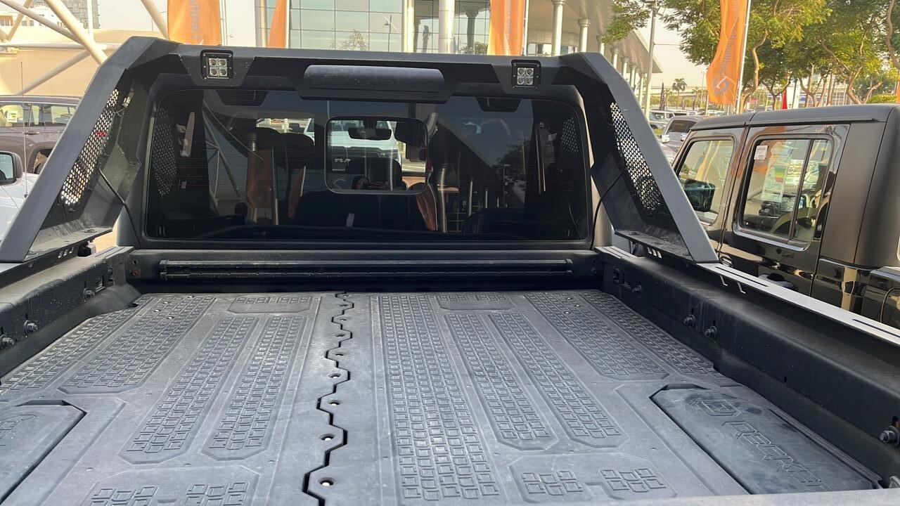

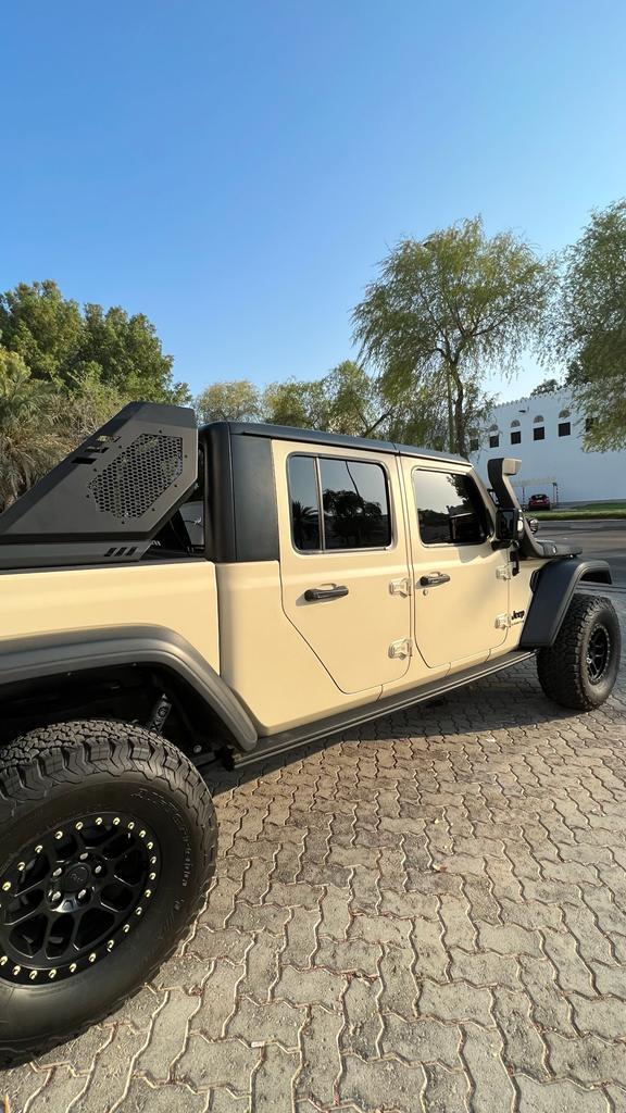

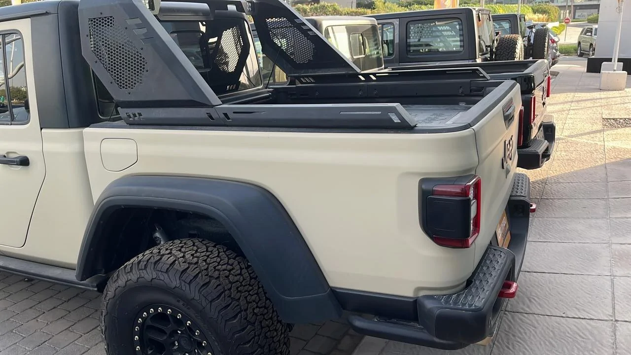

Hi Glads,
I'm looking for the best camping solution for my Gladiator equipped with Decked drawers and Blackhorse roll bar.
I prefer a hard shell RTT but if it's not gonna happen then what do you recommend coz I'm new to the overlanding world??

Unfortunately you’ll have to ditch the roll bar for a rack unless they make a conversion kit for that roll bar.

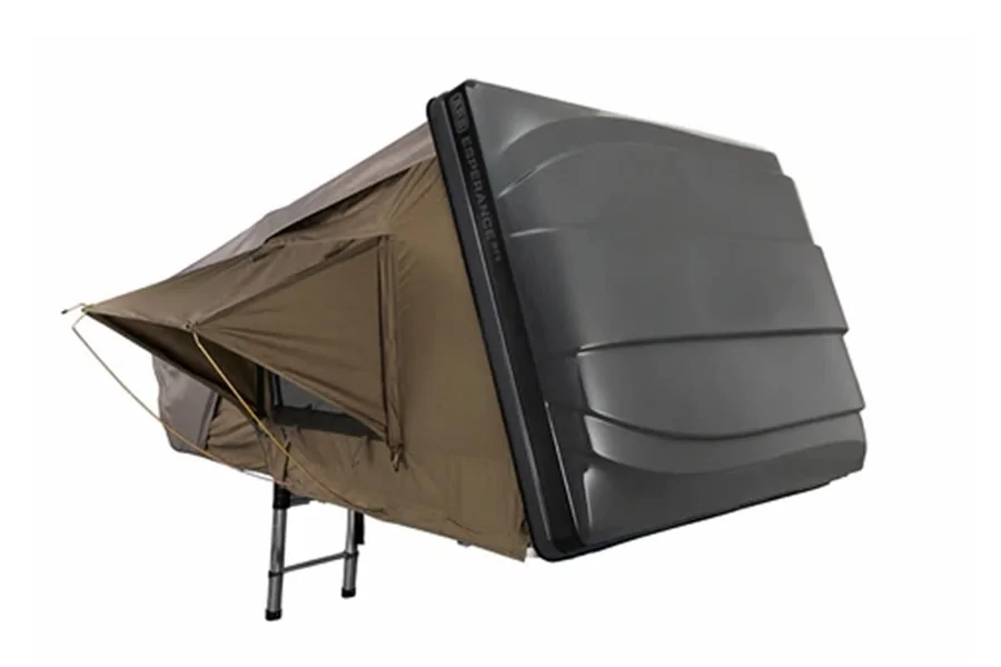

For the RTT, have you seen the new ARB Esperance hardshell RTT? The price is pretty decent for a hardshell:
https://www.northridge4x4.com/part/tents/802200-arb-esperance-compact-hard-shell-rooftop-tent

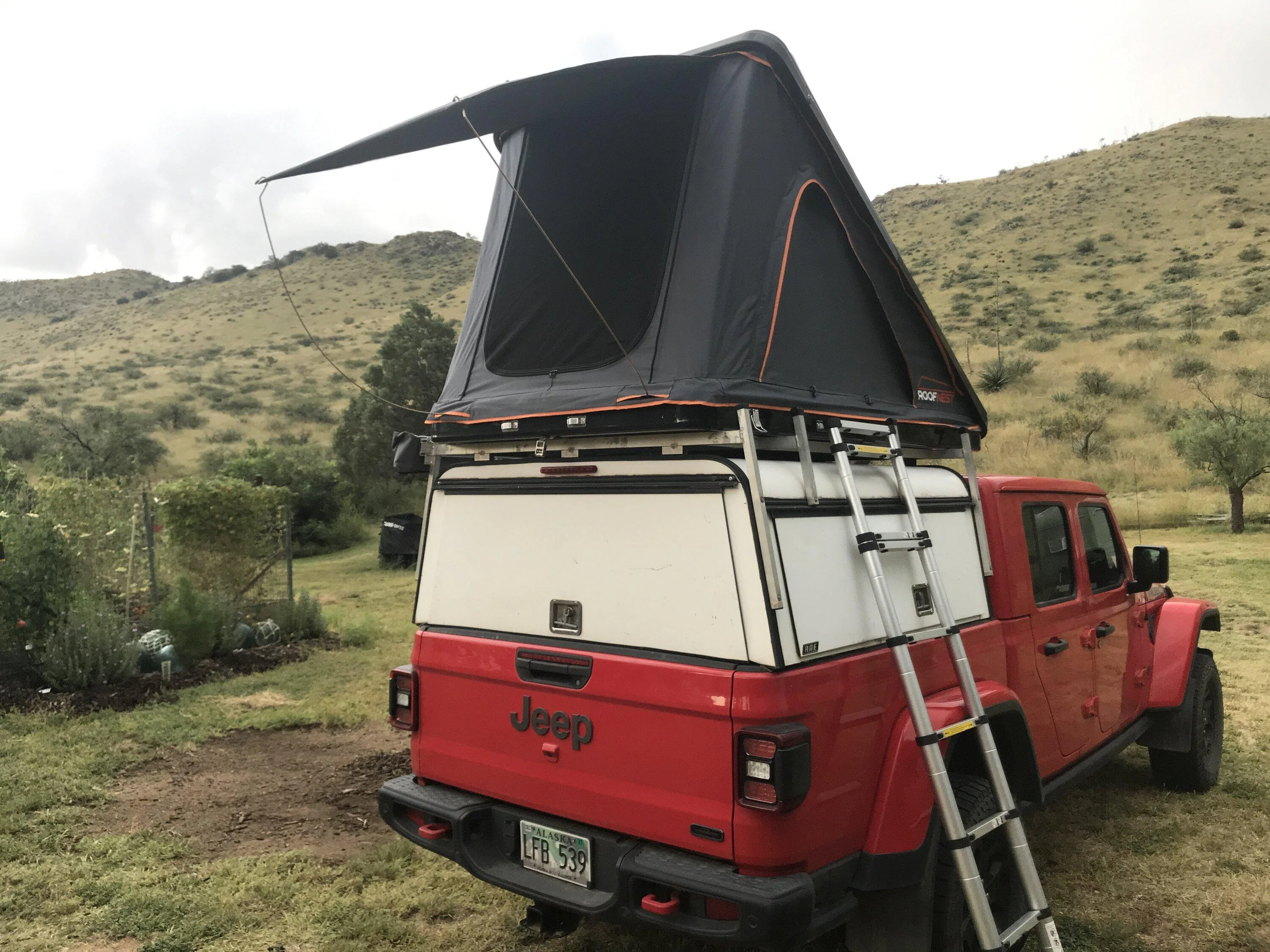

Alaskantinbender
Jim
Jul 1, 2019
158
231
Alaska, Arizona
2020 Launch edition
Aircraft Mechanic
Max weight capacity I’ve ever seen for gutter mount roof racks is around 150lbs - the panels are fiberglass and just don’t have the strength. Not gonna be putting an RTT and human up there unless you get something that reinforces on the body like the Gobi setup. Even the Rhino that requires drilling maxes out at 220lbs.
I agree the gutter mount wont work on the fiberglass top. The rhino backbone is the way to go with a RTT on the hard top. Most hard shell tents are about 130 pounds. Lots of happy Jeepers out there using them. Not my choice I prefer my tent on a topper.
